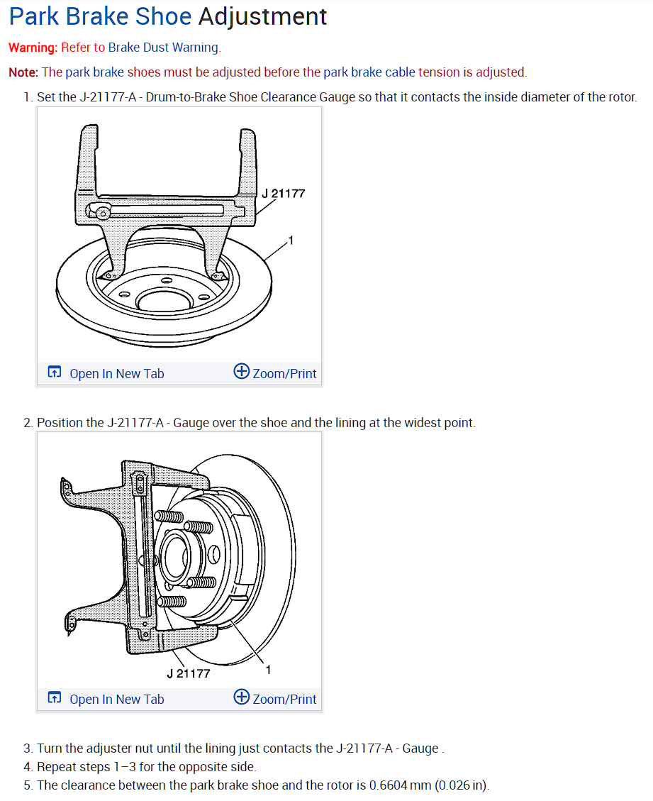

the brake shoes likely need to be adjusted. sadly you will need to take the back brakes and rotor off and then turn the star wheel and test fit the rotor drum part till you have them adjust to a very slight drag when you turn the rotors.

I already removed the rotor and checked. The adjustment is good.
When depressing the parking brake, it pulls back on the lever, but the shoe hardly expands. The lever is not properly engaging with the tappet.

These parking brakes are an odd design. As Scottydogs described it careful adjustment of the shoes is the only way to make these work. I owned my first Tahoe for several years with the parking brake being almost useless. We tow a boat often and this was a real issue on boat ramps. I needed a working parking brake. To get them working you need to adjust the star wheels on both rear parking brakes till the fit is tight. You may need to bump the shoes up or down slightly to get the drum to fit over the shoes. The shoes should be wire brushed clean before this fitting and the drum should be clean and free of any dirt or rust that could affect the good fit. By playing with this you can get the emergency brake to apply with the pedal at maybe 50% depressed. It takes work but there is no shortcut
If you adjust them too tight the drag will heat up your brake quickly. The brake must spin free but with near zero play.
With both E brakes adjusted and the rotors installed you can test your E brake pedal before bolting the disc brake calipers back on.
It would be great if GM left a window to adjust the star wheel with the brake assembled but they did not.

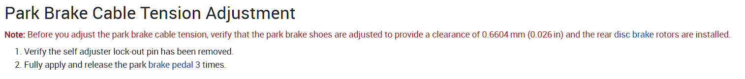

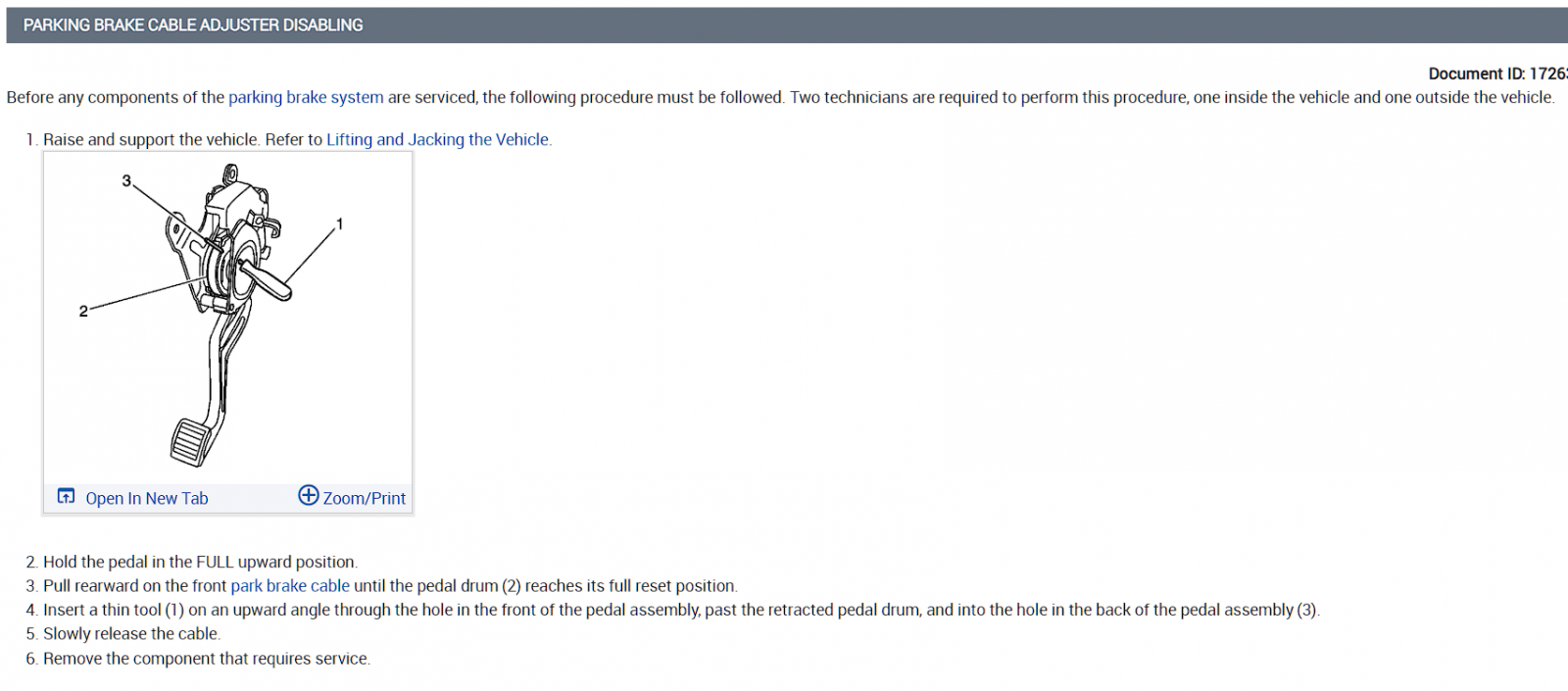

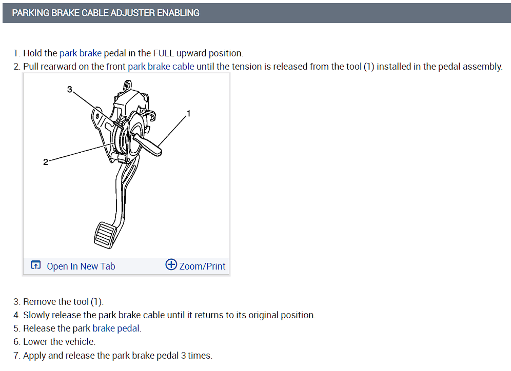

As @Scottydoggs noted, they need to be adjusted to have a slight drag.
Long shot, but are the backing plates in good shape?
There is also a slack adjuster for the cables, along the frame and underneath the driver's side doors. I had all four (front, intermediate, and left/right side) cables replaced due to stretched cables and no more adjustment left.

To be clear, the shoe is adjusted so that there is almost zero clearance between the shoe and drum. This is verified with a parking brake tool. I can see that when the parking brake is set half way, the parking brake lever is pulled 90 degrees from the backing plate. However, the shoes have hardly moved.
I’m still convinced the lever is not completely engaged with that tappet. With the shoes set the way they are, the parking brake pedal shouldn’t be going down to the floor.

Thanks Swath, I'll keep this in mind. I think Fless may be right about a lack of auto adjust with the pedal. I had to replace this a few years back.
When I set the parking brake with the wheel drum off, I would have expected to see the adjuster expand as the lever in the backing plate rotates. I did not see any such movement. My son watched the shoe and told me that the shoe barely expanded even though I depressed the parking brake pedal half way down. I used the OTC version of the J-21177 to adjust the shoe adjuster.
I had to replace the parking brake cable last summer because it was freezing and wouldn't release. I remember having difficulty getting the lever inserted properly to engage with that tappet and adjuster mechanism.
