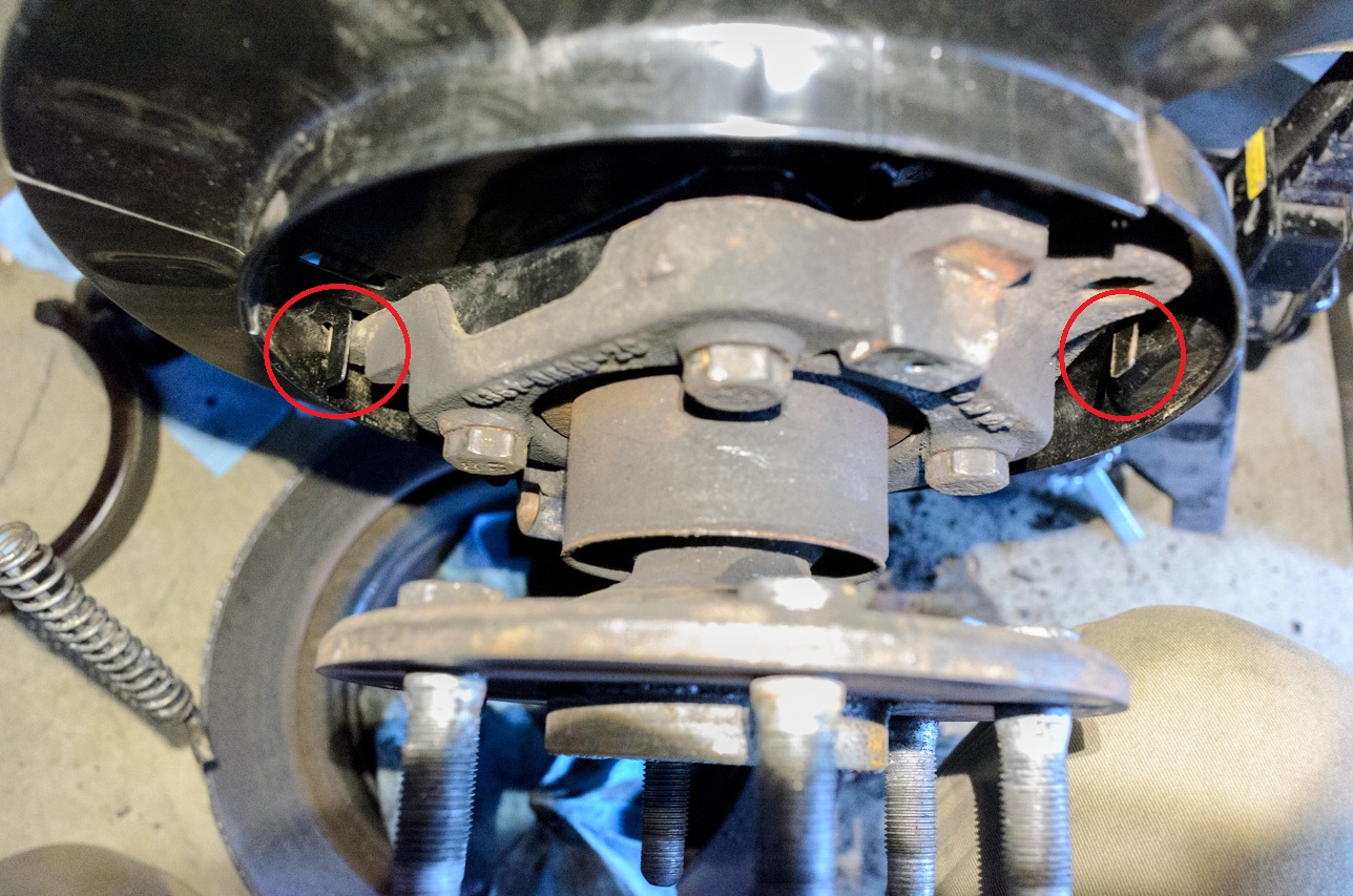

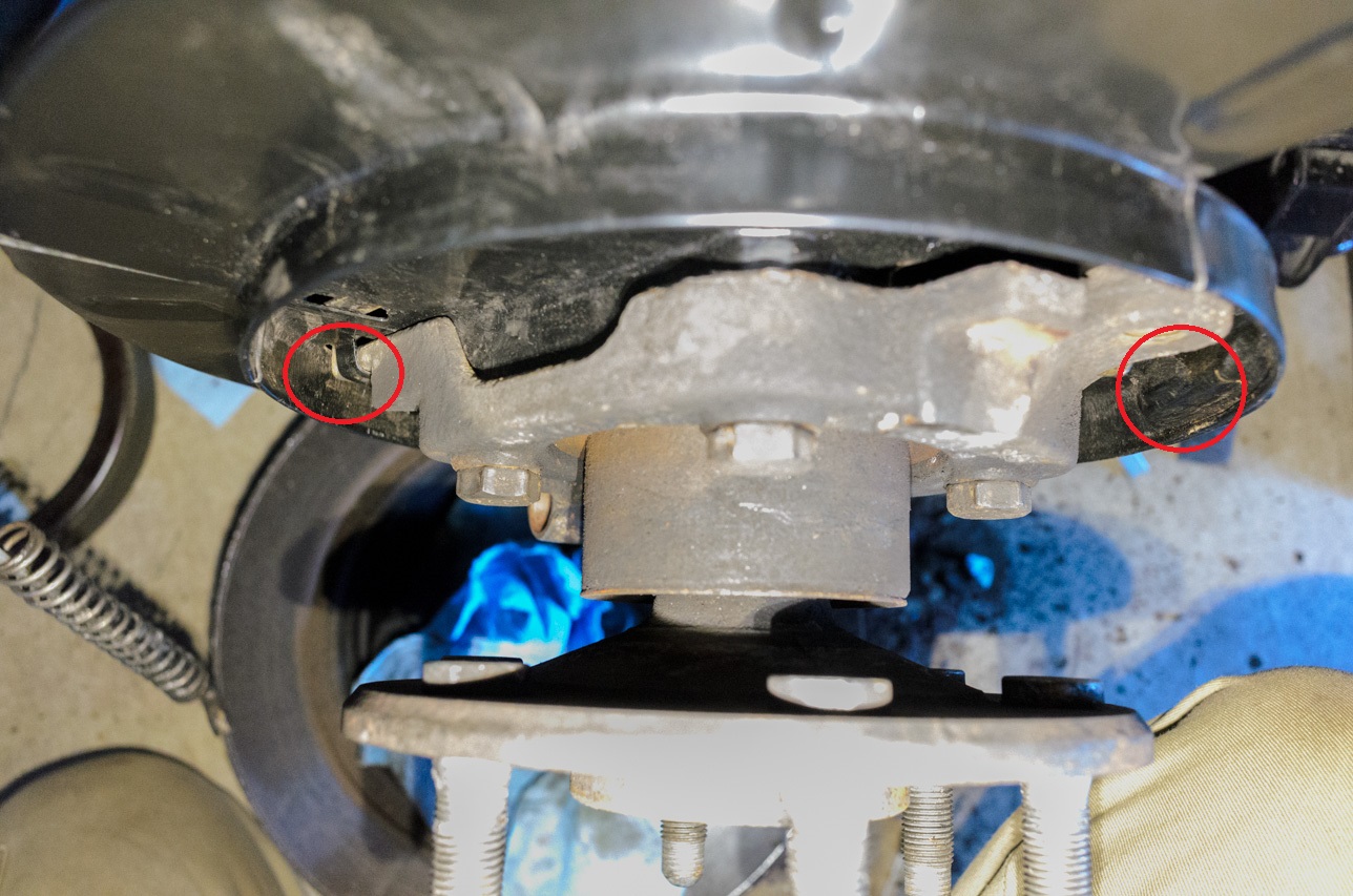

One of the problems people had when installing the Dorman, and I assume it will be a similar problem even with the one-piece backing plate, are the tabs. My backing plates aren't that bad, but one of them has a hole rusted through so I might was well replace it. If you look at the red circles, you can see some tabs. I'm sorry about the lousy image. I downsized it a little too much to make the size small enough. But, you can just make out the tabs I'm referring to.
These tabs are folded over the caliper mount bracket (the thing held with 4 bolts). I had to bend the tabs back to allow the caliper mounting bracket to separate from the backing plate. When installing a new backing plate, you will probably have to bend the new tabs into place after bolting the caliper mounting bracket into place. This is often the step missed causing the horrible rubbing people complain about.
If the backing plates are badly rusted, the tabs may not even exist anymore, resulting in such confusion.
Of course, I haven't started mine yet. I've probably got more of my own surprises to come, but I thought I'd share these images for anyone attempting to do this.

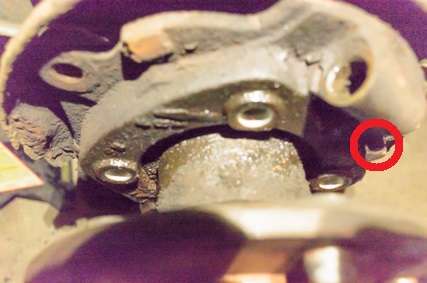

I installed the backing plates today and finished up to setting up the brakes. The biggest complaint about the Dorman 2 piece backing plates was fit. Everyone complained about scraping noises from the disk on the backing plate. Here's why: Just after installing the caliper mount onto the backing plate, you see two tabs circled in red:
Even in the 1Aauto video, showing the installation of these backing plates, they forget to fold these tabs over! I happened to notice that these tabs existed and were folded over on the original backing pates, so I was aware of this.

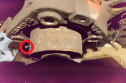

This is what the tabs should look like:
I used a punch to tap them flat. The disks are installed and there is no rubbing. They fit fine.
