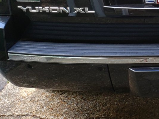

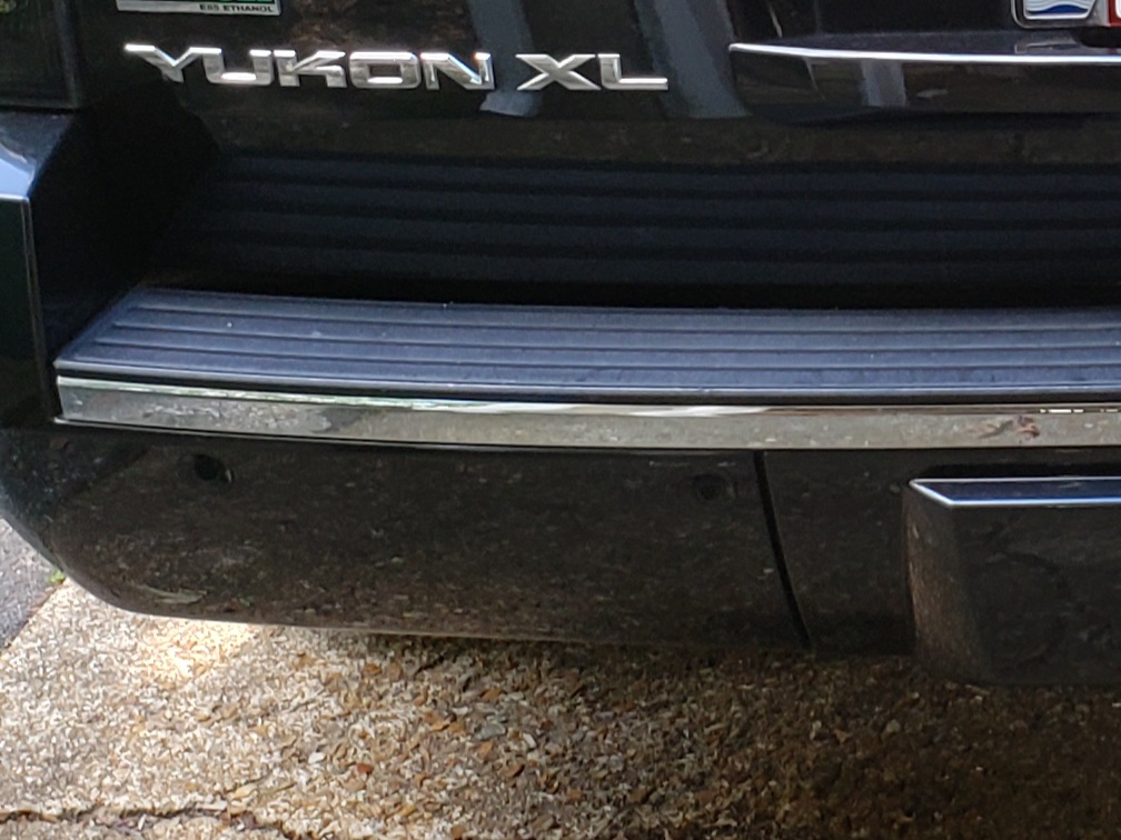

Parking sensors are the nickle sized round spots along the top of the rear bumper cover. They're not on the liftgate
You can see the two left ones in the pic just under the chrome strip

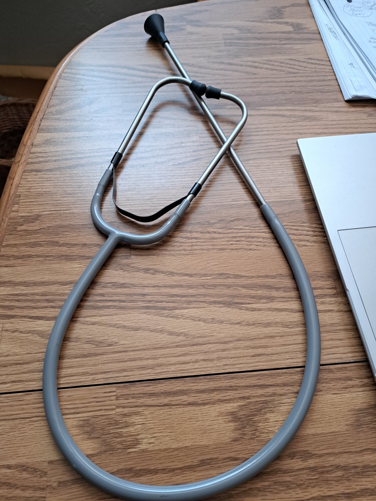

Since I have done some more research about hearing the pulses from the sensors, could you theoretically use a "mechanic's stethoscope" to hear those pulses?

Well, the customer/friend just left and I had the failed/bad left outer sensor diagnosed in 30 seconds. He turned key on and put it in reverse and I listened to all four and the three that still worked had a distinct Geiger Counter noise and the bad one was dead silent. I was gonna use an app that reads decibel levels, that I saw a few times on you tube, but I just used my mechanic's stethoscope and used the nose cone adaptor and held it over the sensor and the noise was there. Very easy to detect.

!I had no faith in the decibel reading app thru the microphone on my phone. I just thought of the mechanic's stethoscope idea today. Worked like a champ!
The customer/friend is hard of hearing but his girlfriend has no hearing problems. She put on the stethoscope and I walked her down the line of all 4 sensors and she was amazed that she heard the pulse noise from the three that were good and dead silence from the bad sensor. He did not want to pay the $163 fee for the GM one at RA so I had a choice of either Dorman, Standard or Bosch. I opted for the Bosch. $24.79, -$1.24 5% discount code, $4.99 shipping and total was $28.54. He was happy with that for sure. With my labor fee at $60 an hour, he should be out the door for less than $90.
