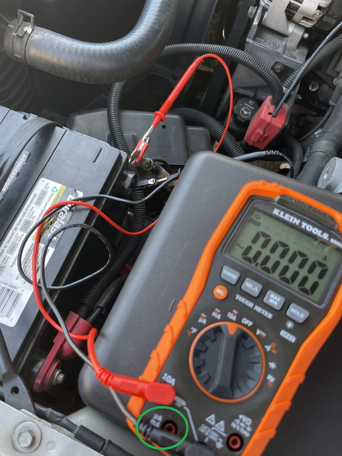

Occasionally coming across a dead battery overnight.
The battery is a few months old, the alternator is about a year old.
Turning the truck on, I go down to 10.03 volts, then 13.85 when it's on.
Off, I get 12.04 volts.
This was just after I found it dead and jumped it, so I might have to go and charge the battery and do this all over again. But that explains the low numbers for now.
Anyway, the draw test is reading 0. I have it connected as follows:
- Removed negative cable
- Red probe onto negative cable
- Black probe on negative terminal.
I have cycled through Amps and MA, I also moved it to DC, and it's still 0. I know it says AC on the meter but trust me, it says 0 every which way.

This isn't meant to be rude... you should have some kind of draw all the time. Desired draw asleep is 50mA or less, but when you first put the meter in circuit it will draw much more than that, and you can watch the module go back to sleep by seeing the draw go down. I wonder if the connection at the battery isn't making good contact. I usually use a bolt screwed into the battery to be sure. I would start with the 10A test to be sure about not overdrawing through the meter.
So, as a test, take the meter out of circuit, set the selector to ohms, connect your leads to the two righthand jacks, and touch the ends of your leads together. If it doesn't read 0 ohms (or 0.1, some reasonable resistance for a short), then one or both leads are bad, or something's wrong with the meter.
If that works, check the internal fuse(s) for continuity; it could be blown. Usually there is at least a fuse for the 10A measurement.
If you get to the point of reading mA (but depending on the instructions in the manual) the red lead should be moved to the jack circled in green, and the selector to mA:

What swathdiver and Fless said. If you really wanna test it, open a door so your dome lights come on. That's certainly a draw but it shouldn't be anywhere near 10 amps.

Nice to put a number on it. Whatcha betting- poor connection or popped fuse in the meter? My bet is on the fuse.
I would agree; and most of those fuses aren't that available or cheap. If needed, might have to get one (or two) online. Seemed to be reading voltage okay so the leads are probably good.

the Klein wasn’t getting a reading. My dads old fluke is showing 2.5 amps. Turns out it’s my ignition cylinder. You can accidentally bump it without the key, and the dash lights come on. If you aren’t paying attention when you get out of the car it’ll draw heavily.
Solved, thanks for the help.

Thats why i always test the meter first or just use old school test light first to see if it lights up.Easiest way and quickest to see if you have a draw.

Check that internal fuse for the next time it's needed.
