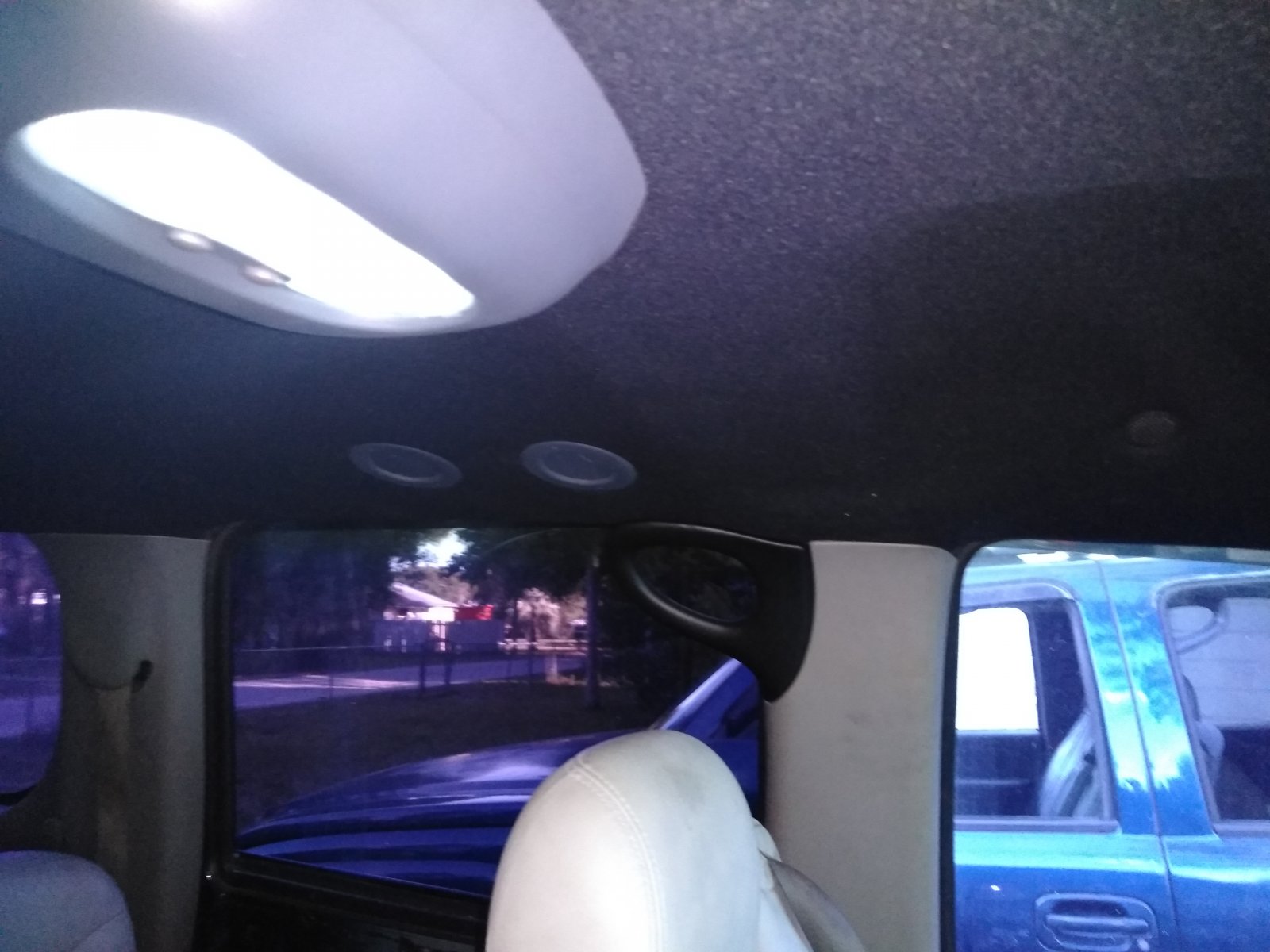

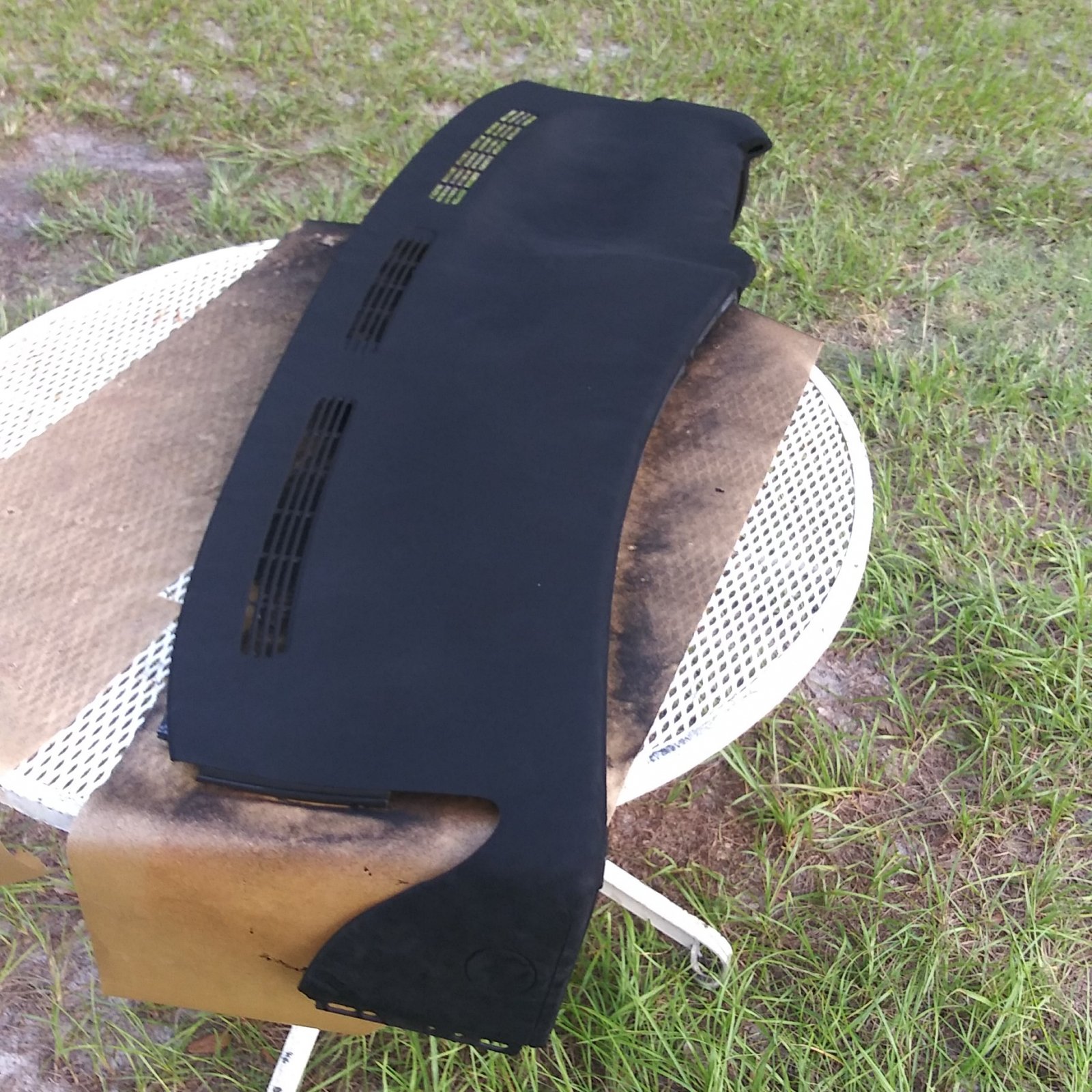

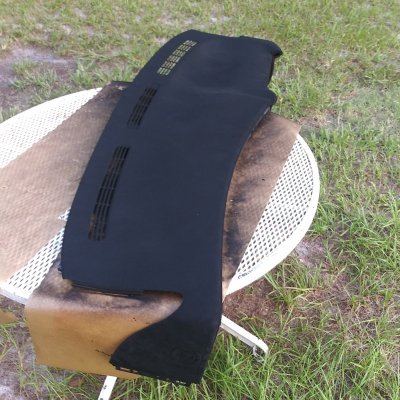

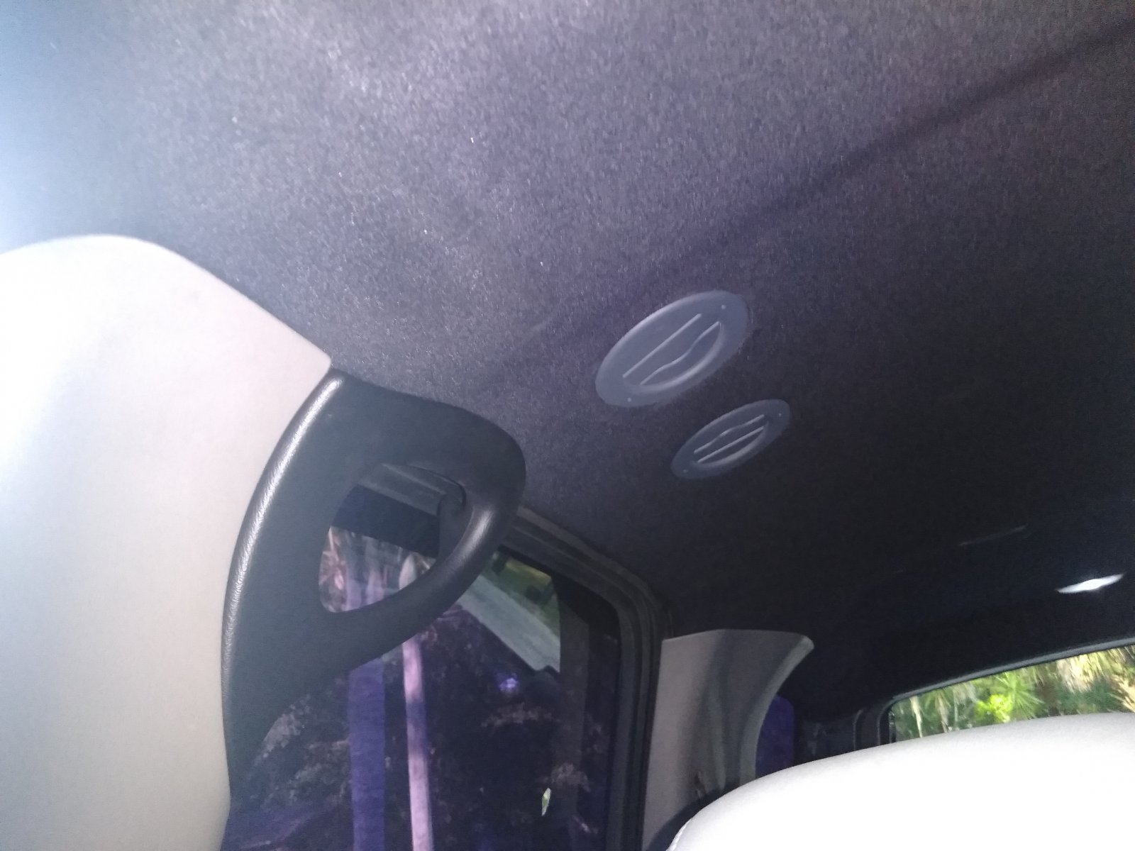

I have been using duplicolor also haven't had to much of an issue and all i have done is scrub everything clean. Vents, door panels, ect. New headliner and carpet even flocked the dash for no glare in the windshield.
