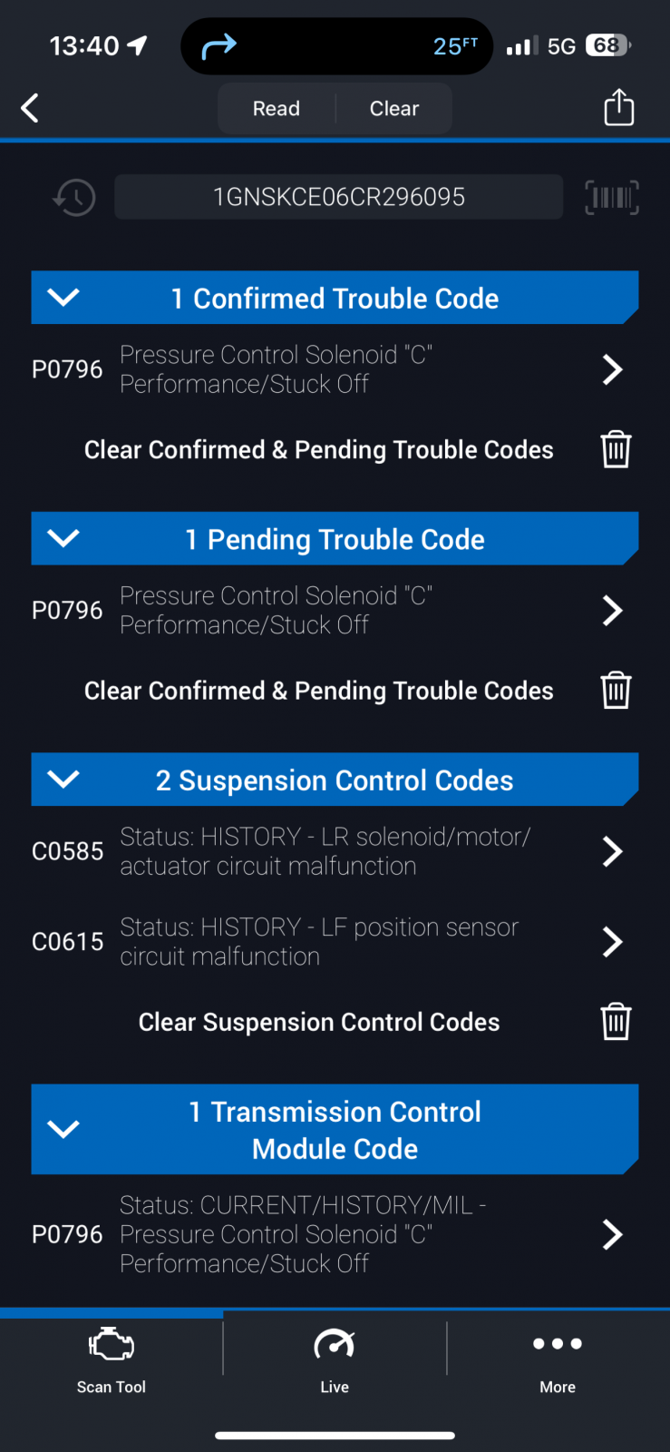

P0796 and others, while 59 miles from home

It's going back to the dealership to be done. For the first time in the history of ever, an extended warranty is paying off.
HOPEFULLY, they'll do it the way you said. I'm going to bring them a Circle D 3200 to put in it. I'll be installing a TruCool afterwards, also.

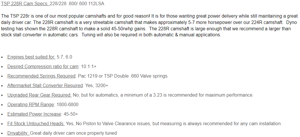

For a small truck cam, you'd probably be right.
I want to do a high lift cam, so a 3200 stall is the correct application here. (see attached)
I don't care if they cancel the entire warranty after all this is done.
Hmmm… that cam is suitable for a car, but unfortunately not a 6,000 lb truck. I think you’ll be unhappy with it unless track days will be your primary use.
Take a look at some of the high lift truck cams out there. You’ll make gains on both the low and high end.
The TSP stage 4 truck cam is nearly identical at 223/226 600/600 111
To each their own. I'm just sayin' that you'll have a big lope and your power band will be 4500 RPM and above, with losses down low. If that's your thing, then by all means, do it. I had a lopey cam for all of 2 months and I couldn't wait to get rid of it. The constant surging at traffic lights was annoying. A higher stall would've helped but then I would've had heat problems when towing. Everything is a tradeoff.
For a truck, I like the power band as low as I can get it and a smooth idle. So that's what I have. If you get that cam, I'll be excited to see how you like it. You may think it's the best thing you ever did so I don't mean to impose my preferences on you. Just want you to know what you're getting into, that's all.
Sorry if I came off rude in my replies. I've built more than a few engines in the past (albeit not a truck LS) and everyone always wants to push their opinion without any factual basis or real world experience. I should've looked at who I was responding to and known better. I DO appreciate your input. I am indeed after a lopey idle. After listening to the TSP S4 truck cam, it may satisfy my desire for playing "hot for teacher" at stoplights.
I don't tow at all, so I'm not concerned about that aspect. As far as having power down low, I don't have any as it is :rotflmao: These 3.08's gotta GO. I'll be swapping those this summer, before I put a cam in it. This thing is an absolute doggggg down low. Hoping to find some 3.72, as I think going 4.11 is just going to be way too much time in high RPM.
