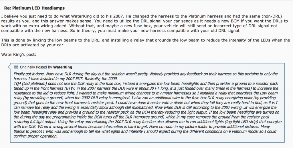

I guess it's because of the completely different type of DRL signal involved. The HID harness has a dedicated DRL signal, the LED harness has a DRL signal that is a low voltage low beam signal. In fact the LED harness has a resistor built into it just for that function.
But obviously there's something else that's affecting it ... my suspicion is that it may require a computer reprogram, which apparently is not a simple matter, as these are probably not programs available at a dealership level. That's just me guessing tho, like I said hopefully they'll figure it out by tomorrow, otherwise I'll just move on.

Serge didn't WaterKing do this conversion on Cadillac forum? I'd trying PM'ing him to see if he got it to work or if he just rolled with no DRL's.

I'm not giving up ... in fact I just emailed the above screen shot to my service rep to pass it along to his tech. It looks like there's a solution, now it's up to them to make it happen. I'm not sure what else I can do. :shrug:
