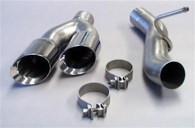

Volant is on backorder, still looking into SLP, but in the meantime, I found this gem! Yes, that would be Corsa...
