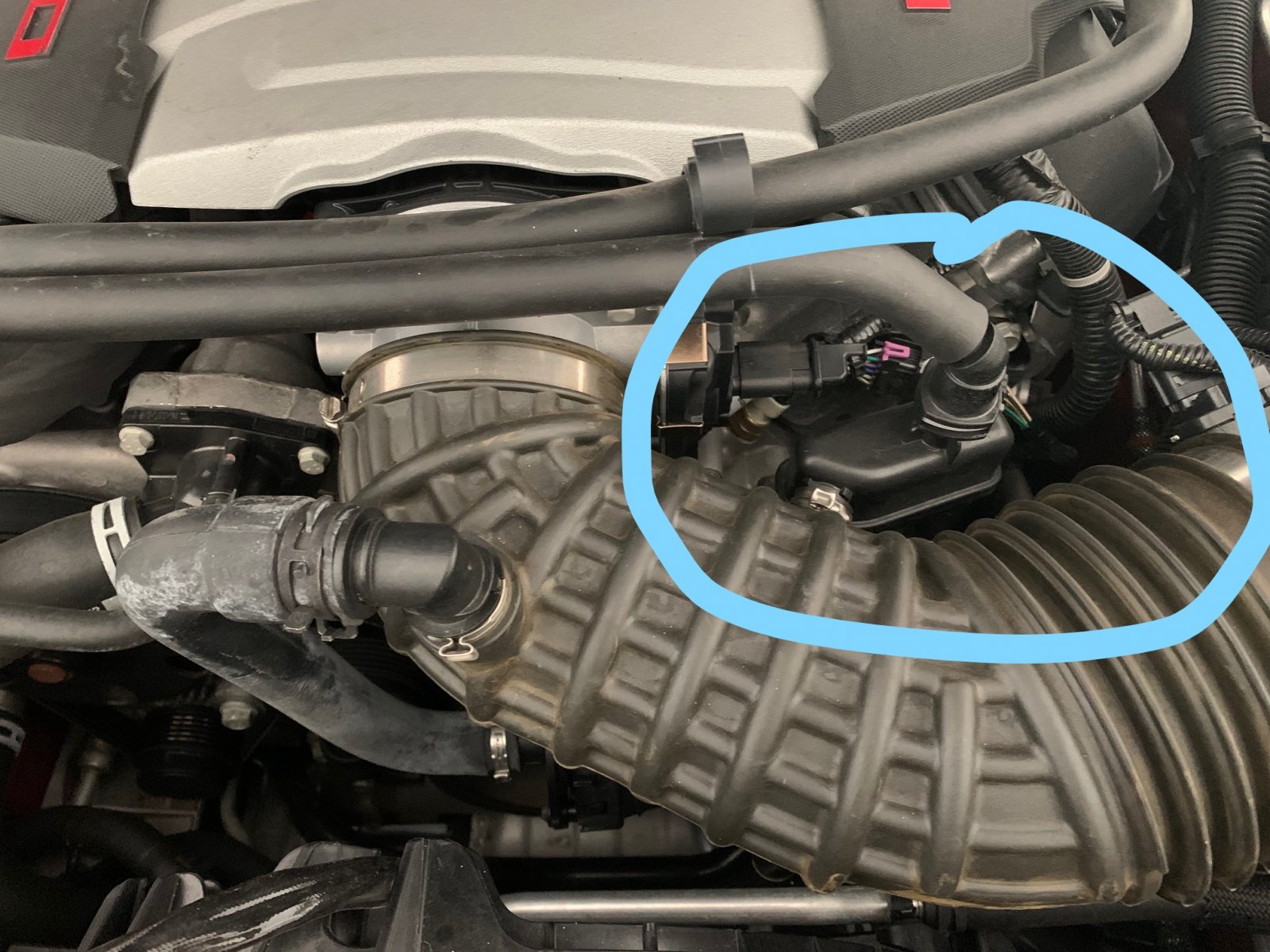

The LT 1 engine has 2 factory catch can. They are black plastic boxes with breather tubes leading into the intake manifold. I dont know if the L 86 has them.

They do not. Hoses go straight from the valve cover to the intake.

Here is Camaro
