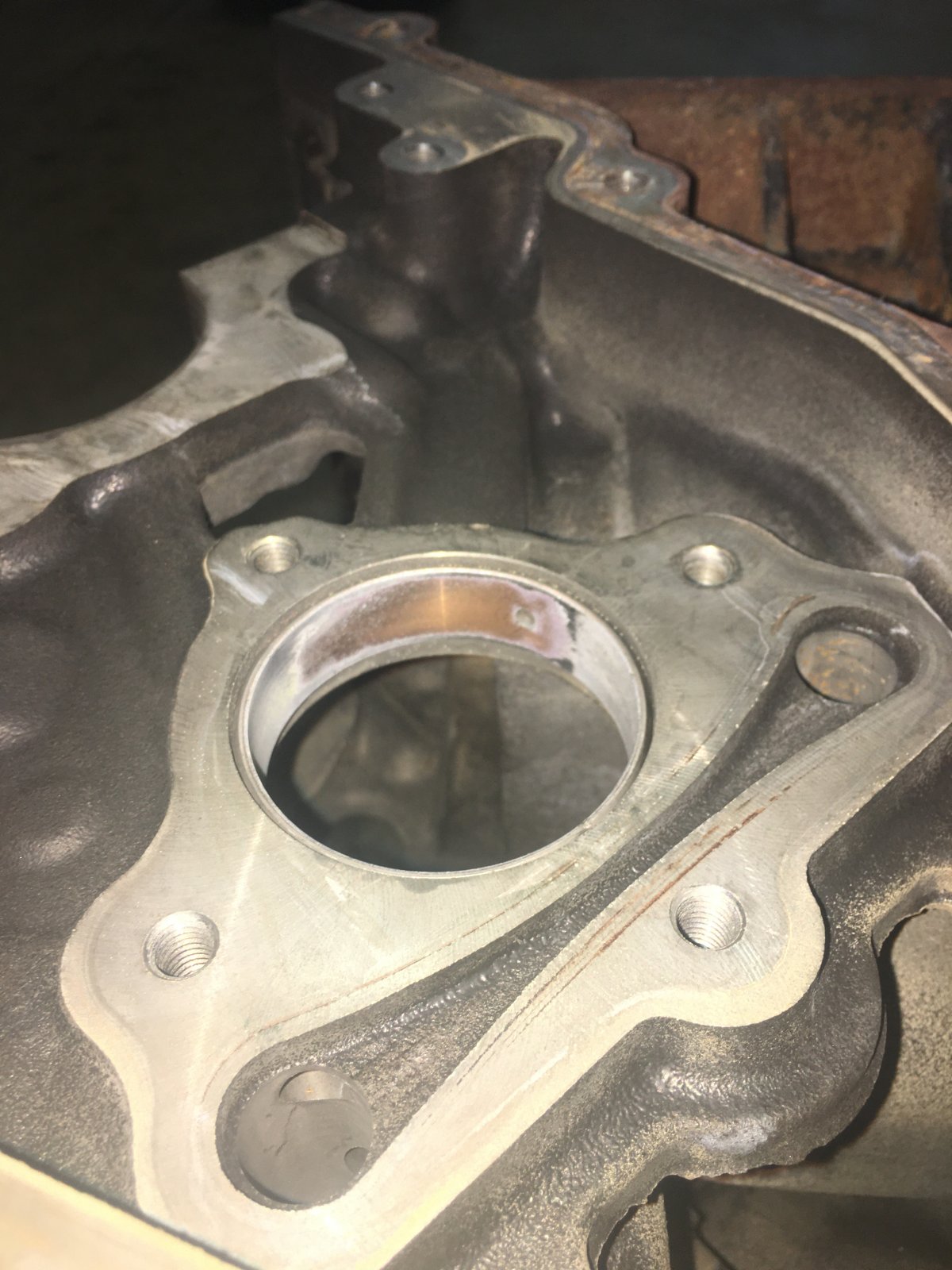

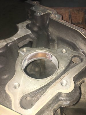

170,000 miles at 240,000 I would recommend cam bearings if swapping cam. Bar bell and hand ported mellings stock pressure pump. I agree hp and hv rob power. I have 40psi at idle and about 55psi cruise and can peg the gage at 6000rpms.
