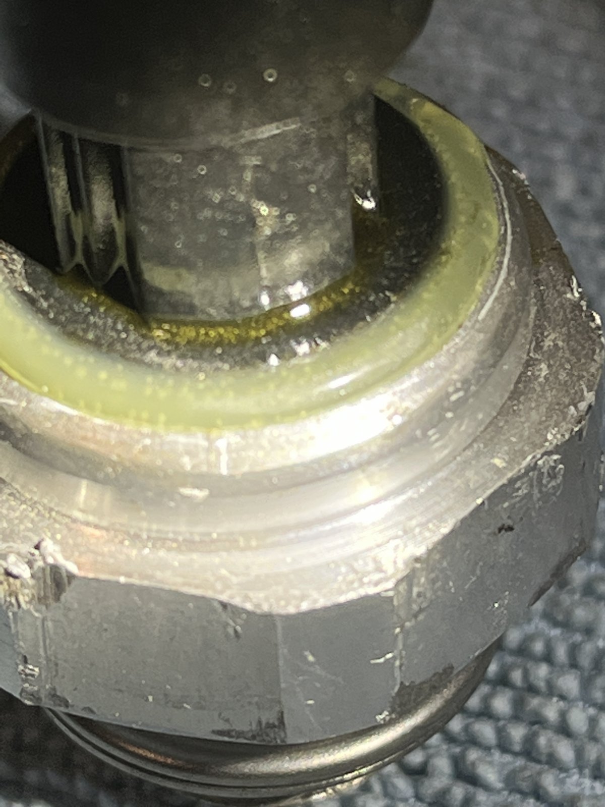

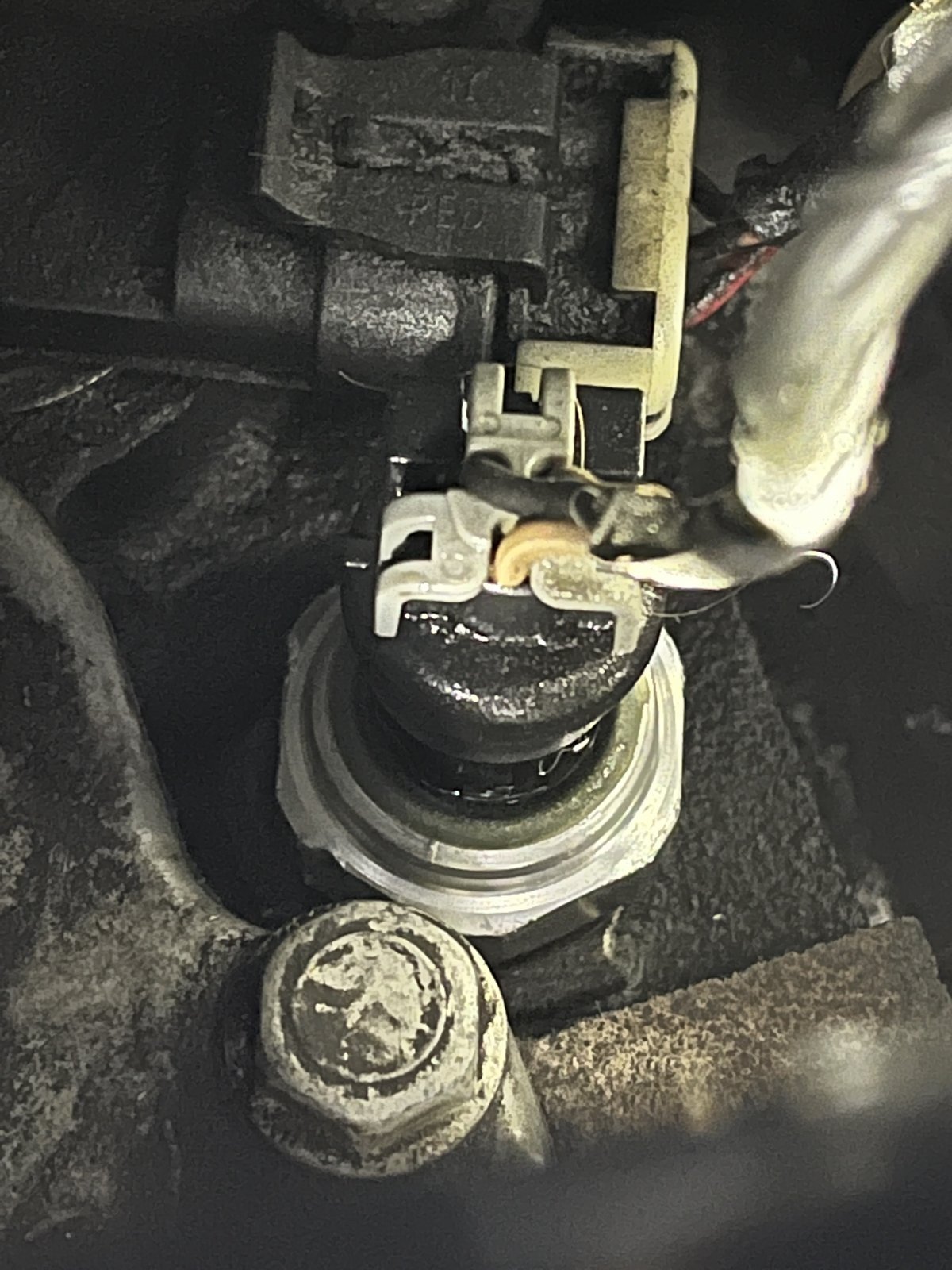

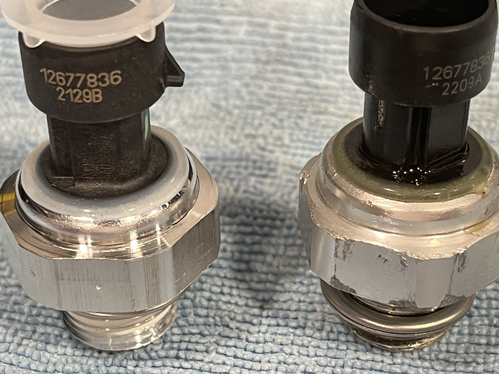

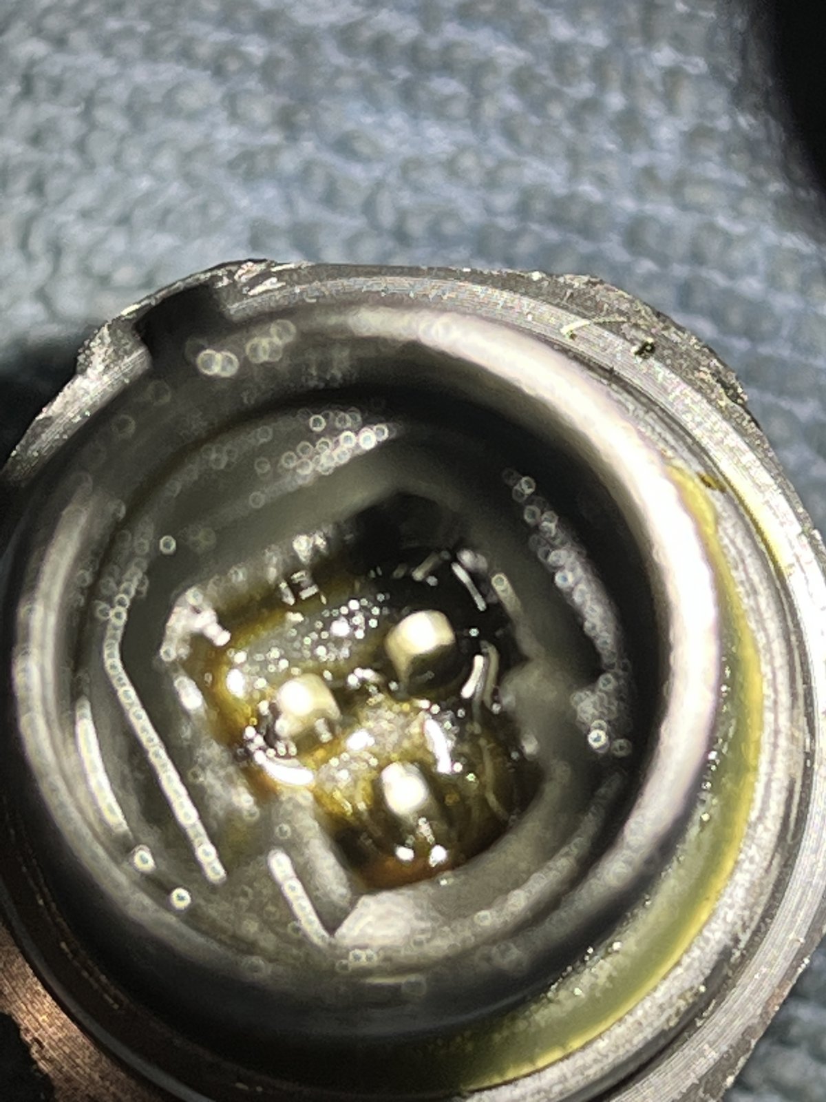

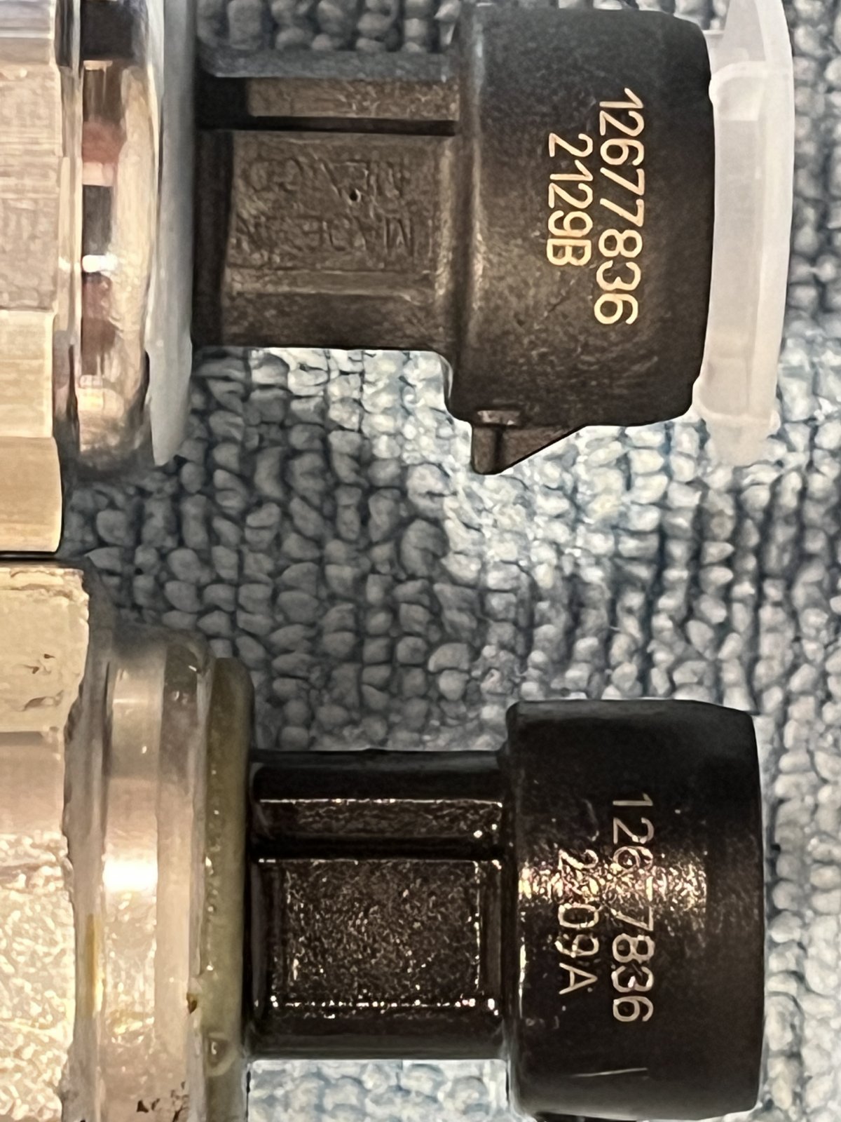

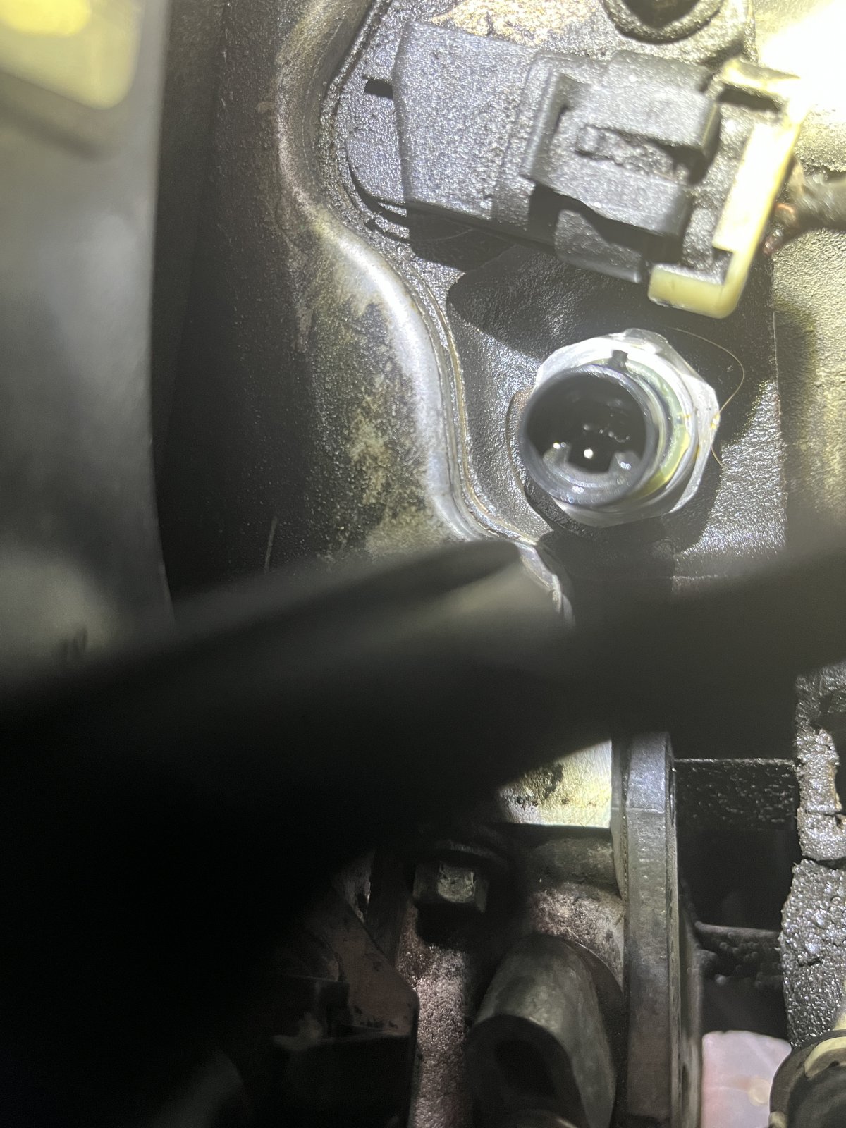

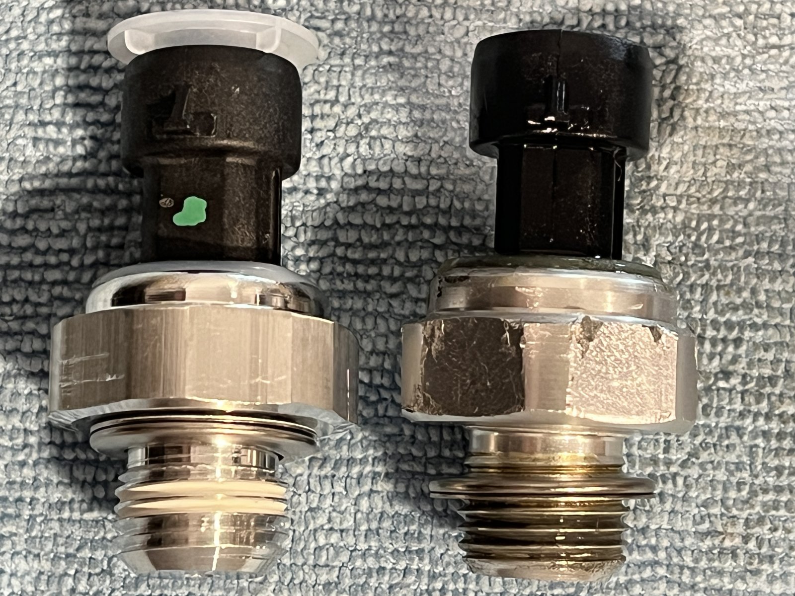

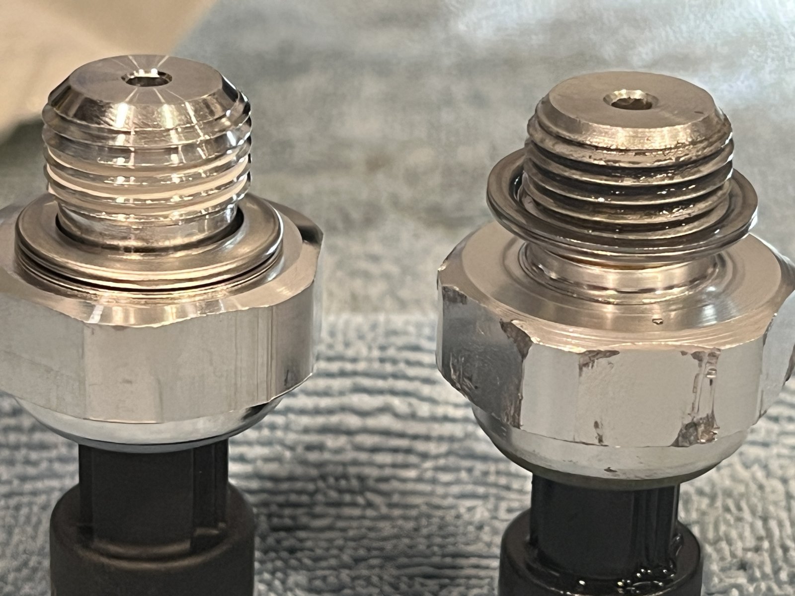

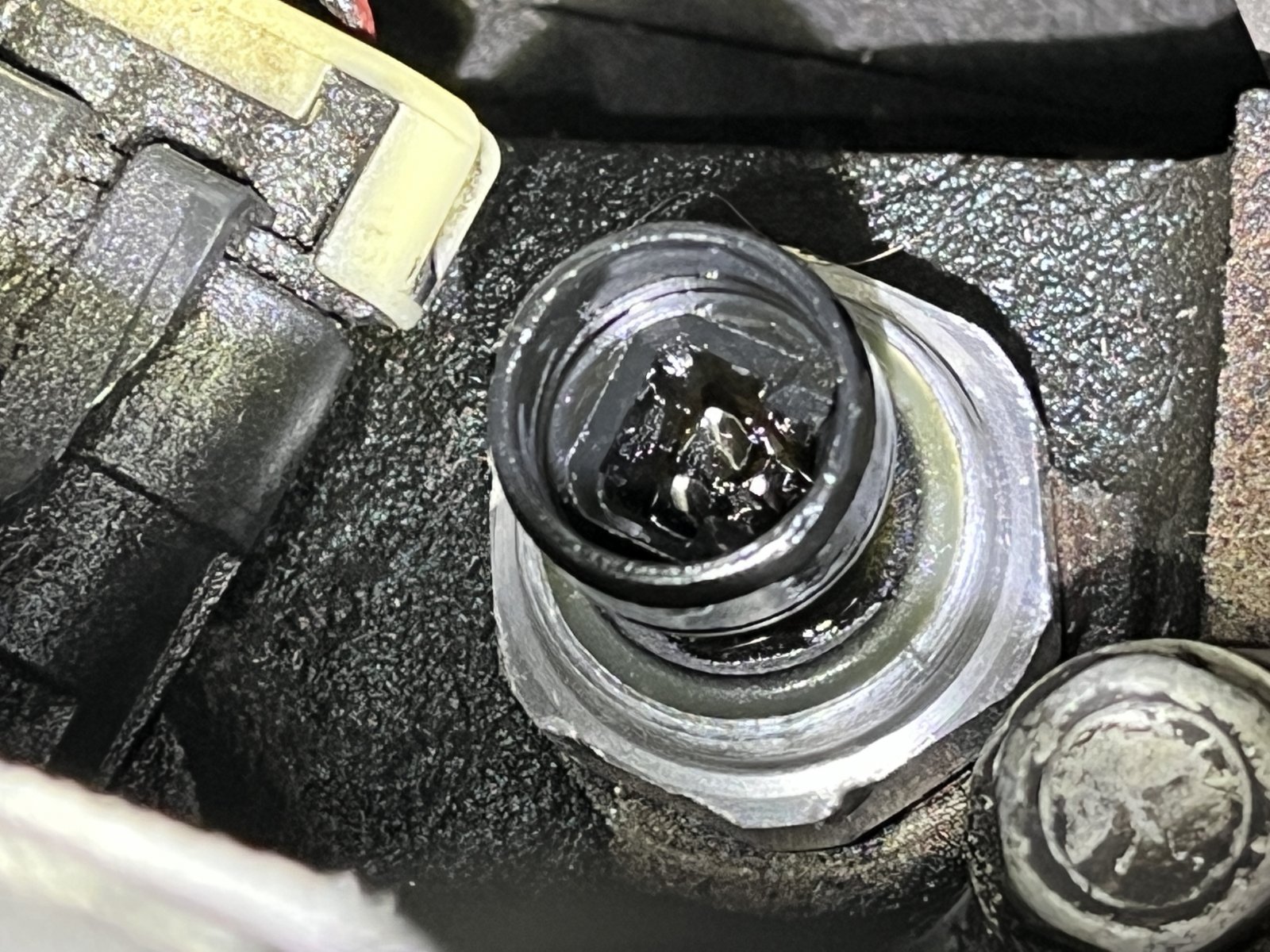

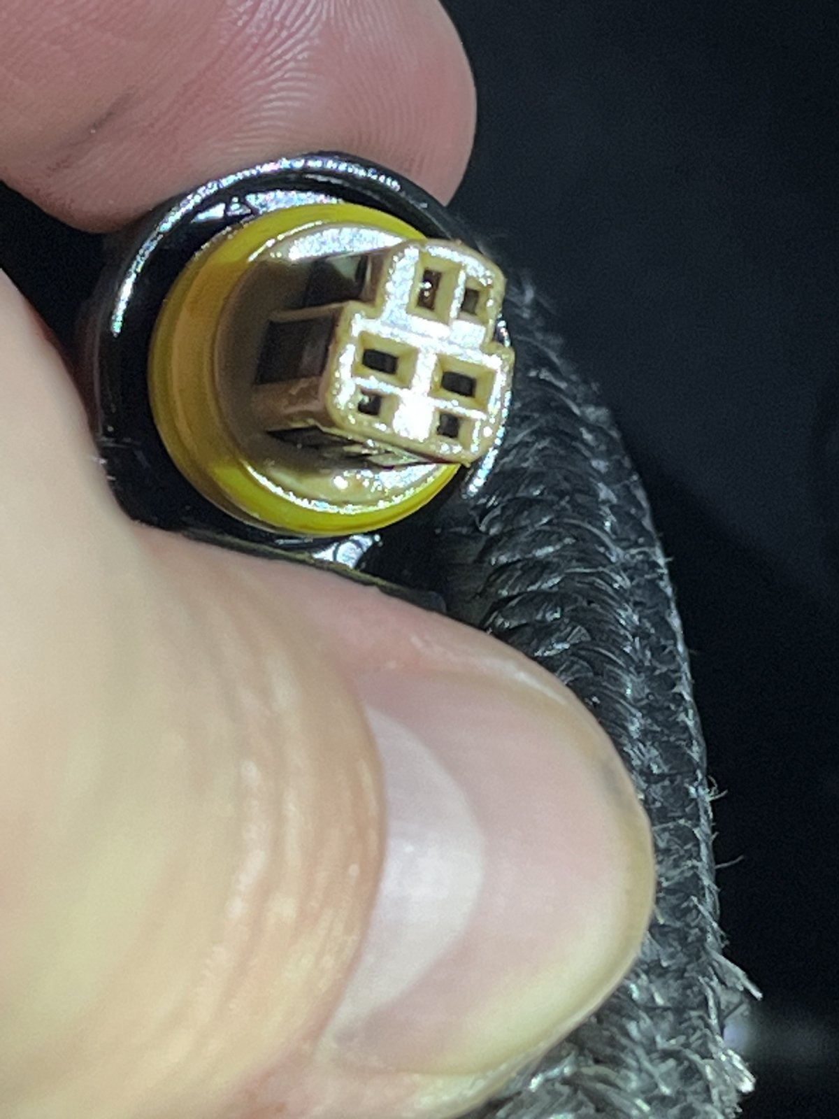

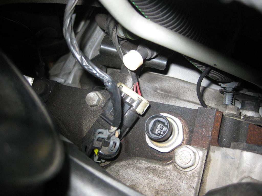

I need some help with this. 2005 Tahoe Z71 with the 5.3 gas. I am on my 4th oil pressure sensor in 3 years, second in the last 4 months. Same problem each time, oil leak at the sensor connector. Oil is inside where the pigtail plugs in. I notice the small spots on the floor first. Eventually the gauge starts to misread due to the oil in the connector/pigtail. I have been replacing them with ACDelco PN 12677836 and I have the correct socket. There is no screen that I can see or am aware of on this engine below the sensor. It is not leaking around the threads, it is inside the connector.
Either I am doing something wrong when I replace them, something else is causing the same failure across multiple parts, or the parts are just crap. Anyone else experience this? HELP?
