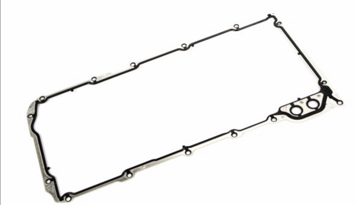

I did mine on my Denali. I was able to pull those 4 bolts on the front diff and I had to pry it down a bit after it dropped as far as it would on it's own. It was tight and I had to maneuver the pan just right but I got it. There's 2 pop rivets holding the old gasket on that I drilled out and decided to put new ones in so when I was maneuvering the pan back into place the gasket wouldn't move out of place. Don't forget RTV sealant at the 4 places where the front and rear seals intersect the pan gasket. You'll need to pull the cross member too, obviously. Also don't forget the oil cooler gasket or block off plate gasket if no oil cooler, and I'd replace the oil pump pickup tube O-ring since you're right there. It's not too bad, but a bit challenging.
