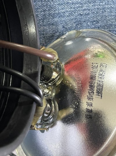

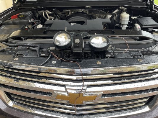

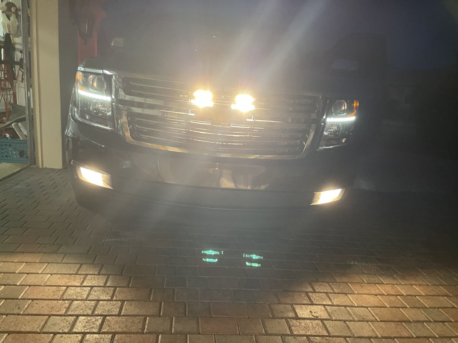

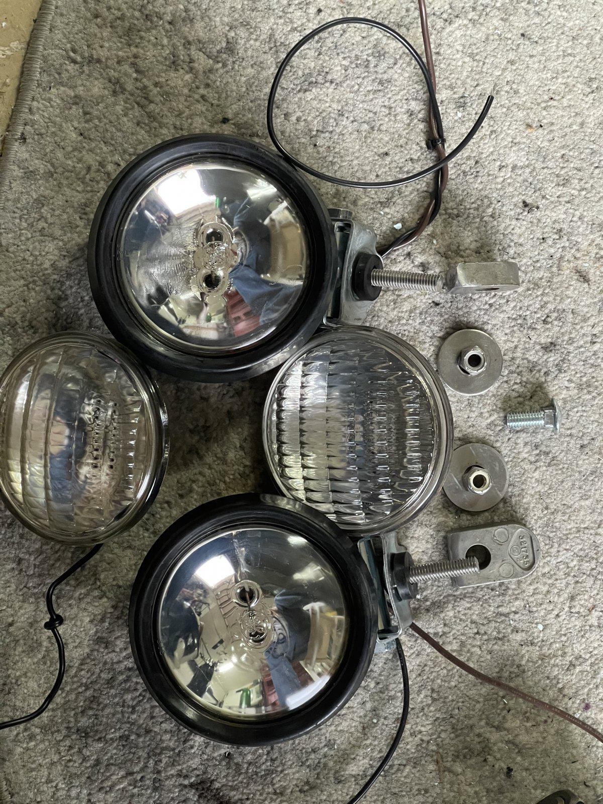

Pull the grill/ radiator cover to see if it’s the same as my 2015 ltz…. You have to move the hood latch to fit the Grote par 36 light mounts behind the grill I swapped the bulbs for Aircraft landing lights that are 100 watts each Did Not have to drill any holes they are VERY BRIGHT… All parts shown in my picture…. They are hidden but there when you need them. Total cost about $100…. Advance auto sells the tractor lights for less than 20….so I bought One to trial fit then got the bulbs on E bag and used Bosch relay and wired lights to come on with fog lights…. You may need a switch !!

Bright/ illegal/hidden/ 16 amp draw
