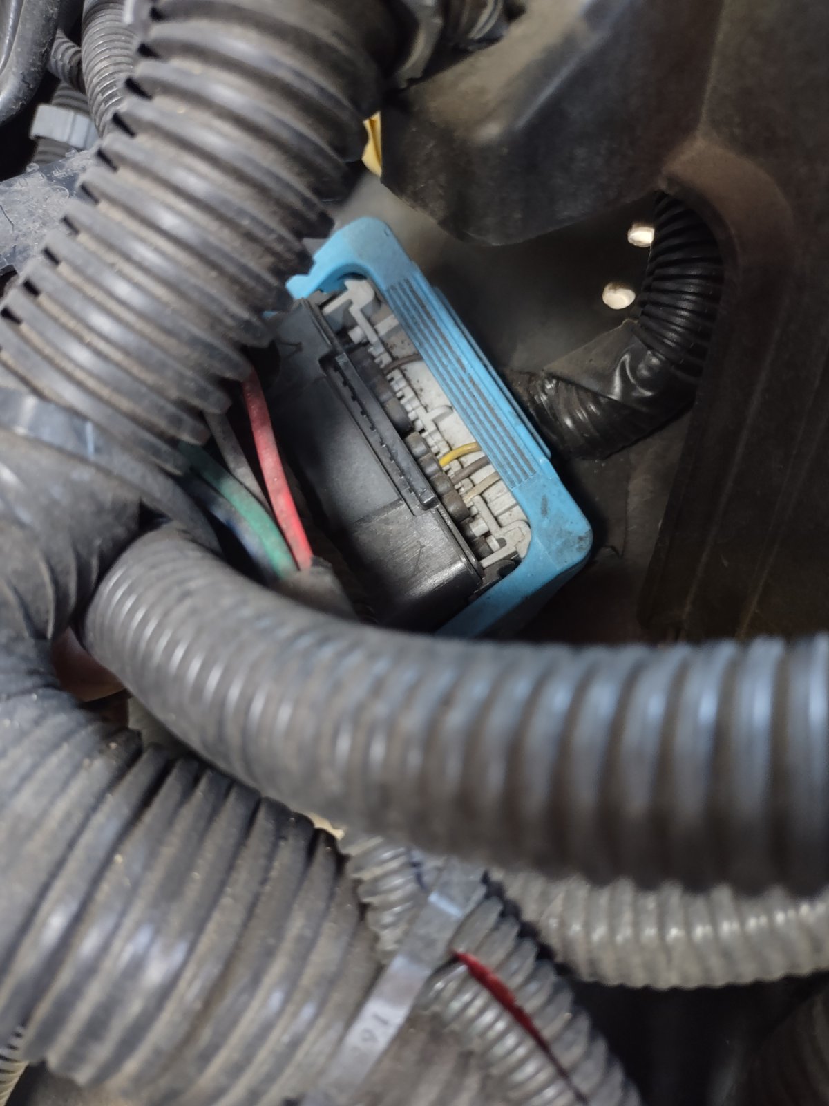

Thanks for having me on the forum. I bought a 2012 Tahoe SSV, with the 5.3, tow package (they never towed with it), locking rear, 2 speed xfer case, 85k miles.
Most everything is really good, except for the brake lights and reverse lights - they're inop. I used a OBD 2-way scanner and the BCM shows it's receiving the inputs and sending the signals to the lights but the lights don't get the message and I can't actuate the lights with teh scanner.
I believe that when they decommissioned the truck, they cut something and didn't reconnect. The lights, themselves look good and the ground for them does too. Where should I look to find the disconnected wires?
Great appreciation for your help.

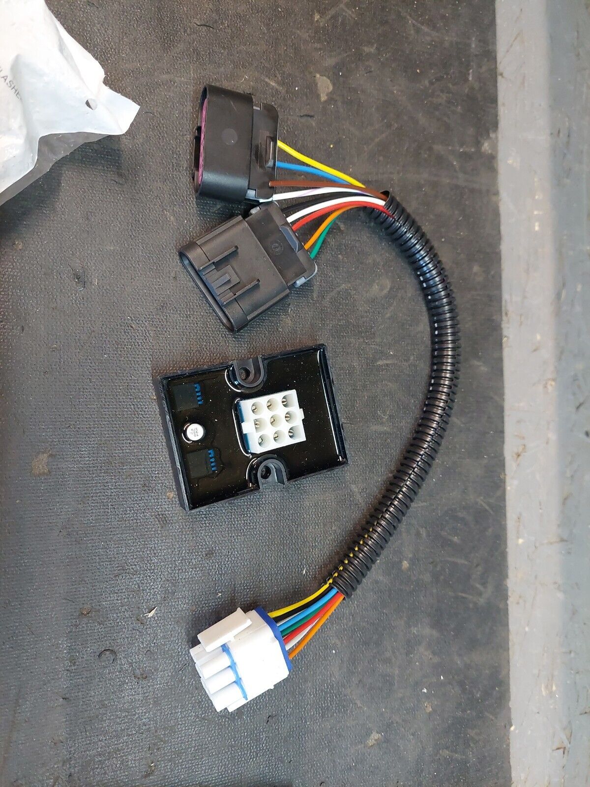

Don't know if this will help, but some info on flasher units..
Instructions to a Whelen flasher unit..

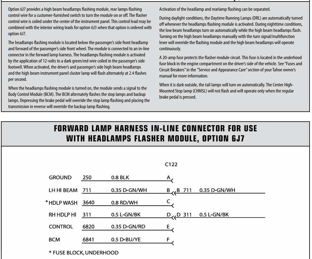

Also here is an excerpt from the 2012 PPV brochure..

I would grab a multimeter or test light and start with checking for a signal at the BCM. For a 2014 (should be the same) reverse is a Dark Blue wire, white plug, pin 22. Brake wire is Light Blue/White wire, brown plug, pin 6.
You could look into the flasher situation like @mikez71 said as well. If you have RPO code 6J7 you'll have a flasher module from the factory which is located in the passenger side wheel well. Check out the upfitter guide for our trucks, lots of good info.

I believe that you can find the electrical wiring diagram on www.charm.li if you have to get into tracing wires.

How about wire harness connections. Those plugs may be different with a police package. It would be good to look at the wiring diagram for both to see if the inputs are the same. I bet that is your problem.
