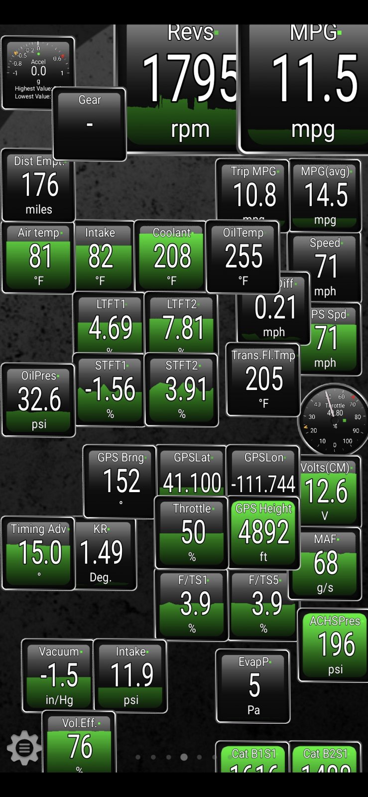

I am in the cold elevations often and I like the warm up the oil quickly fxn of a working thermostat, wonder if my '07 denali has it, and if it does, i suspect it may be stuck open... was towing heavy and fast at elevation and saw oil temps of 260. Attached is a TorquePro screenshot oil and coolant temp mid upper right.

That is about the only way to diagnose a stuck thermostat.... By looking at the actual oil temperatures

did some years get a real oil temp sensor?
mine didn't. it's just some math based on other to things.

You'll have to tee off the OEM oil pressure sending unit location to put an oil temperature sending unit. You'll be able to watch fluctuations in temperature based on which way that thermostat is sending the oil, if it's working.
My 07 Denali doesn't have an oil cooler.
