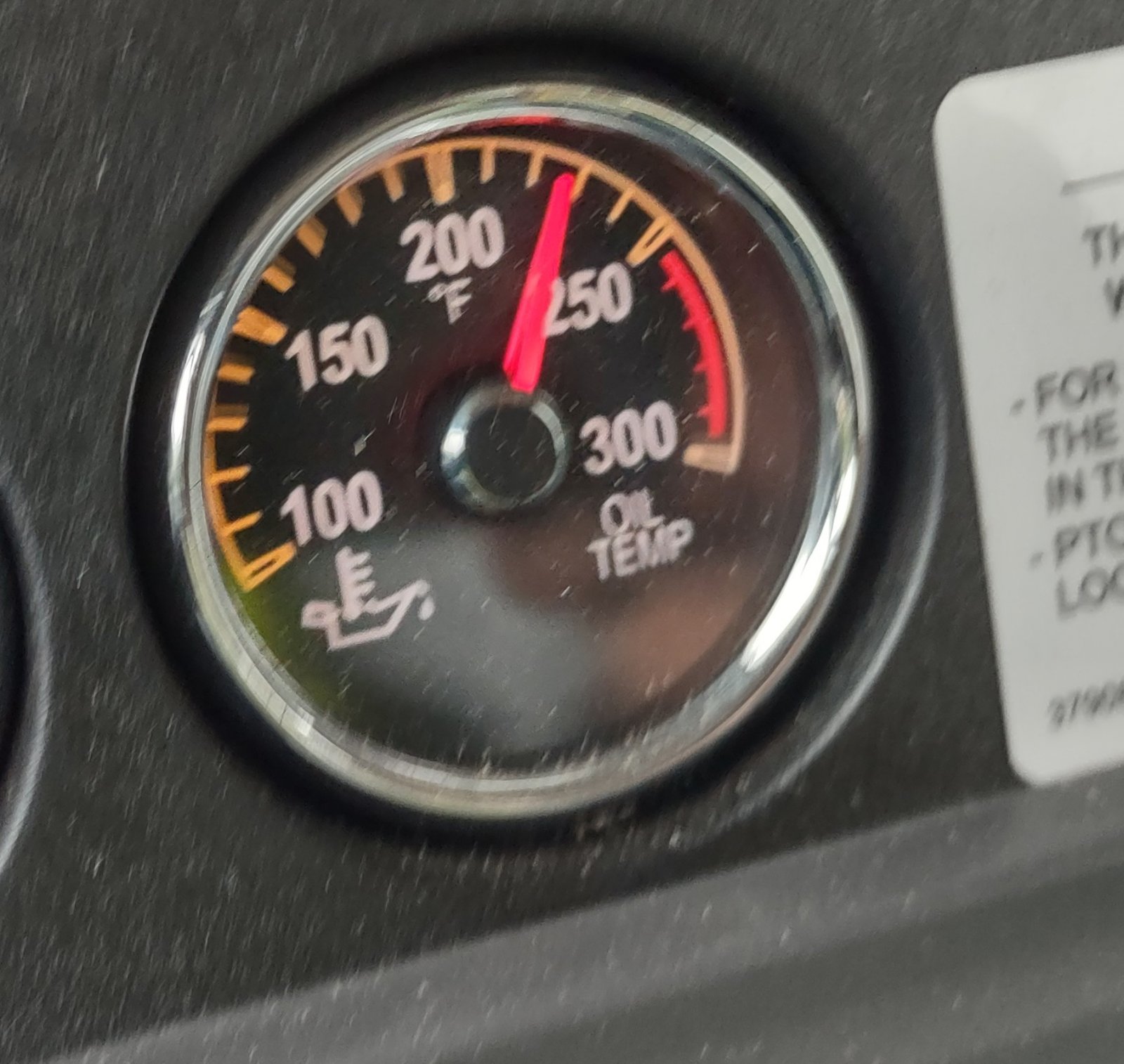

Our 2025 Peterbilt trucks at work, such as the one I'm driving right now, keeps the oil between 225 and 245°. That's with a full synthetic 15W40. And that's the factory specs on it. It maintains that temperature range whether you're empty running down the freeway, or fully loaded to 105,500 lb with wood chips climbing the pass.
The oil change interval is rather impressive. Cummins has it at 45,000 miles for weight up to 80,000 lb, we run extended weights and our interval is 35,000 miles.
So yeah, with today's synthetic oils I wouldn't worry too much about not having an oil cooler on the 6.2, unless you're pulling 15,000 pounds up a 5 Mile long 7% grade.
Just got on the freeway empty, check out the oil temp

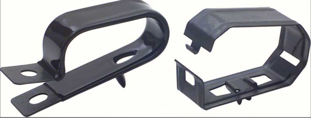

I made one alteration about 4 months ago, came across a cleaner bracket to hold the hoses utilizing the OEM bolt on the left side of the engine:
Available here:
Hose bracket

I then picked up some large heat shrink tubing from Napa, slid over the hoses where they go through the bracket. Two layers, I figured extra protection. Probably doesn't need it though.

Aw man, I wish I would've thought to look for that! My cooler line was a super pain to remove. I did not want to screw with the diff, I had the motor mount to do anyway.
