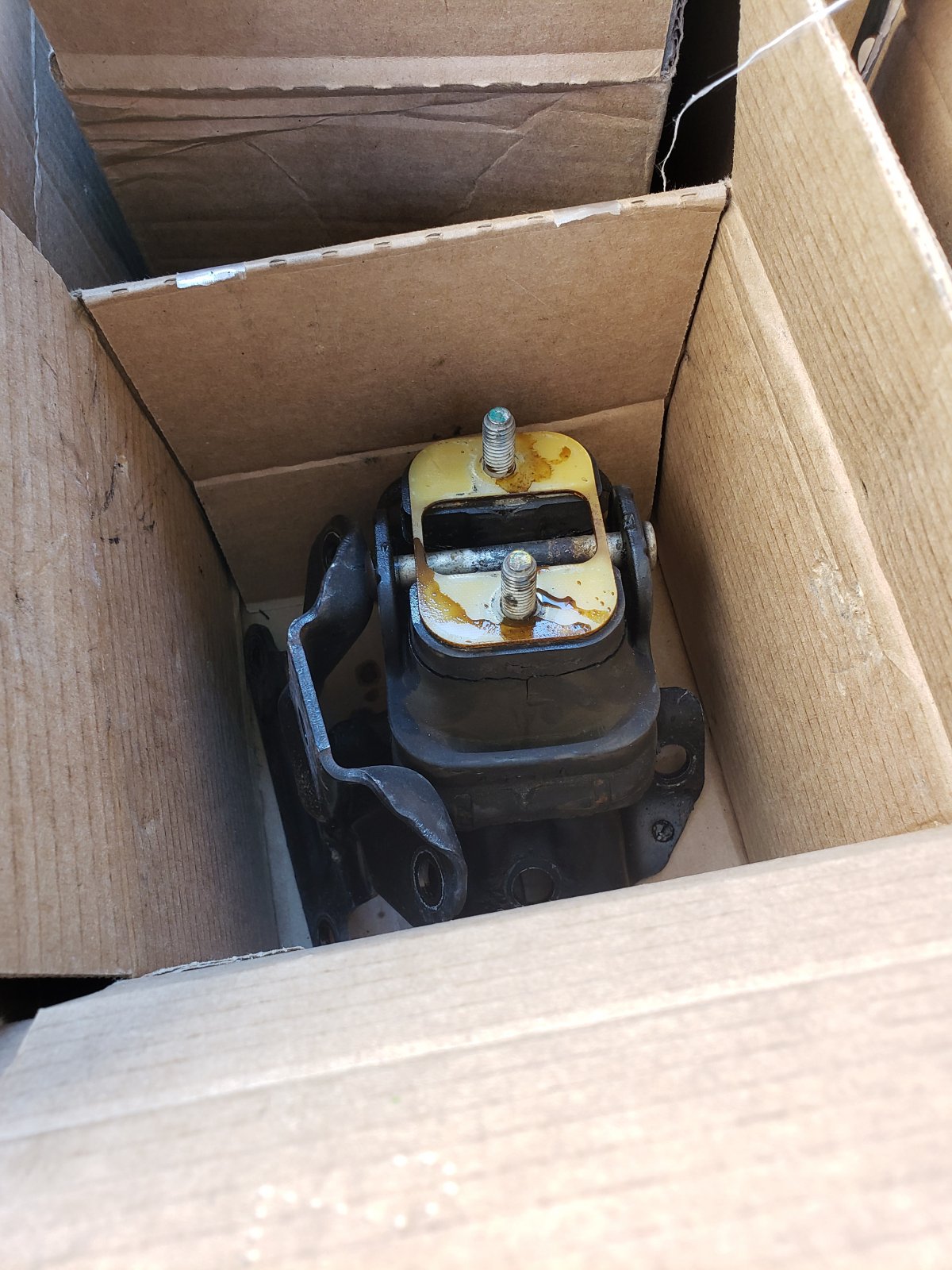

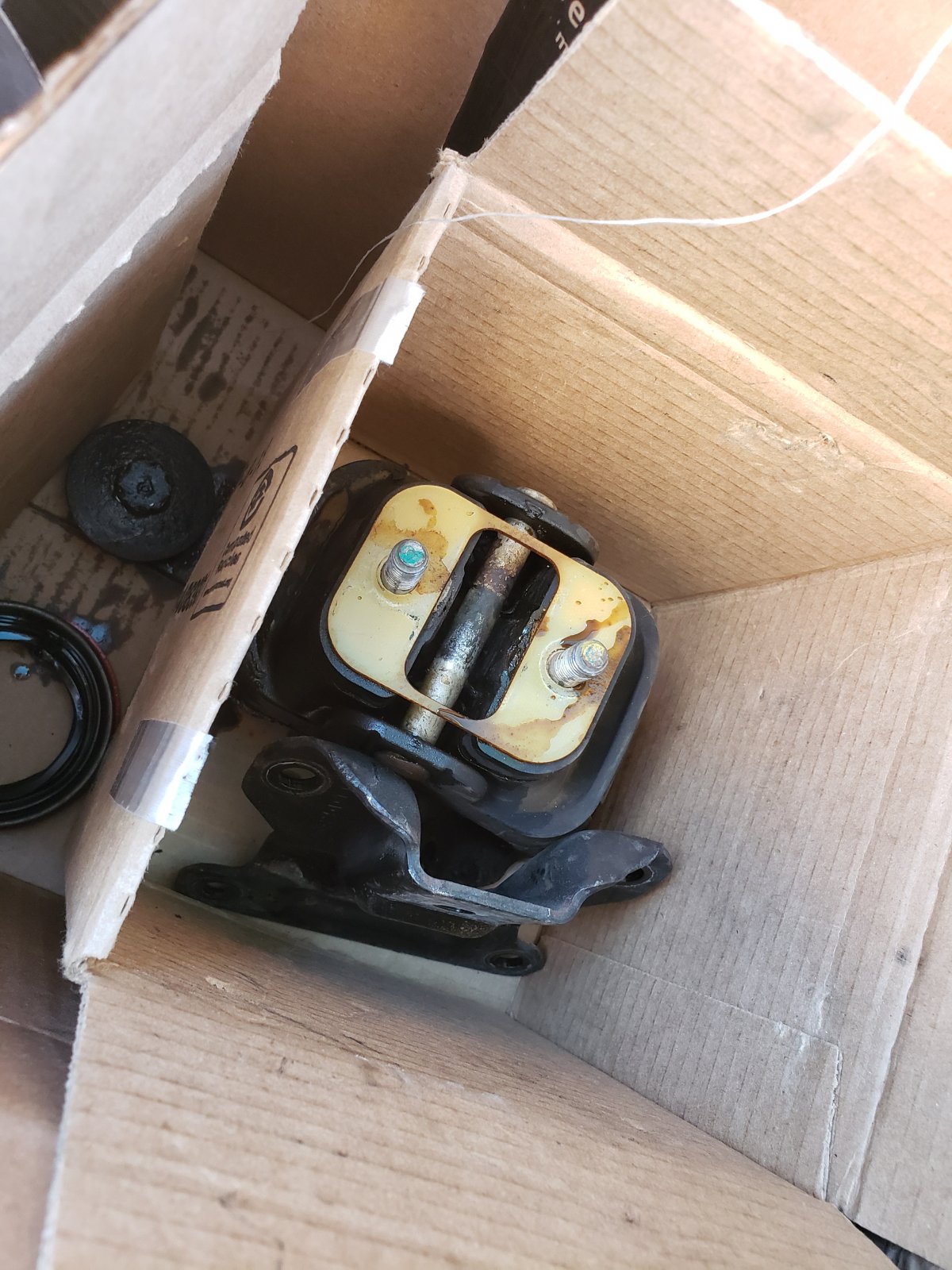

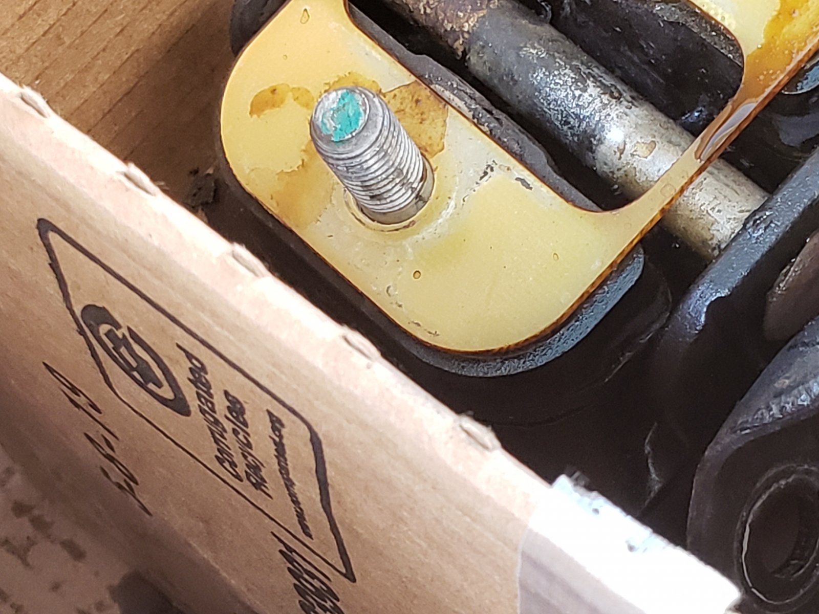

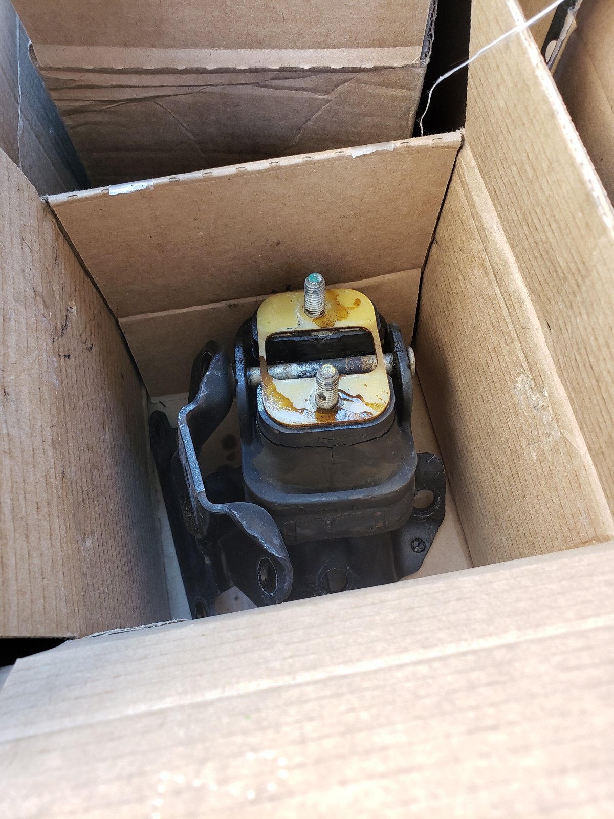

Update: this story has a happy ending, folks. It was indeed the motor mounts; they were pretty much destroyed. I had the shop replace both mounts and fix the leaking pinion seal. Here are pics of the old ones right before the shop tossed them.
20190903_163220.jpg 20190903_163208.jpg 20190903_163152.jpg 20190903_163150.jpg
The thump is completely resolved, and there is no clanking when going over bumps any longer. :):)
Many thanks to all you guys for helping me through this, especially @Doubeleive! Major props to you sir!
View attachment 229908 View attachment 229909 View attachment 229910 View attachment 229911
Next time, when you test some motor mounts, you F-IN' TEST THEM! Get on that throttle! :bleh:
