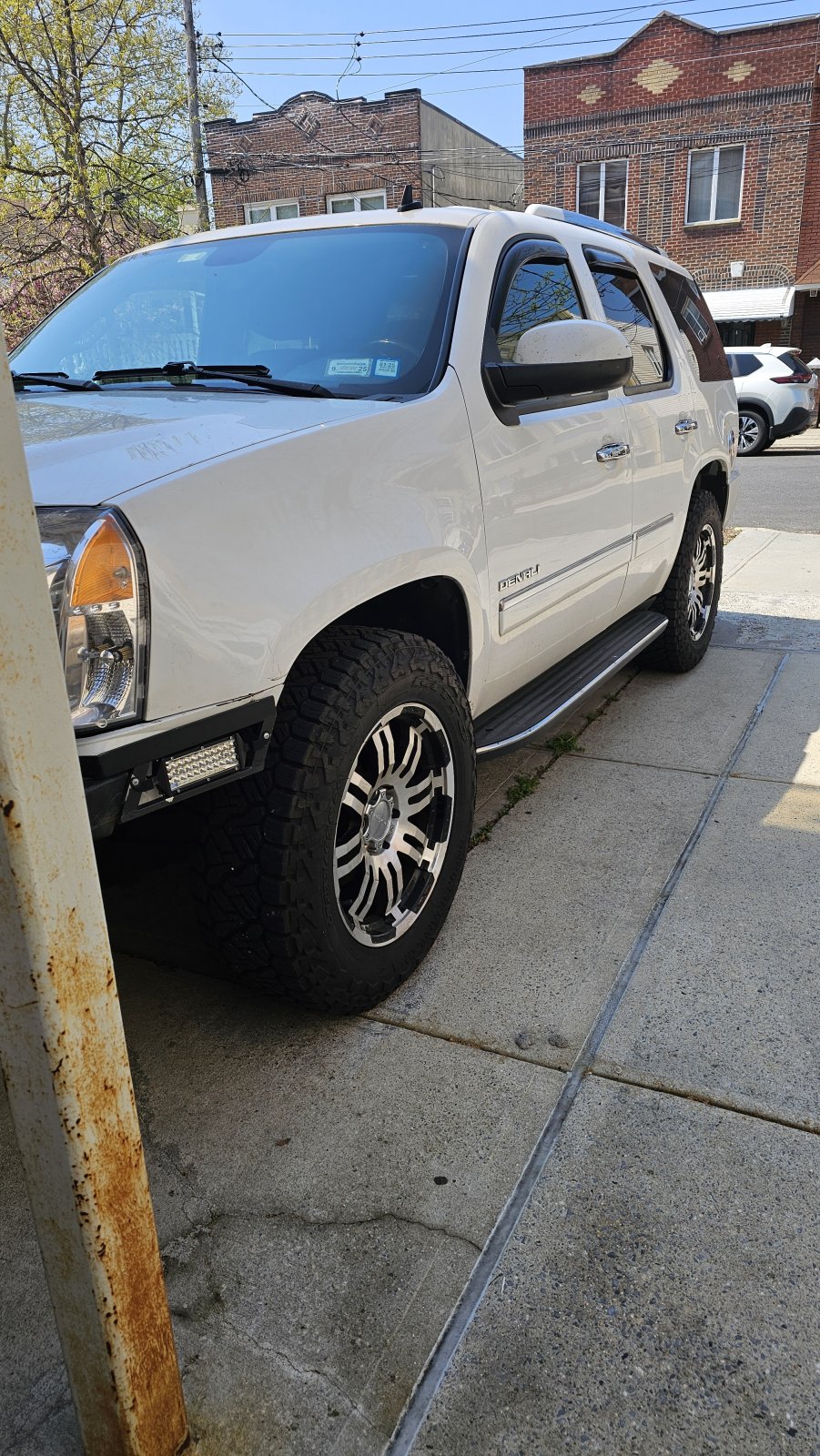

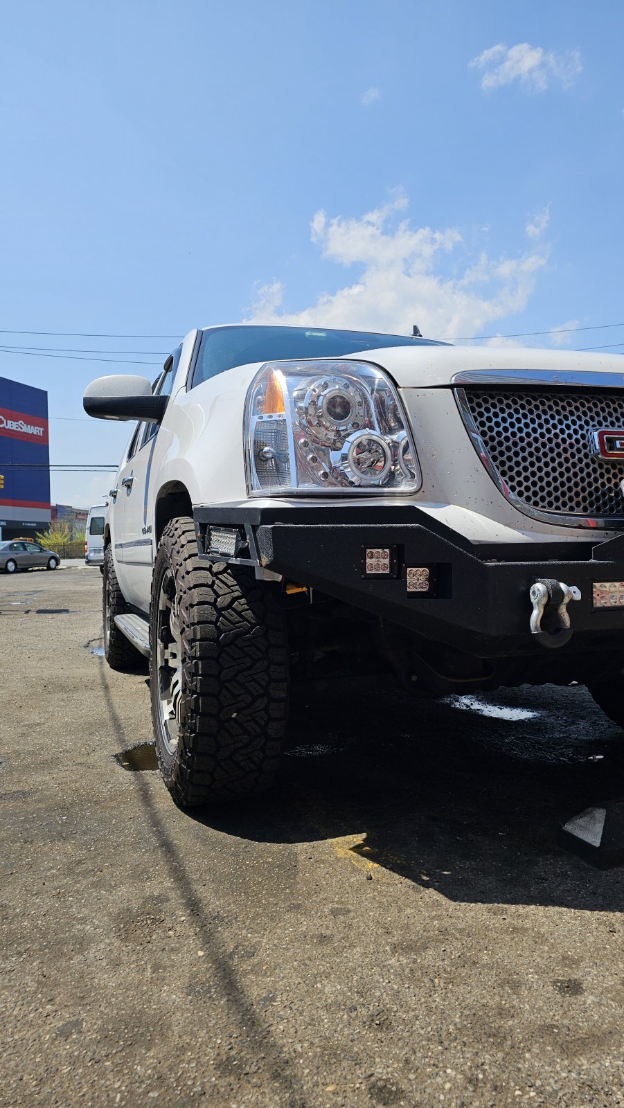

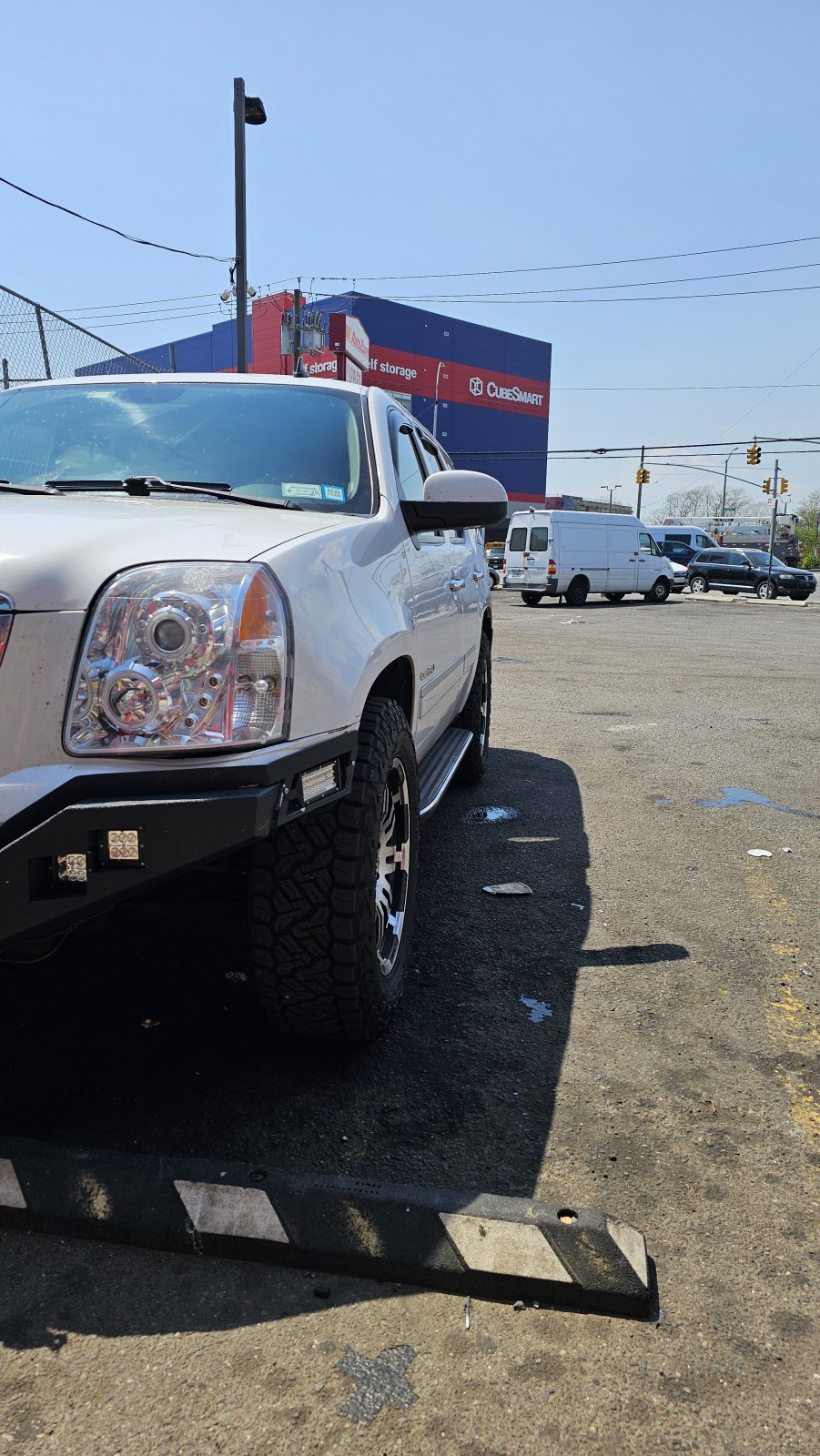

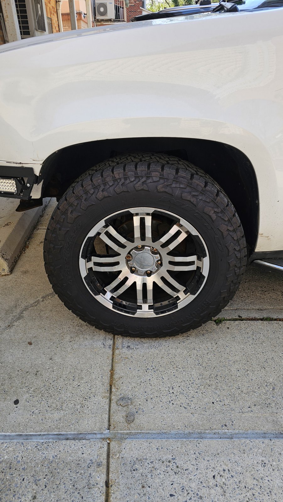

I was having similar issues on 2011 yukon denali so I change both front hubs since I put these huge 34 inch wheels on the truck. Looks good. What you guys think
