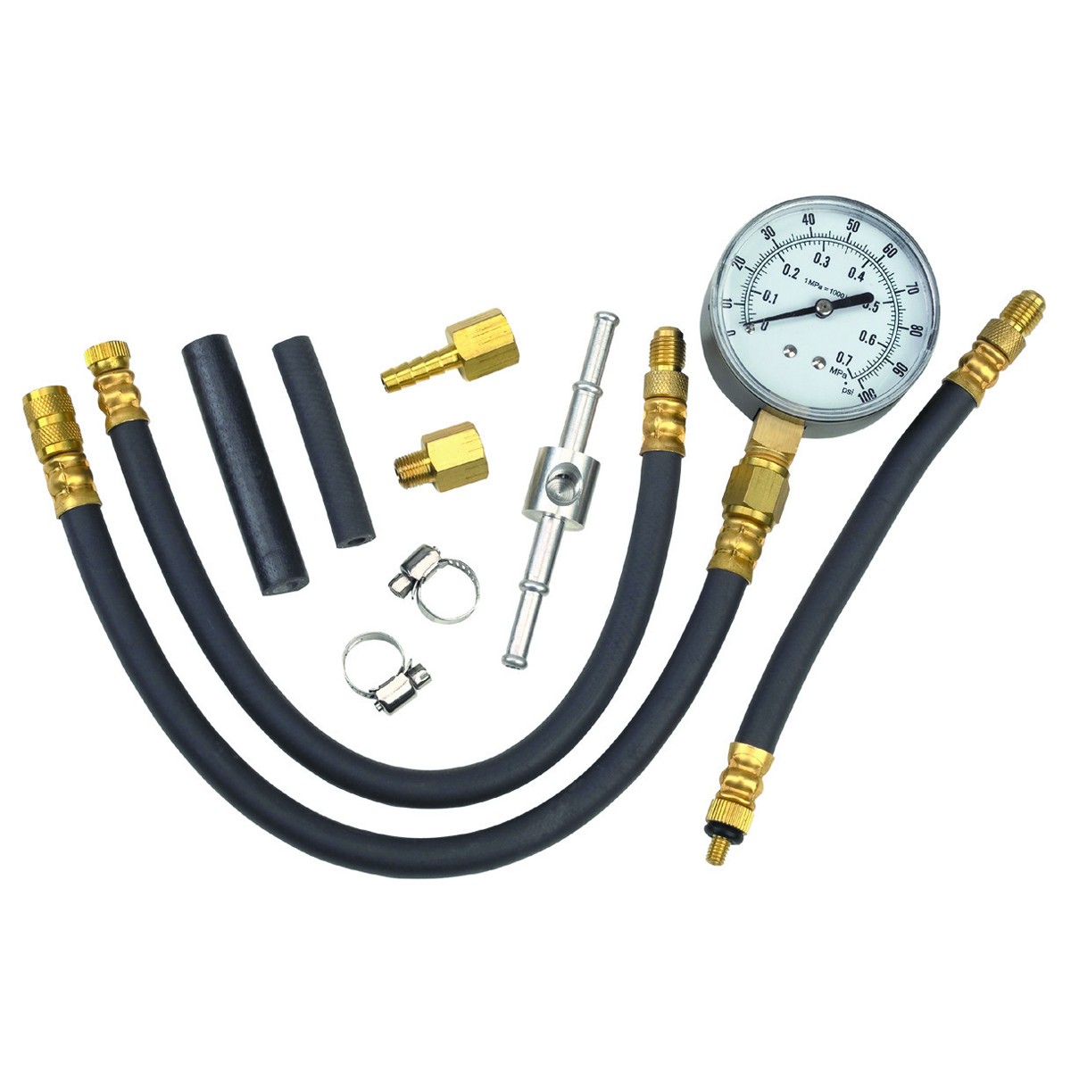

Thanks raiderron! I'll have to go buy a pressure tester. Looks like Harbor Freight has one that works fine for $20 with some teflon tape.

Hopefully the hose on the gauge will be long enough for you to tape it to the windshield and you can watch it while driving and monitor the pressure in real time driving. You can get extension hoses for that purpose if needed. That is the best because all you can do with the hood up is monitor the pressure at start up, at idle, at acceleration and after you shut the engine off you can see if the pressure bleeds off. It shouldn't. May drop 4-5 psi but no more.
Hopefully there is enough hose, looks like I should be able to snake it up between the hood and cowl.
http://www.harborfreight.com/fuel-injection-pump-tester-92699.html

Yea that looks like it is doable. Put the engine thru it's paces while driving. All sorts of driving. That looks like a decent kit for just $20.
