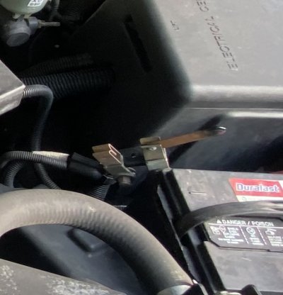

Hey everyone. New member here and I’ve got an interesting issue. Just bought my 01 Yukon Denali xl and I got it pretty cheap because the previous owner said lightning struck some wires near the truck when it was in Florida and now it’s got a draw on the battery and the gauges go crazy. He said he had the cluster sent out and nothing changed. He installed a lever on the ground of the battery so you can easily disconnect it so it doesn’t drain, and I don’t think that helps much. There’s no way it makes that great of a ground connection. Anyone with experience have an idea on where I can start investigating? I have a huge list of stuff I want to do to this but I have to get this taken care of first so I can at least get it inspected. Haha.

Simple test I learned was to just use a regular 12v bulb and put 2 wire leads on it + and - Make sure the key is out of the ignition and just start pulling fuses 1 by 1 and stick the leads from the bulb in place of the fuse. If the bulb lights up then that circuit could lead you to your parasitic draw.
Obviously a multimeter would work better but last time I had this issue. I didn’t have any tools and a bulb was what I used.

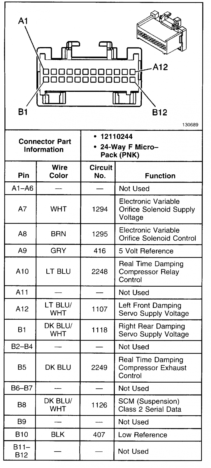

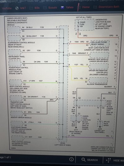

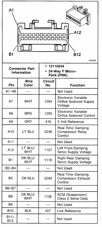

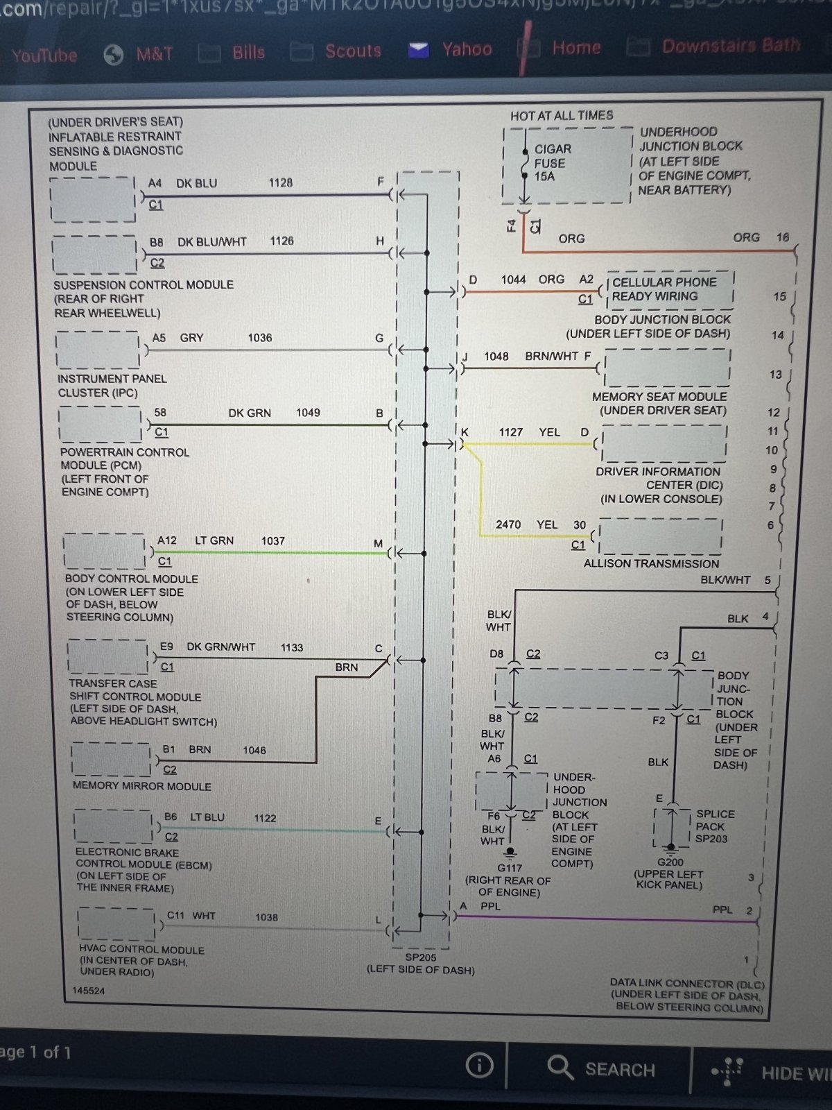

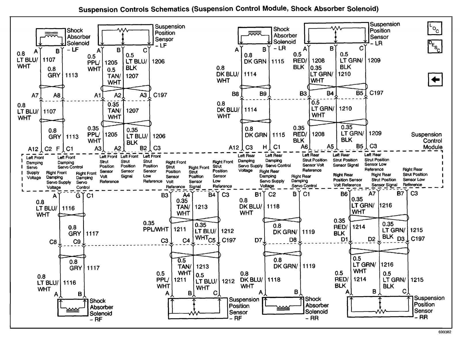

An update for anyone interested. I broke down and paid the money for a month of alldata. I used all the wiring diagrams to find the data line splice pack. Unplugged the splice pack with my scan tool hooked up and saw all the modules do offline. I jumped the purple obd wire to each communication wire 1 at a time and found that the SCM or suspension control module was the one that made everything go haywire when I brought it back online. Got the plug diagram for that module and checked the communication wire right at the plug and found that everything before the module is fine. And with the module unplugged all the issues went away, except the air ride didn’t work. So until I feel like throwing 1000 dollars at a new scm, I pinned the communication wire out of the plug so I still have air ride and don’t have the electrical issues. Only downside is that I can’t communicate with the chassis system so I hope I don’t end up with an ABS code down the line that I have to read. Haha. But yea, dealer wants 700 for a new module and 350 to program. So that’s a pass for me. I’m attaching the wiring diagrams I used in case anyone else needs them in the future.
