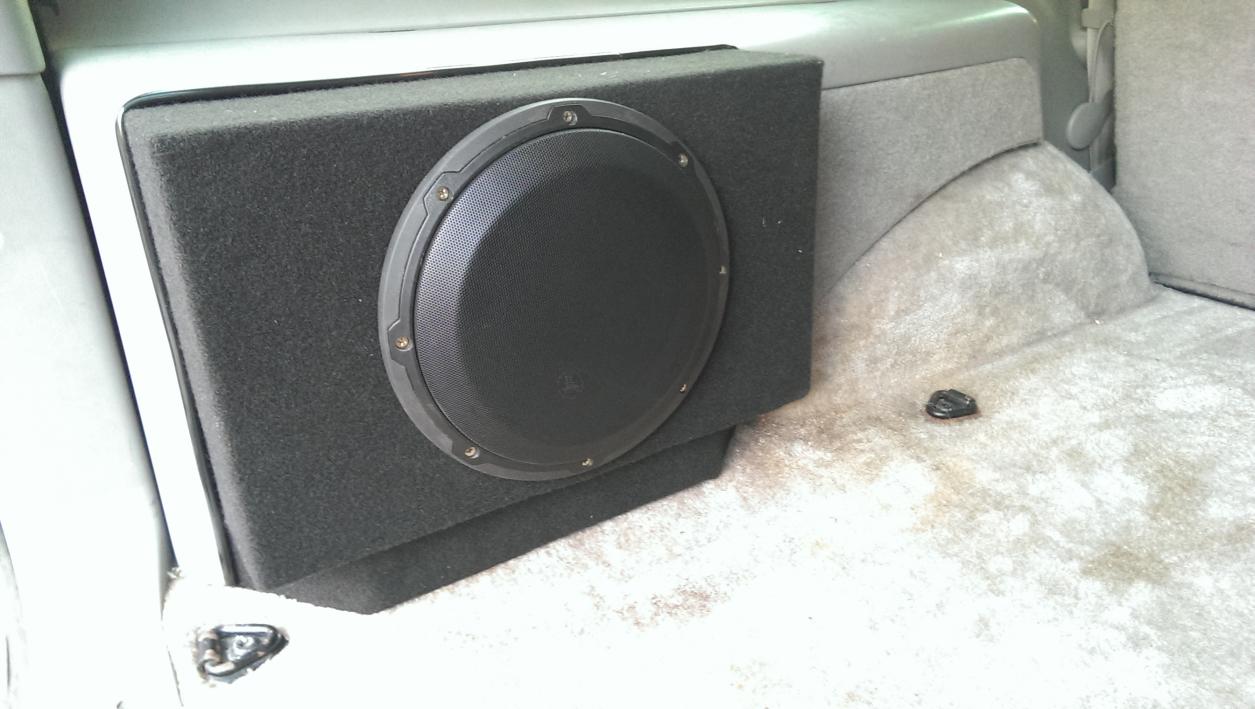

After I wasn't happy with the sound of the first enclosure I wanted to see what the sound would be under optimal circumstances so I made that second enclosure to the exact specs on jl's website for that sub. It sounded so good I just made it fit nice in the corner
I like your designs too, I look forward to seeing it once they are completed

Hey 83 bimmer... with ur 1st mdf enclosure do u think a 11in sub would work..? As far as air space and watever else subs need to b loud subs...
83 Bimmer
83 Bimmer
Jun 22, 2013
149
11
physically I could have fit a 12 in there, as far as proper cubic ft go you'll never really know how anything is going to sound until you try it.
The first enclosure sounded pretty good but I knew I could get more out of that sub, that's why I decided to change everything around.
Most important thing is to make sure the enclosure is sealed up good, no unintended air leaks

I would try to avoid building.one of these on each side in a dual setup. The distance between the two woofers woyld cause some cancellation and it wouldnt sound as good

Changed it yet again...JL 13W3 with JL500/1, makes my eyeballs shake
