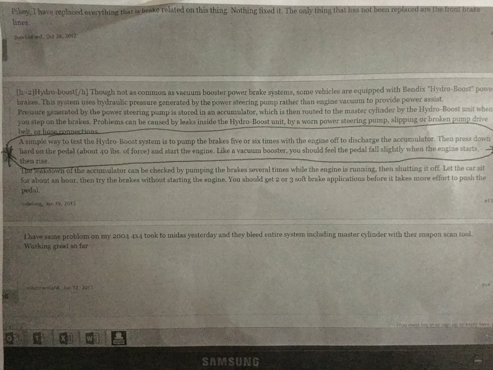

When I press the brake pedal nothing happens for the first 2 inches of travel. After that the car stops fine. It has a new brake pads and rotors, so I know that’s not the issue. It does have hydro-boost. The brake lines have never been open so I can’t imagine that I would have air in the system. Brake lines all look fine and they’re not leaking.
I tried the procedure in the attached picture of pumping the brakes 5 to 6 times, and then pressing down on the brake pedal and starting the engine. When I start the engine the brake pedal doesn’t fall slightly, but it kicks back on my foot.
Any input is greatly appreciated.
