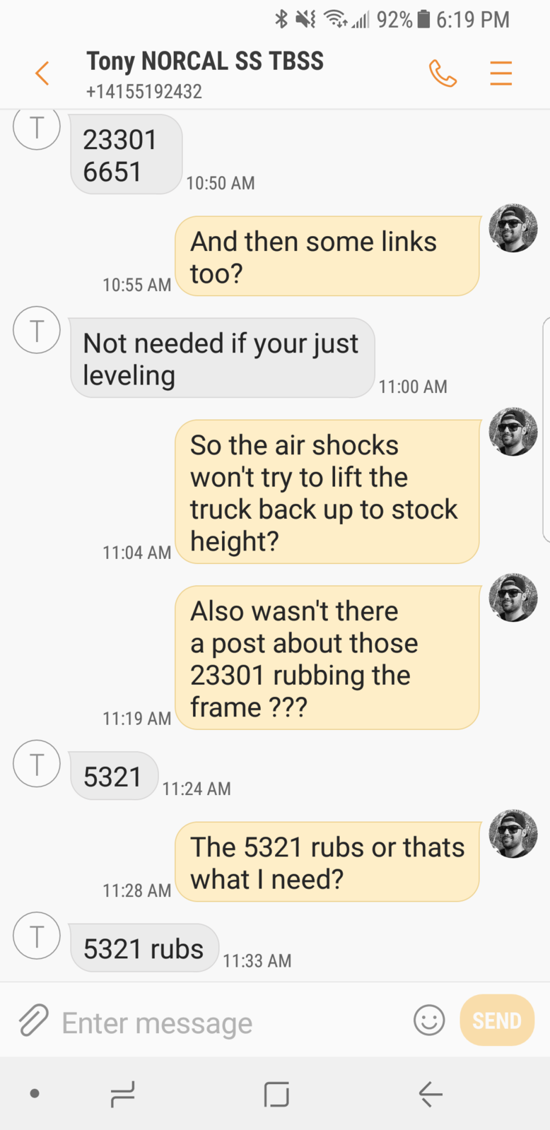

I've been talking with Tony from NorcalSS, he recommends the Belltech 23301 spring kit with shock relocators and I wouldn't need to mess with the air ride links.
Anyone have a similar set-up and what was your before and after measurements?

He said I don't need the Auto ride links.

I though the 5321 were the ones that didn't rub as well. Thought the 23301 sagged too much and rode rough. Now I am confused too.
