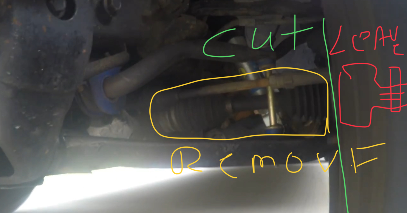

I was thinking of getting 2 used CV axles and cutting the shaft down so only the spine was left this would effectively disconnect the front wheels from the differential! Until I can replace it see the photo of what I was thinking of doing this should not affect the suspension negatively just won’t have 4WD, I will have to remove the boot from the spline side of the axle and remove the shaft and bearings so there’s nothing left except a solid piece with the spline to hold the hub together.
I know this is a bandaid but I just dumped over $4000.00 into it and the $$$ are a little thin right now I thought it would have been something I replaced already the 3 garages I took it to kept saying the hubs or the CV joints even after I replaced them now that I have actual video and audio from under it while driving there’s no other explanation for it! How bad the Differential is? iDK? Maybe something easy to fix I did put almost 10000 miles on it with this problem and nothing has blown up or fell apart? This is one of those oddball issues! I’m thinking the previous owner ran it in 4H on dry pavement and messed up the front Diff
Careful, now...
http://www.tahoeyukonforum.com/threads/psa-cheap-hub-assemblies.101520/#post-1217904
You effectively want to isolate the front wheels @ the hub per this project?

I read that the latest Timkin hubs are for both 2WD and 4WD operation so that one does need the shaft to secure the bearing.
There's an extensive write up on it here for the GMT800s:
http://www.tahoeyukonforum.com/threads/yukon-down-awd-delete-headers-converter-etc.81191/
@01ssreda4
That’s what I’m thinking but I’m just afraid it may not be true I don’t want a wheel flying off because the hub fell apart! I have 2 unused hubs and looked at them closely they are pretty solid but without definitive proof they don’t need the support of the spline, I know the shaft is supposed to be torqued at 150lb that’s a lot for something that’s not holding the hub together.
Not to bust your balls here, but you show a great lack of understanding of how bearing assemblies (specifically tapered rollers) work. When a fastener holds a bearing assembly together, torque of the fastener is irrelevant. The force of the fastener as related to bearing drag is ALL that matters. Not sure if you ever did the old school brakes where the bearings were in the rotor and had to be greased? Same as most trailer bearings. By knowing the spec is 150ft/pds, you can GUARANTEE the fastener is NOT holding the bearings together. Not only that, in my thread linked above, I prove it doesnt hold it together by showing you it clamps the same metal in the front as it does in the rear, its a solid piece. The bearings are the only thing holding the bearings together, they are engineered that way. Also, this is common. I own a Durango that has 4wd hubs STOCK, and its 2wd. 165k miles and no failure to date!
