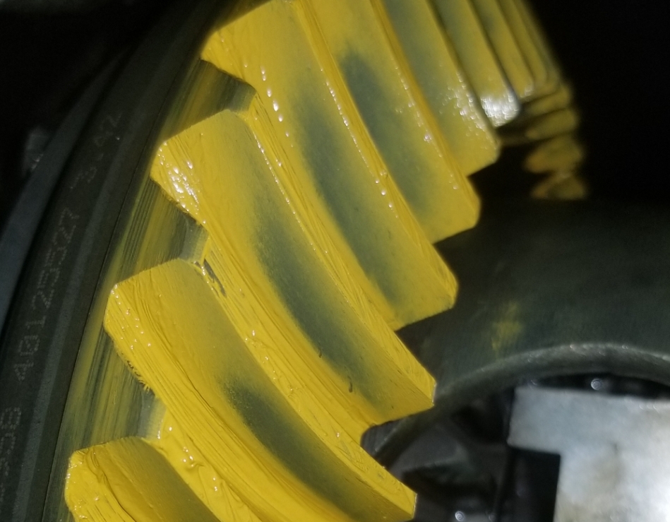

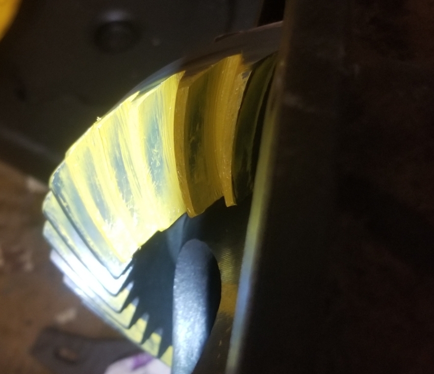

After many trial and errors, I feel this is the best pattern I will end up with given the shims on hand.
Backlash is right around .006, give or take a needle width.

That should run nice and quiet, and last a long time. Nice work, sir.
I did a similar job in April of '22 on our Land Rover LR2. They're infamous for eating pinion bearings on the rear diff, so it's considered normal maintenance. This one had a nice growl to it loud enough that the factory Alpine stereo could no longer drown it out.

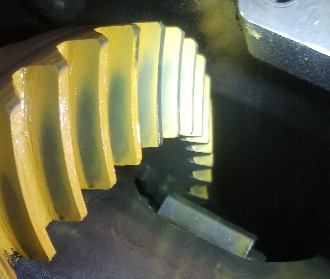

The 23 felt tight so I went back and used the spare crush sleeve and I carefully approached my final torque of 18 inch pounds.
I preloaded the carrier bearings and ended up with .007" backlash, and a final rotating torque of 24-25 inch pounds. This puts me at right around 21-23 inch pounds for the carrier alone.
Ended up with a slightly better pattern as well, drive and coast are more aligned, drive moved off the toe just slightly but still biased to the toe which is good.
