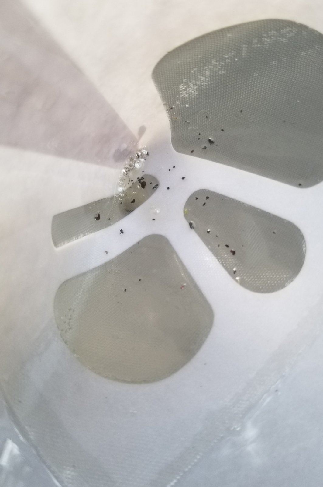

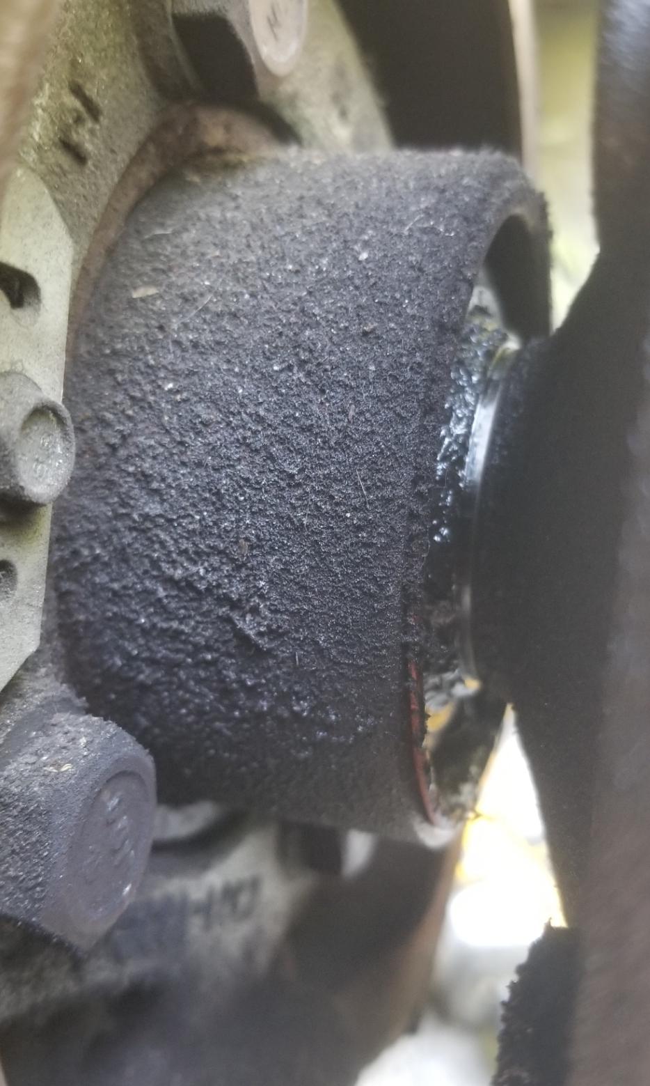

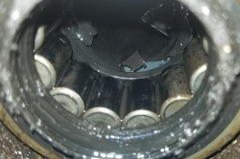

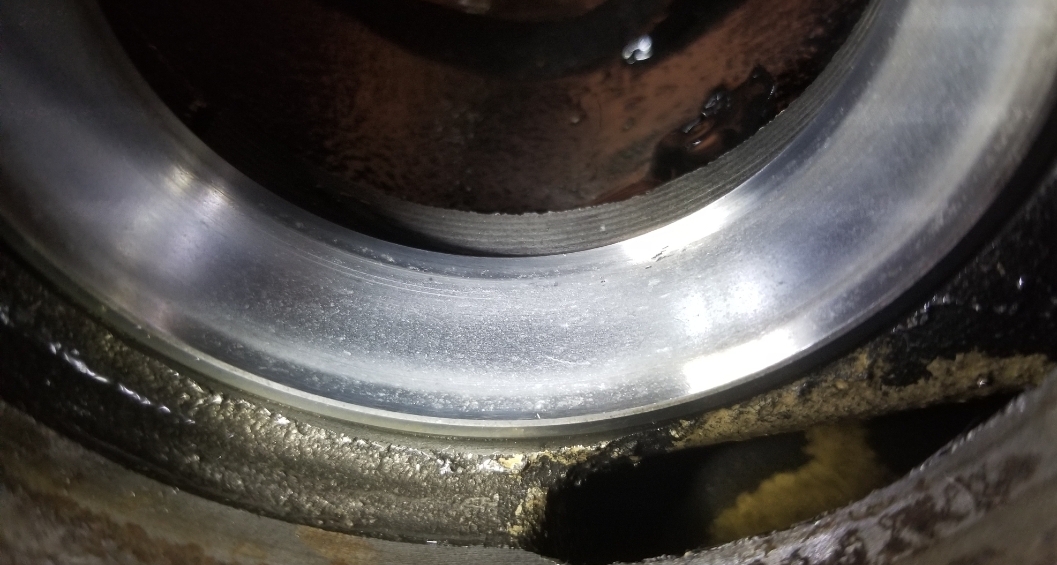

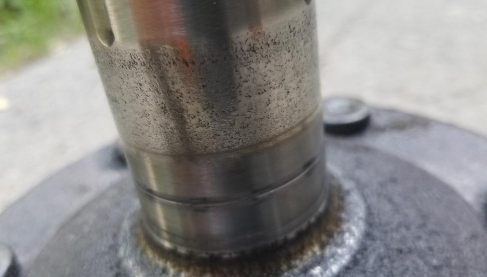

Sorry for the late update but here's what I have found. I removed the brake rotor and saw the seal was wet, so I pulled both axle shafts and the RH had nociceable pitting on the shaft, as well as small very fine pieces of metal laying between the bearing and seal. There was about .030" of vertical movement of the axle, maybe a little more. The LH axle looks good but has some verttical movement as well but only about .010 but still alot.

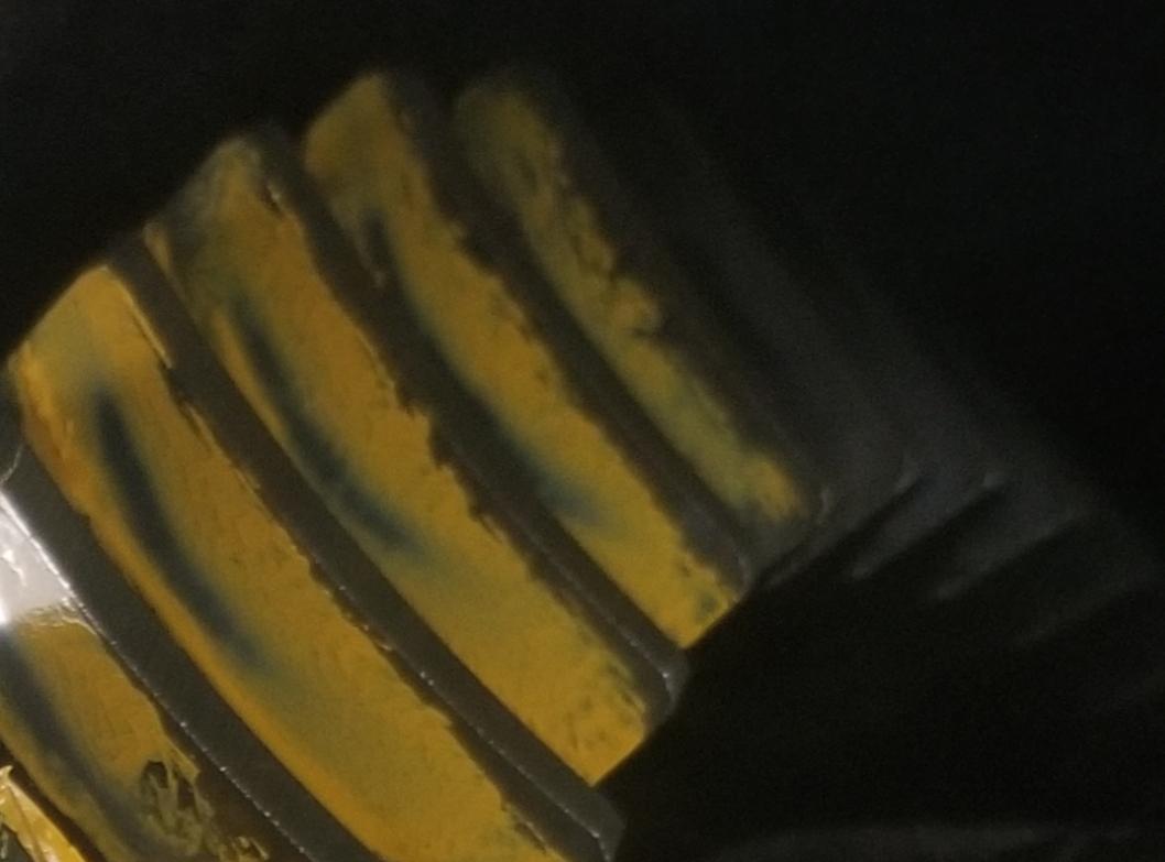

The backlash is .010, which is a bit more than I hoped but right at the limit, mesh pattern looks like it may have a slight bias towards the heel, could be from the pinion seal replacement or could be what was there from the factory, that part I won't know. Coast side did look good.
There were no shavings further down the RH axle tube, none in the pumpkin and none in the LH tube and barely anything on the magnet...so I think I caught this early enough. Safe bet that would cause a fair amount of noise.
I have two new axles/bearings to go back in, I also saw a good bit of tearing on the ABS tone ring where it grips the axle so I will replace both of those as well, which is proving to be a chore finding the right tool to install them, but another story.
