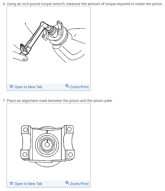

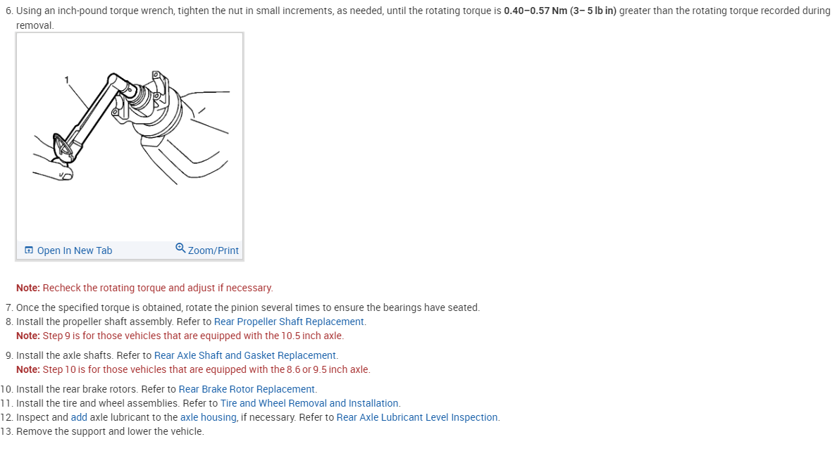

Before taking it apart:
Before putting it back together:
Remember that there is a crush washer in there to keep tension on the pinion and once the nut has been loosened, the tension is lost so we must tighten it just a little more next with a NEW pinion nut. The shop manuals always show this being done manually but youtube shows most people using an impact gun.
Thanks for that.
For the 8.6", does this rotational torque include the axles or with them pulled? Or just the calipers removed?
