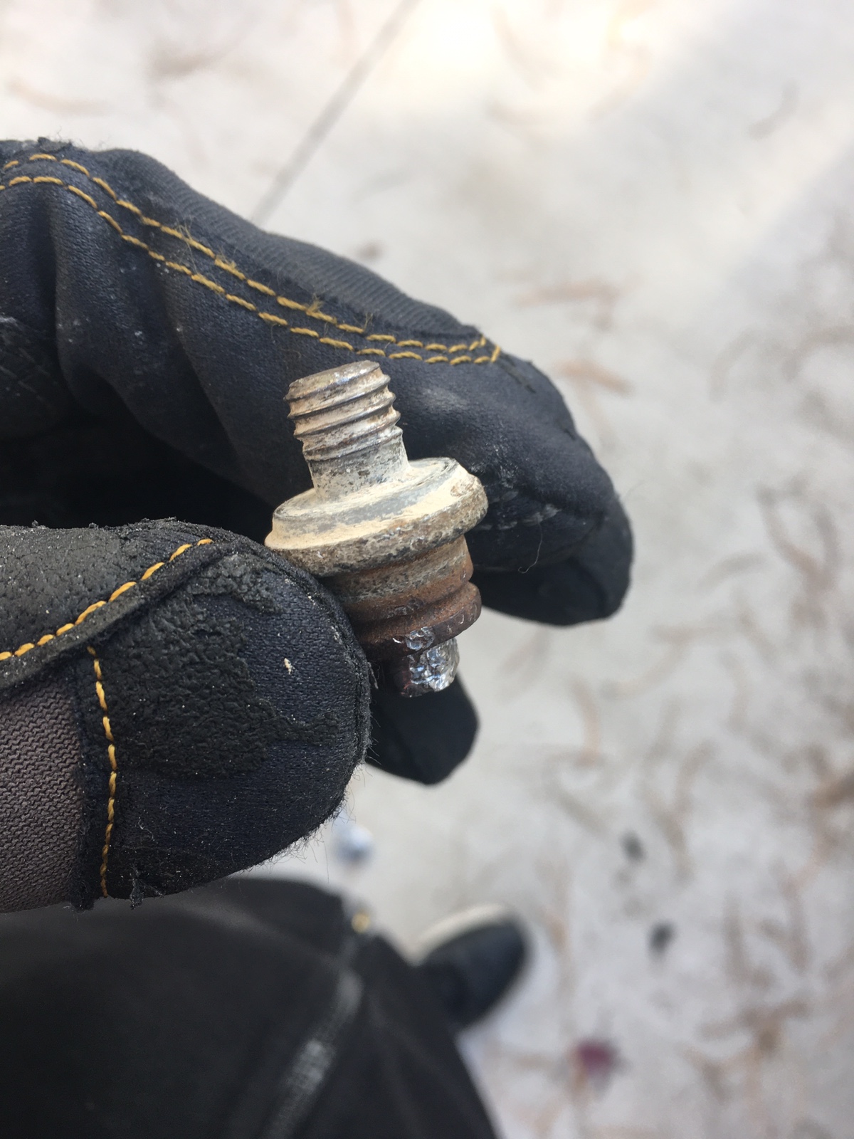

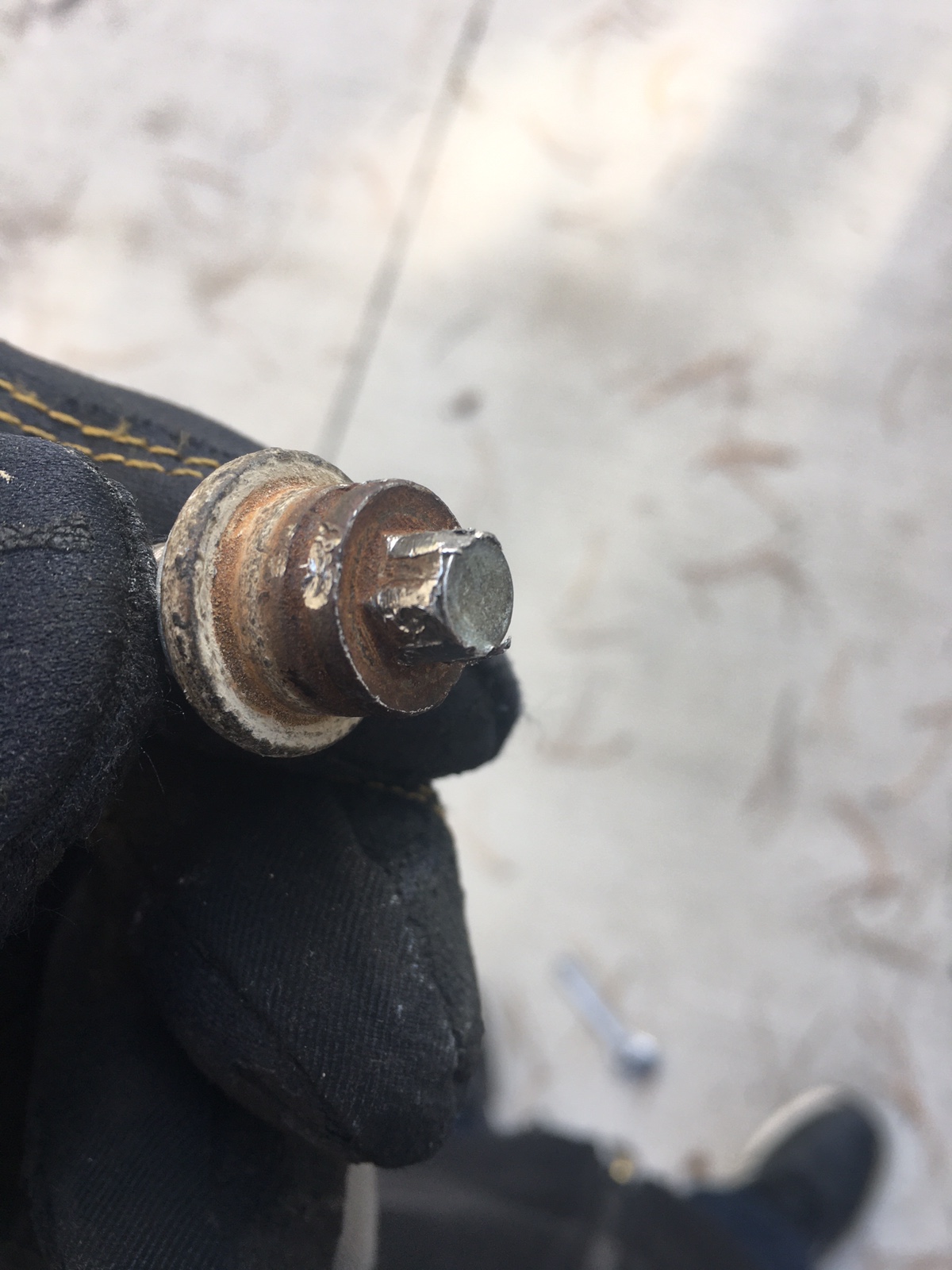

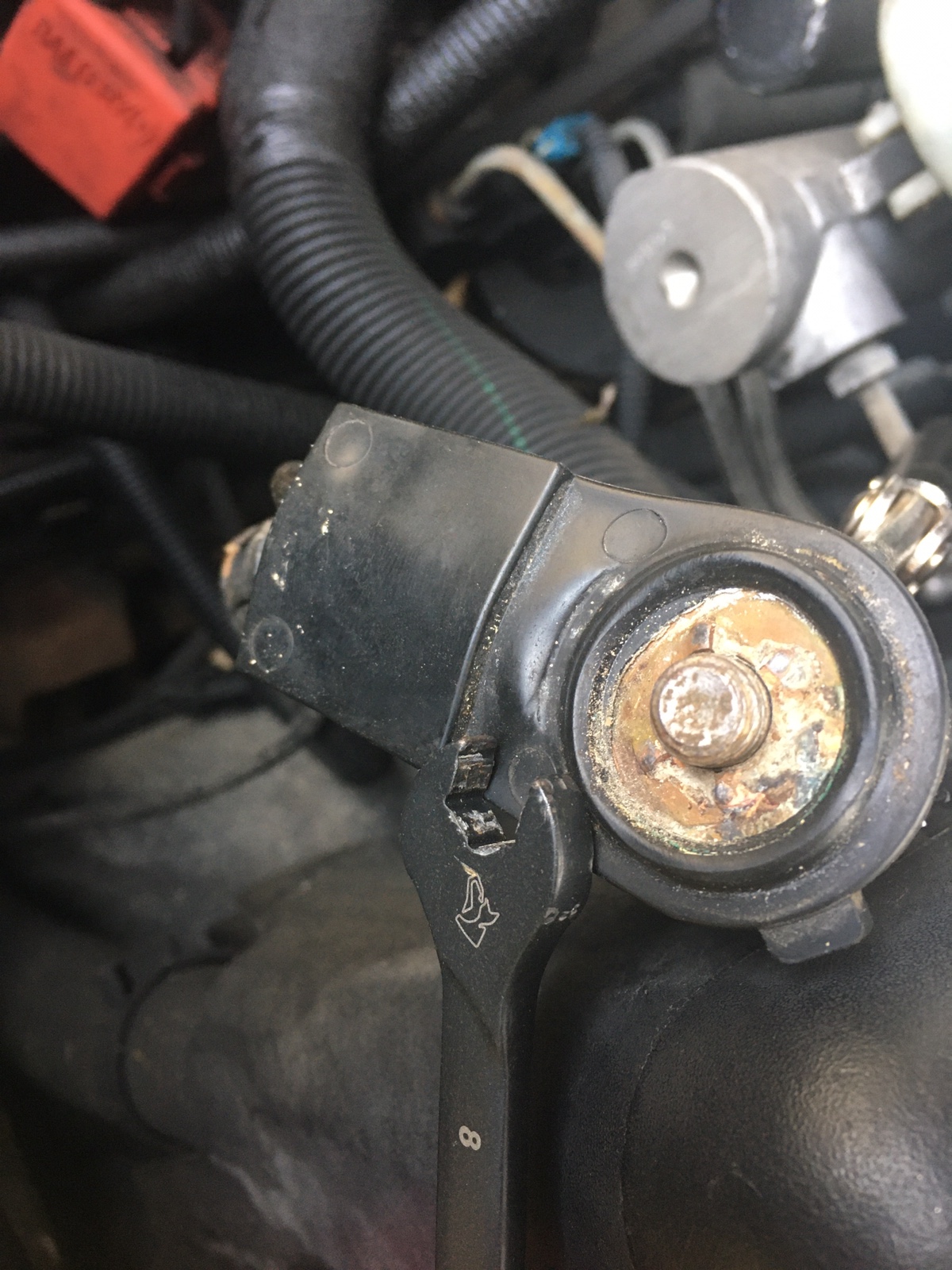

Well guys, you can officially call me a *******. So I charged up the battery fully. My plan was to go unhook the negative cable but as soon as I had opened the door to pop my hood my alarm went off and this was 12:30 am. I panicked because of the noise and tried to unhook the negative but I didn’t think about how the battery basically sits in the tray backwards so I’m thinking righty righty from the front of the hood and I tried hurrying up and doing it so I can disconnect it and turn the alarm off but I stripped the bolt. Finally alarm stops and I just quit till the next day. I guess there was some corrosion around the bolt and inner cable.

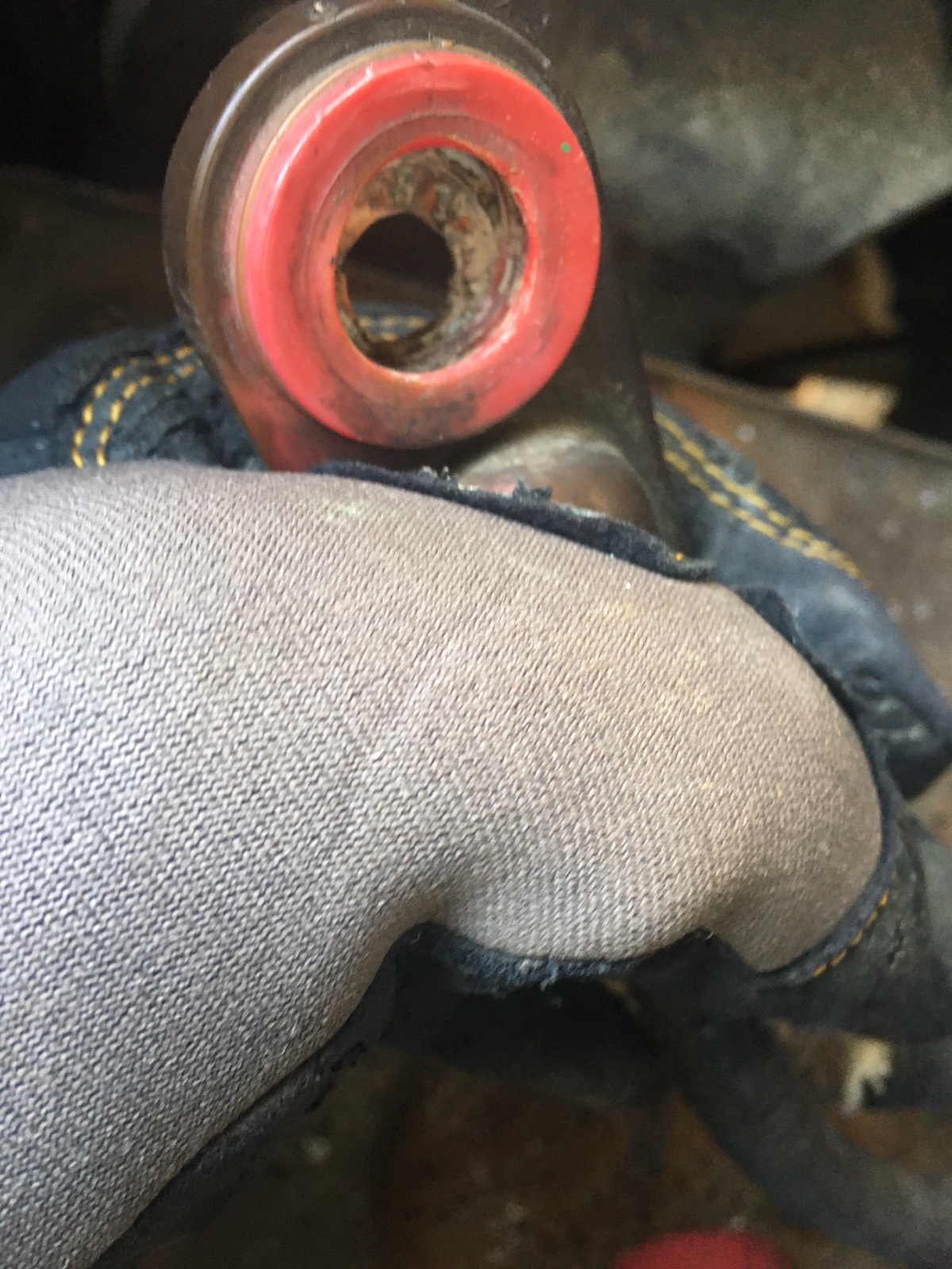

I got the cable bolts out and bought new ones. Again short on time and rushing to get the new bolts through the cable rubber housing seams impossible as the ring around the bolt is larger than the rubber housing. The guy at the parts store told me to heat it up with a blow dryer and see if I can get it in that way but seams impossible. Again I was short on time. I watched a video of a guy do it fairly easy using Vaseline to live it up and a small picker to work around the rubber housing. Any tips on how to get the bolt through?

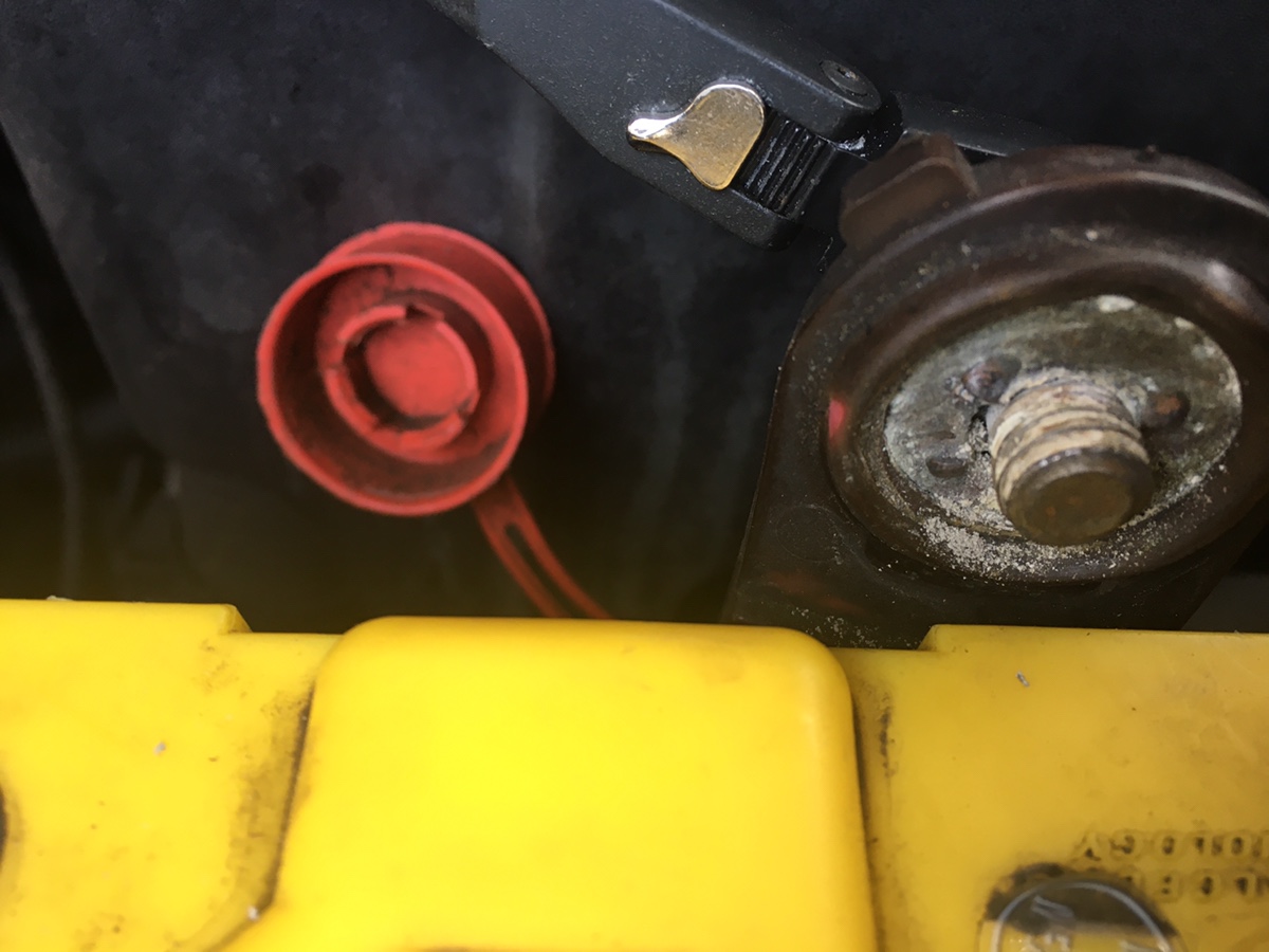

So finally had time to get to the truck. I had fully charged the battery while I had it out the truck.
I replaced the battery cable bolts with the new ones. Hooked up the battery and everything started normal. Alarm went off but I was able to disable with the key fob.
Showed driver 2 in the dic and no more mysterious “unknown driver”
Also I cleaned up the cables.
Not sure what is causing my battery to drain like this and make my voltage drop. Maybe the alarm system or just corrosion connection issue

It may be more of a failure to charge fully because of the corrosion and crud at the battery cable ends. I would get some new cables and install and make sure the other ends are attached securely with all crud/corrosion cleaned off. By the way, the battery cable bolt is designed with the shoulder so that they stay in the end, instead of falling out, when you disconnect them. I lived in cold weather before and just applied a small amount of grease on the shoulder of bolt or edge of rubber cable end and used a ratchet wrench, 5/16", and while spinning it in I pushed at the same time and it always popped right in, even in below zero weather. Since you did not say I can only assume that the cables are OE and really should have been replaced before. Maintenance work like that in the cold sucks hind *** but so does frustrations in the cold. My dad always said, "Maintenance pays and breakdowns cost".
When all is said and done, check alternator output under load conditions.

all that corrosion is 50% of the problem or more, I would invest in new cables, especially now that we are heading into winter, after you put the new cables on then check your voltage at the battery with the engine running you should have 13v+ if that checks out then you should be good to go. It's going to suck if you go somewhere and get stranded when it's freezing cold and raining and windy in the middle of the night, just saying......been there it sucks. at the very least get a $2 wire brush and scrub the hell out of it then get those little green and red terminal protector pads that help prevent corrosion.
