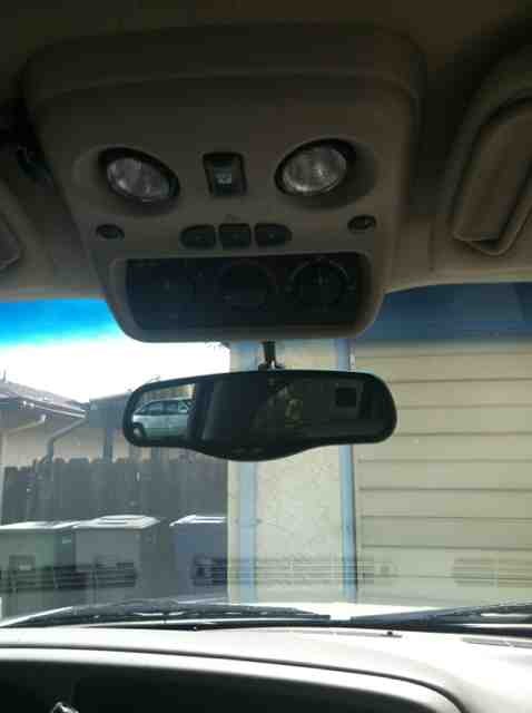

When I got back into my Denali I turn the ac on in the front and it works fine just the rear when I turn my over head control knob on nothing no air or anything but was working ten minutes ago but no air at all now. Are there any fuse or relays? What could be wrong?

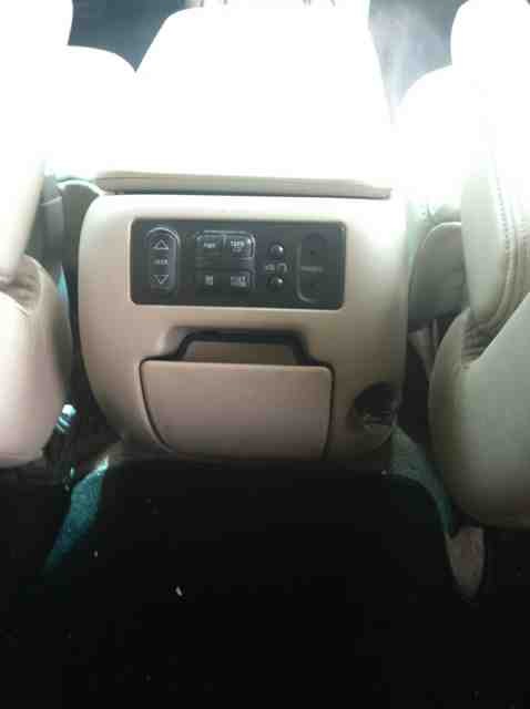

You should have some controls for the rear passengers as well, behind your center console.

Mines an 02 and I only have the controls above my head for the rear is there a fuse for it?

Sorry. Thought the Denali would have the controls also in the rear.

I thought there would be rear controls on the back of the middle console of the front seats. If you have it in manual you can adjust the air heat and everything from behind. Are you 100% sure there is not controls.

Pretty sure all 01-02 where like this when looked at different trucks. 03's and up varied. ImageUploadedByTapatalk1374791197.906441.jpg ImageUploadedByTapatalk1374791214.088341.jpg

Exactly what mine looks like what could it be?

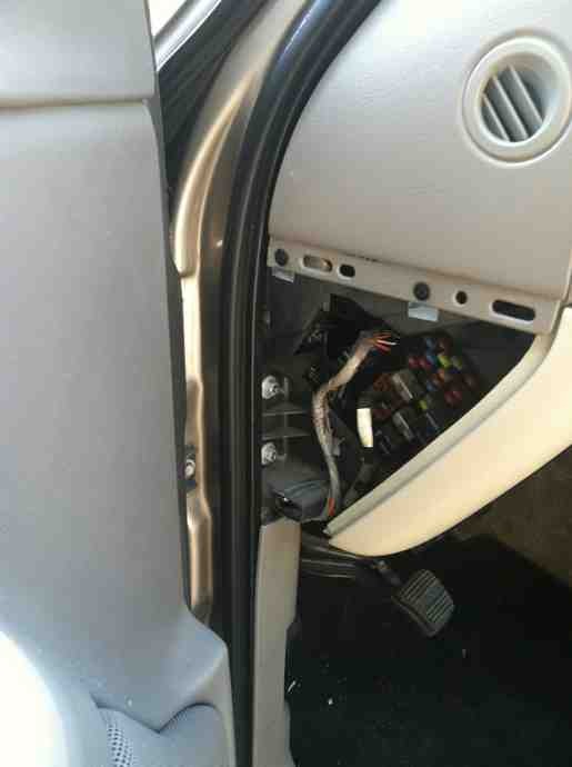

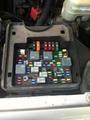

Check the front fuse panel (under the hood) there is a rear hvac fuse that should be the one that would go out if it's a fuse. Not sure why we are blaming actuators or vacuum problems yet when he has not checked the fuse or the controls.

Also all fuses are fine. Already checked those where is the vaccum located
