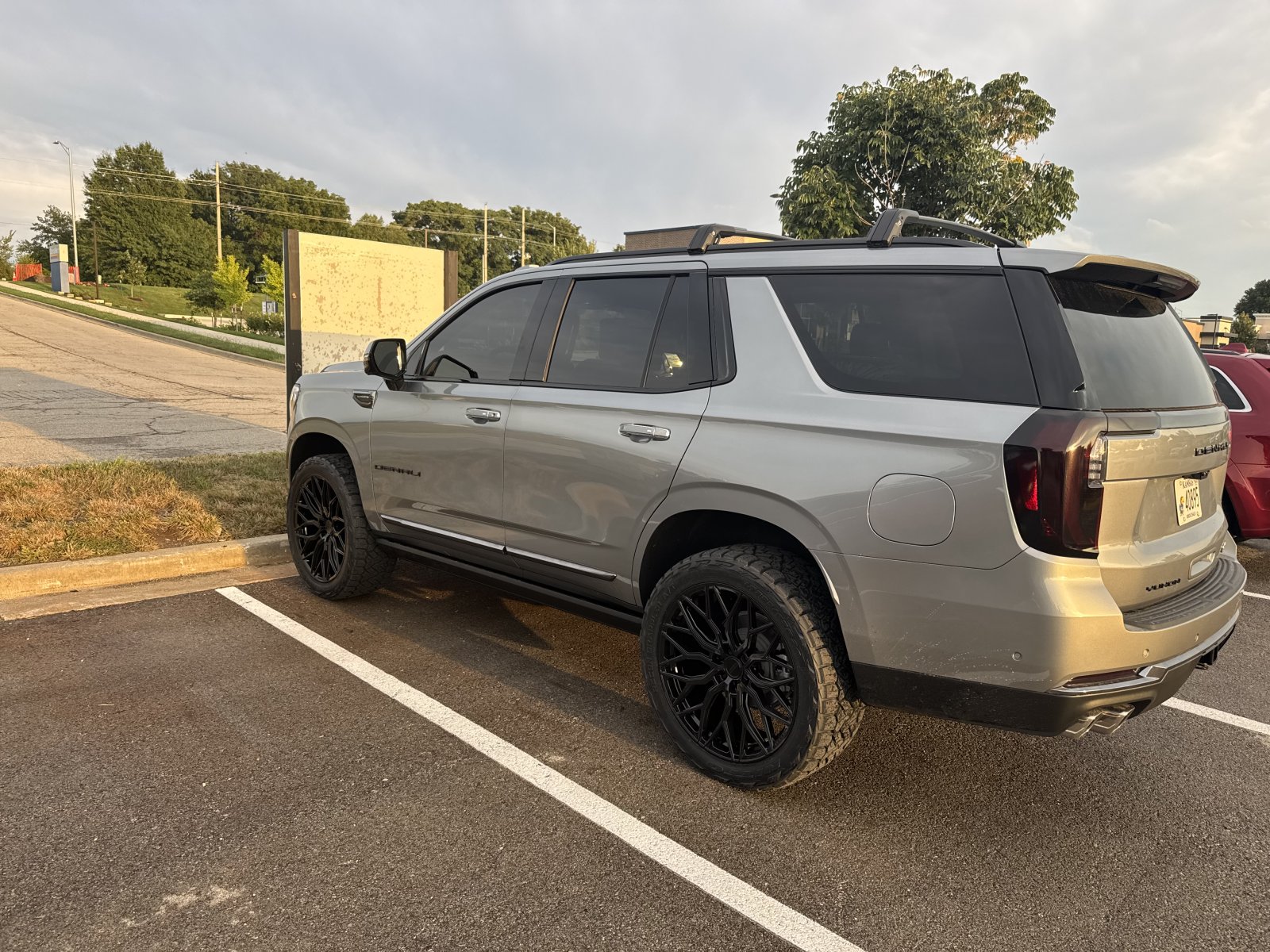

Here’s mine after the swap, pullback and running board adjustments:
