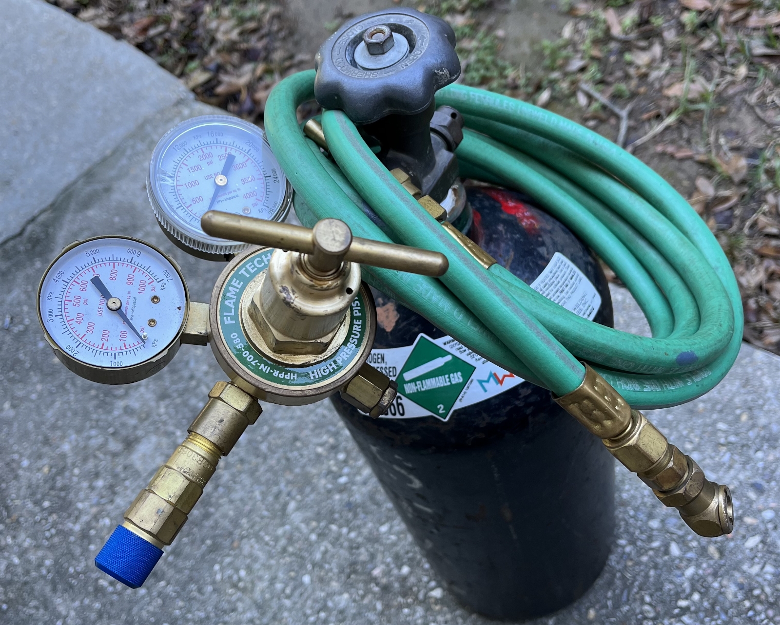

Here’s mine:
Bottom line: any reason NOT to do it? No. But if you’re expecting nitrogen to be some sort elixir that will improve gas mileage tenfold, you will be disappointed.

Here’s mine:
