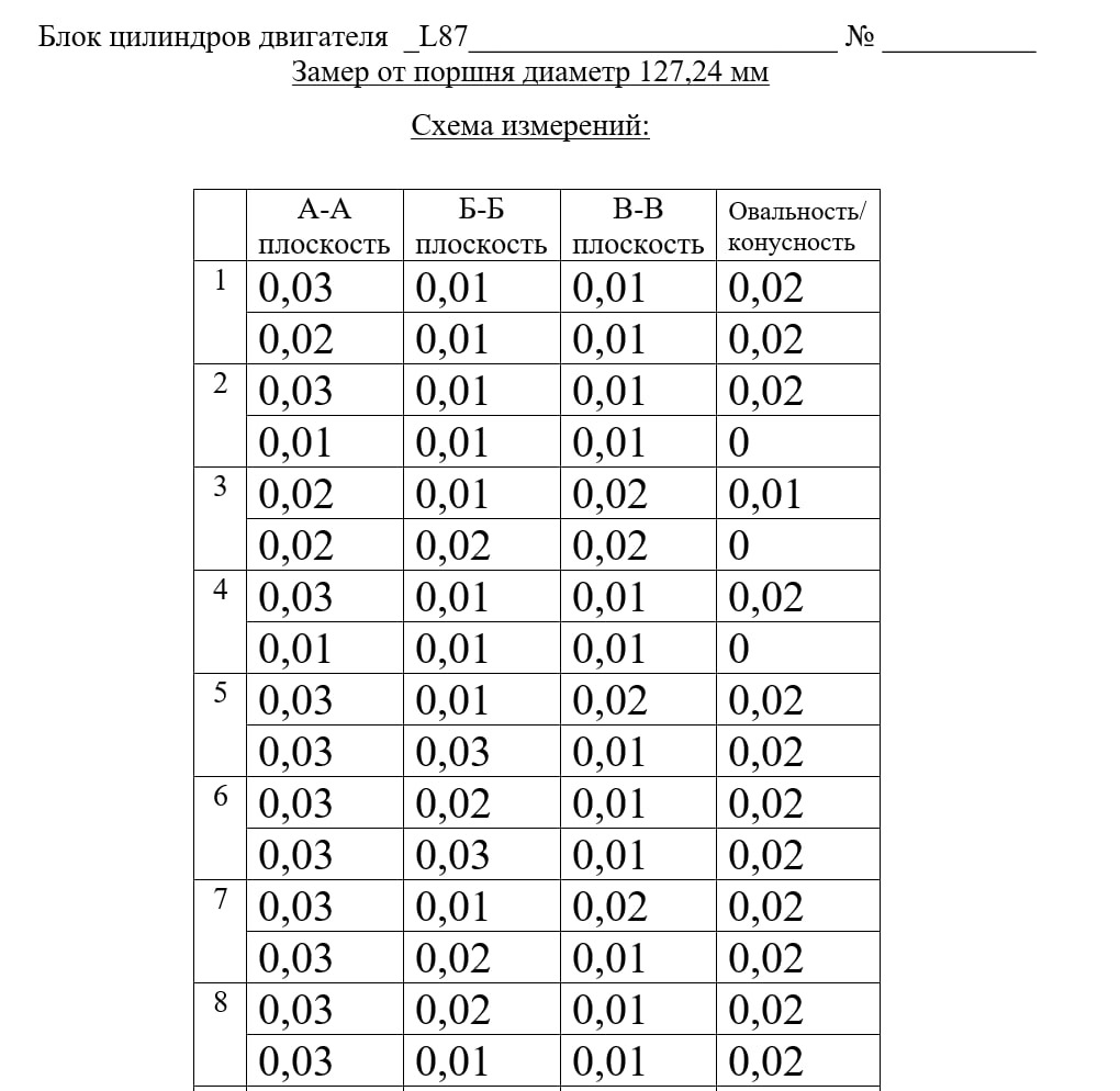

In Russia, unfortunately, the GM warranty does not apply, so engine repairs are done at the expense of the owners. So far, there is an opinion in the services that the cause of breakdowns at low mileage is a violation of clearances. The piston does not move freely in the cylinder. Even having bought a new engine and disassembling it, we measured the gaps, they were lower than those required by the specification. This causes disruption of the crankshaft and destruction of the connecting rod bearings.
Therefore, in Russia, when buying a new engine, servicemen disassemble it and sharpen the hone, increasing the gaps. and then the engine runs without problems.

Our services are divided in opinion, one service believes that the fault of engine breakdowns is the connecting rod liners, another service believes that the smart oil pump is to blame. But the third opinion is closer to me, it is that the clearances in the engine are too small, this just breaks the engine from the inside. Here is a video of the new engine and how the cold piston moves in it, and what will happen when it warms up? And I post photos of engine measurements 6.2 with a mileage of 3000 km. They are in Russian, but with a smart camera and translator it is not difficult to understand what is there))
