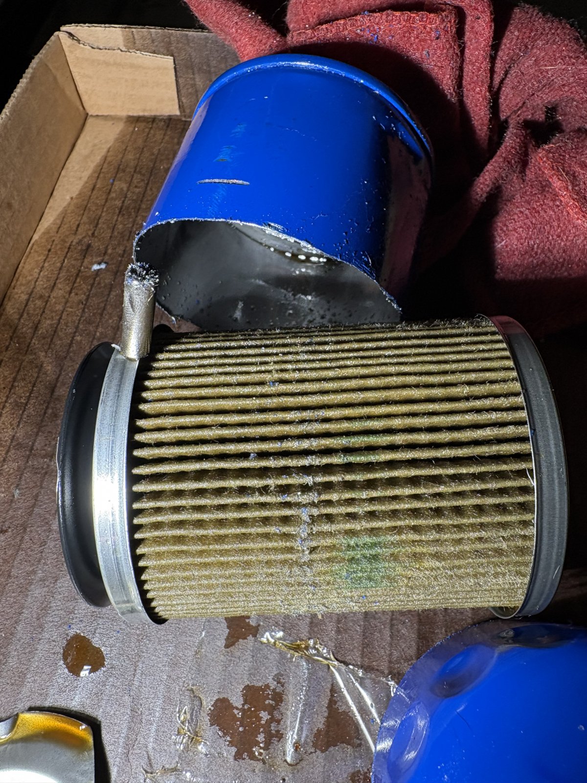

Somewhat off topic, you'd be shocked to see what shows up in the first oil change for any Toyota in the last decade plus. Both a previous 2018 Camry and brand new Grand Highlander we have now were absolutely full of metal when I dumped the oil early. Pretty much every model you'll find that observation (and panic) for those that DIY the first couple of oil changes. It doesn't take long for the components to wear into each other and they're fine for 200K miles on nothing but oil, filters and plugs.
Can confirm.
Tundra, Highlander, and 5 different 5th gen 4Runners… all had large chunks in canister housing.

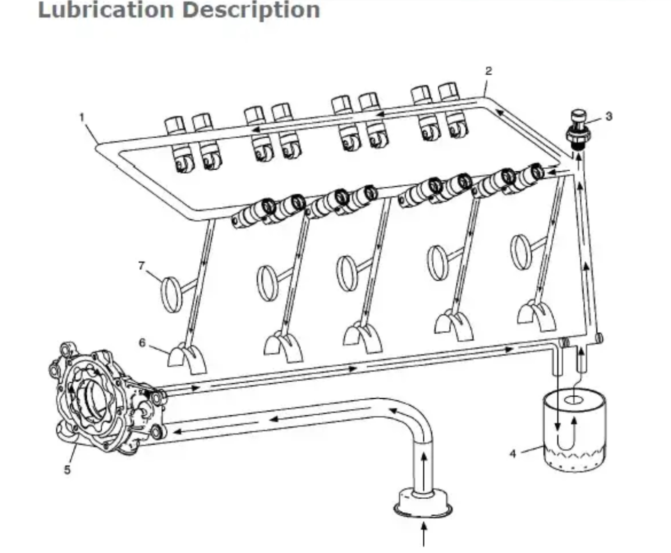

The pressure we see on the dash is after the oil filter… but all the lifters and bearings are after it. It sure does look like the crankshaft front is what get oiled last… the oil pressure there is less than what you see on the dash. I imagine a plugged filter does not help either. It looks to me like a worn cam bearings could easily take oil pressure down enough for trouble in the mains/rods. Not good…
it sure does look like going to a 5w30 makes some sense as you will reduce lost pressure.. due to higher viscosity.. assuming enough oil is left to cool things..
Yup. I made that conclusion after the last oil change. 5W-30 from here on out.

This is what I posted in the Engine and Drivetrain thread with the same title.
"From the diagrams it appears the oil pressure sensor is mounted on the rear of the DFM manifold that is on top of the engine. So in this case the sensor is at the beginning of the oil flow path which is typical of most engines, but with all the DFM gear and the 2 stage oil pump, it would have probably been wiser to have the oil pressure sensor at the end of the oiling path.
This is what happens when you take a basic 60+ year old design and just keep adding bits and pieces on it over the years.
For reference I was able to obtain oil pressure values using a more advanced scan tool.
Approximately 28 PSI warm idle in gear
Approximately 33 PSI warm idle in neutral
Approximately 46 PSI @ 75 MPH at approximately 1600 RPM
The oil pressure did appear to boost past the 1/2 way point on the dash gauge when passing and the RPMs were up. Hopefully I will be able to graph the oil pressure behavior so I can get a better idea how it is controlled."
