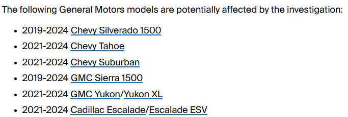

The NHTSA investigation applies to the following:
It's the L87 they are investigating - which as far as I know has only ever been coupled with the 10L80. In the '19-'20 SUVs it was the L86 with the 10L80 and those are not affected by the investigation nor do I believe anyone has ever had a pre-L87 experience low mileage bearing failure.
