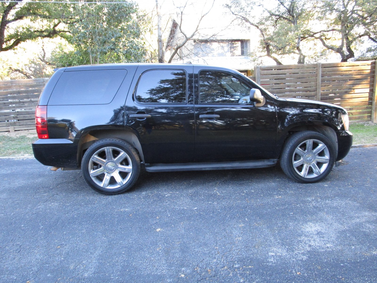

So, bought my 15 y.o. son a retried TX state trooper 2011 Tahoe at the state auction. The interior lights do not work unless you turn the dash "knob" dimmer to "on". Is there some sort of door switch that needs to be installed? Also, lights don't turn on when mashing the unlock button on keyfob. It is missing the overhead console/light fixture, might this be the issue. The 2nd row lights do work.
Anyway, great website. I have scanned through much of it. Thanks for any help.
Truck came with 198k miles, runs and drives great. The tires were flat spotted from sitting on the state lot, probably flat, for who knows how long. I talked the wife into getting her new rims/tires for her escalade and put her 22's on the Tahoe, rides well now. Also did the hood in flat black, previously white. Other than that a little compounding on the paint, and it is good from a far, but far from good. Kid seems to like it. Anyway, seems like a safe ride for the kiddo. Thanks for any help.

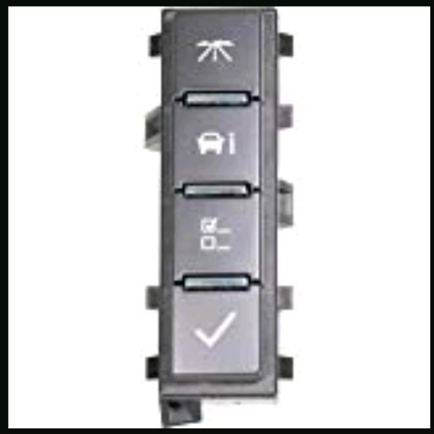

As for the lights not flashing with the key fob... order a DIC (driver information center)switch and install it and see if you can turn that feature on in the DIC in the cluster... if not then it may be programmed into the BCM, some call it "stealth mode".
DIC switch looks like this...
Installs here...
You will either need to cut the hole in your existing panel OR purchase a replacement panel that has the hole already in it.
Can be purchased here...
OEM GM Trucks and SUVs Driver Information Center Buttons Switch Black https://www.amazon.com/dp/B01HC50AYG/ref=cm_sw_r_other_apa_i_yxV-DbWFWERBE
Wiring is already in the dash, it just plugs in.
