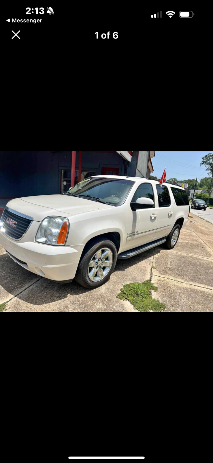

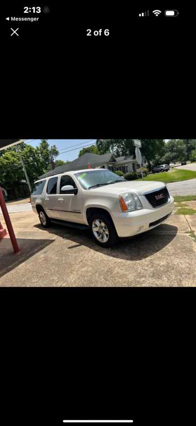

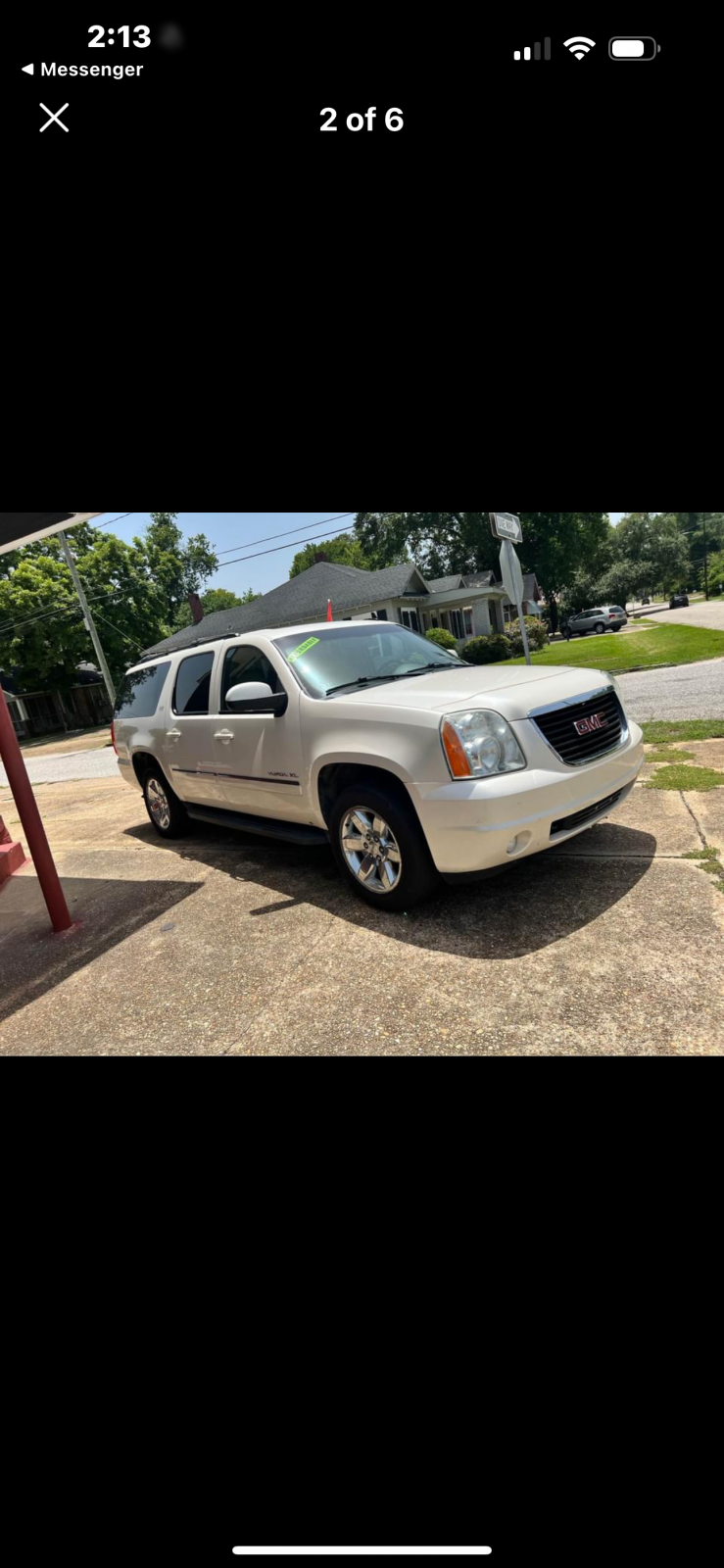

My new to me baby

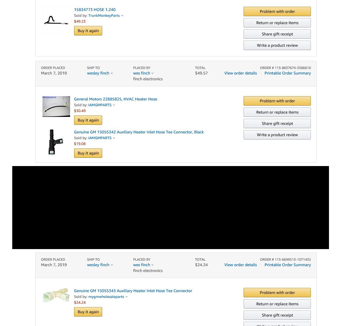

heater hose's & T connectors to firewall. replace with OEM if not done already.
these are the correct part numbers, beware of bait and switch sellers that put the oem number but actually sell a aftermarket
you need 1 of each of the 4 parts
the reason OEM is stressed on this part is because the aftermarket ones will have to be replaced agian in short order, better to just cry once.

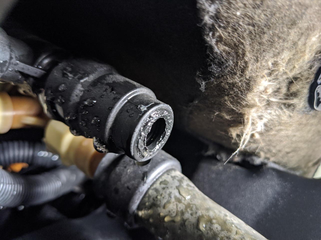

As @Doubeleive recommends, replace the 2 Tees in the heater hose assembly. I will go further and recommend that you replace all radiator and heater hoses in the engine bay while you're at it. If one of these hoses fails, you are stuck wherever your are at the time, and that's never a good position to be in.
