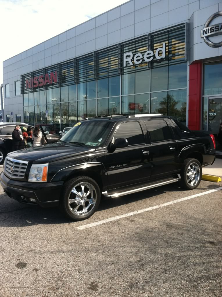

Hey guys, I just bought a 2004 Escalade EXT, 96k miles. Got a good deal on it so I pulled the trigger this afternoon. VERY VERY clean, tan interior, has some aftermarket 22"s on it, which I'm not sure I like yet, but maybe they'll grow on me.

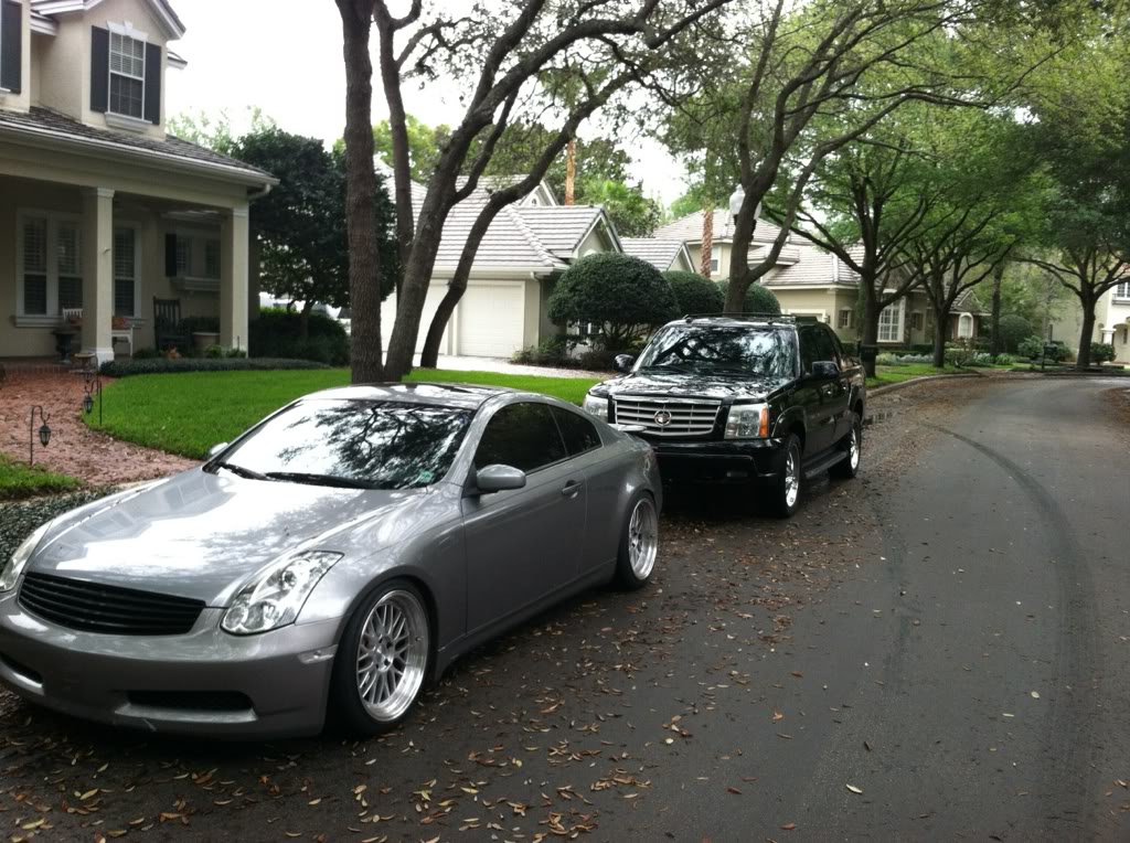

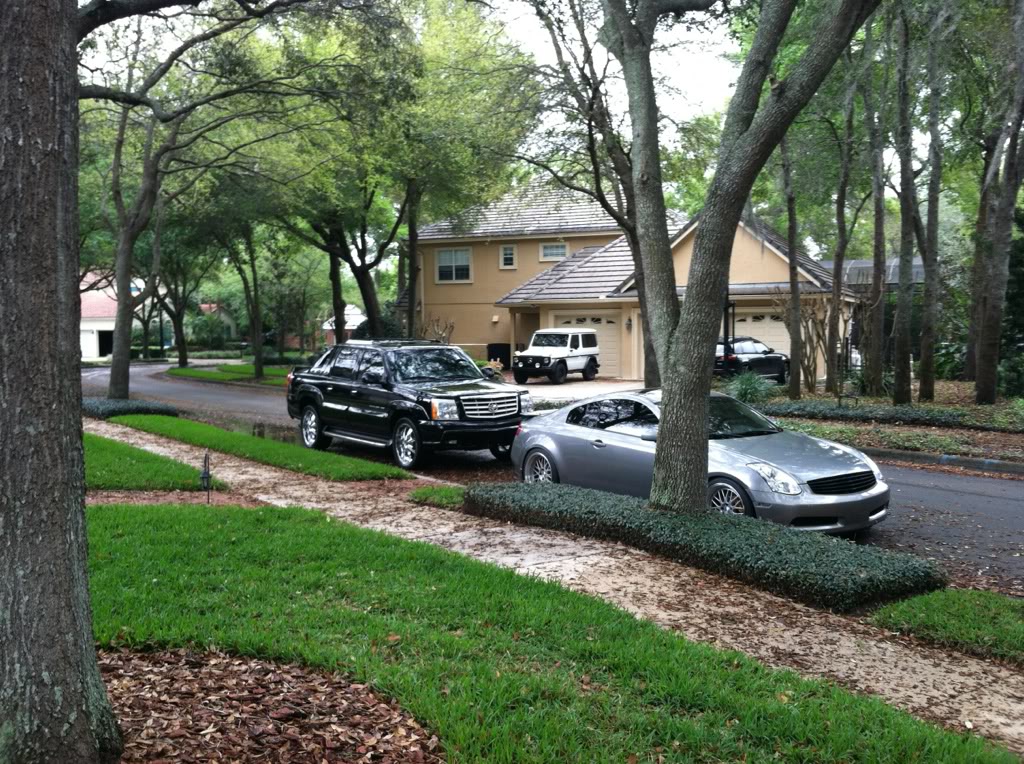

Heres some pics, next to my other baby.
Don't worry, I'm taking that hideous chrome trim off asap.

Nice looking ext! :)

Nice looking EXT man. Infinity looks good too
