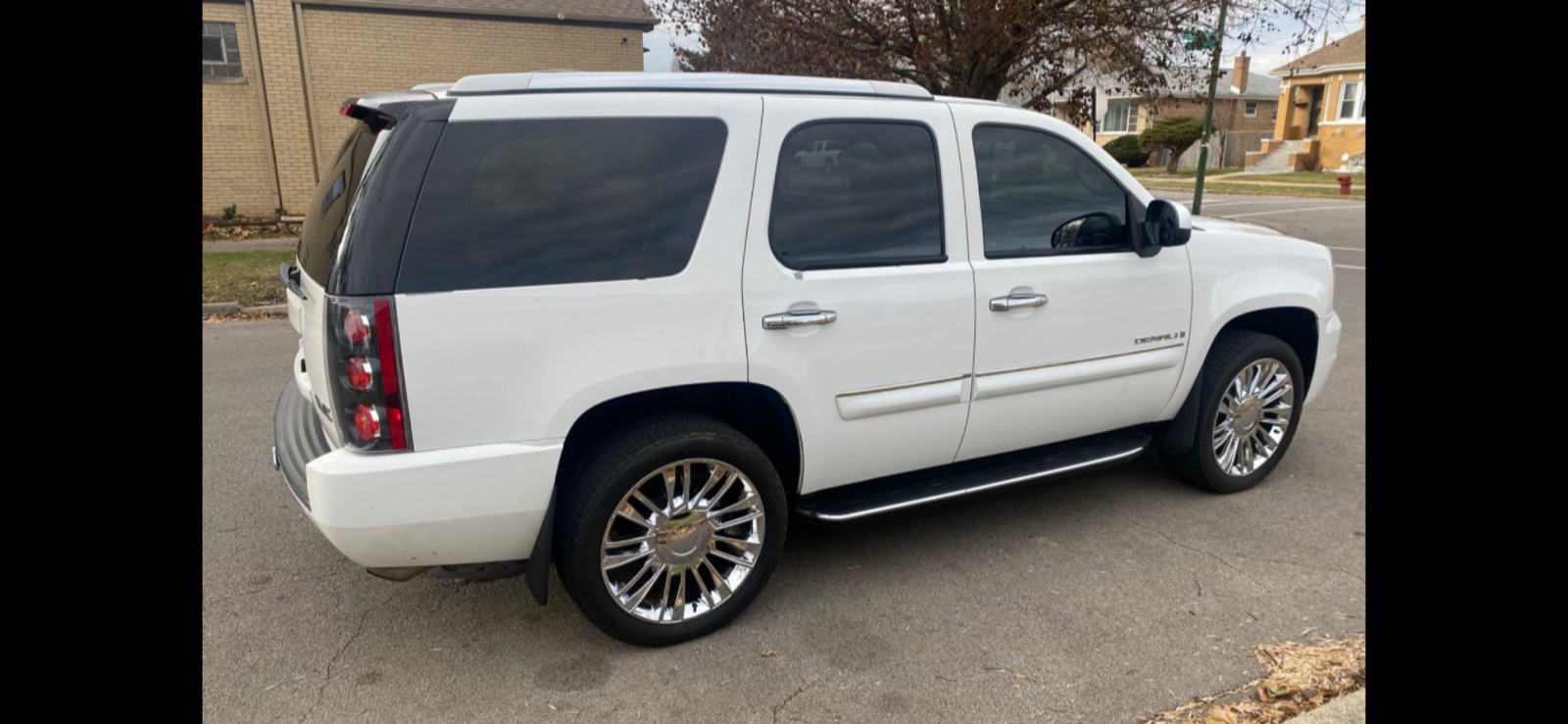

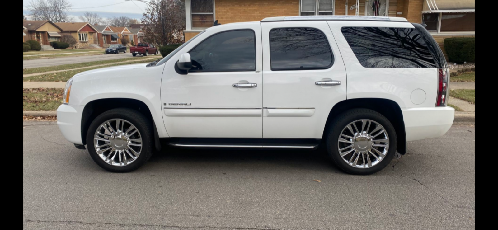

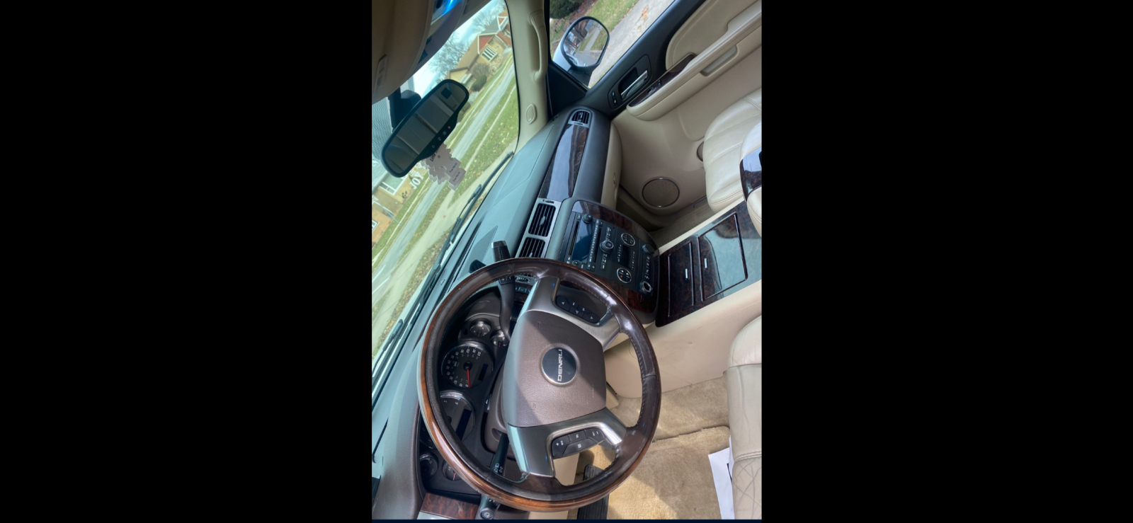

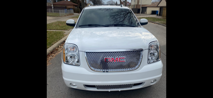

I will be sharing as much as I can. I love working on cars! Aside from the Denali, i have Two 2nd Gen Oldsmobile Auroras in my fleet lol. These are the only pics I have of the truck for the moment. I bought the Denali with 97K on the clock. it was an Alabama truck so the undercarriage is completely without rust!
As of now, i'm currently in the process of repairing a couple issues. I need to replace the water pump and i have a pesky misfire in cylinder 1 that i can't resolve. New plug, wire and coil. i'm guessing it may be a gasket leak on the intake but who knows. i only have misfires at idle. once i'm on the gas, they're gone. but i'll figure it out. next step is the injector.
Any ideas on the intake manifold? are there other intakes that are better designed or a nice upgrade from the stock bulky unit?
also, any suggestions on suspension? i kind of want something a little more sporty than stock, but don't want to eliminate the auto ride nor the auto level.
