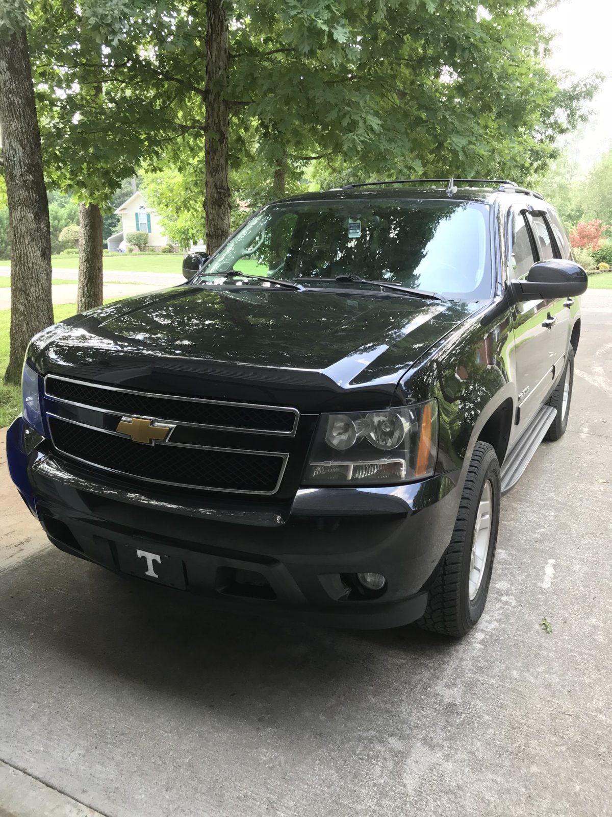

Good evening Tahoe family,
I have been doing some reading on here over the past hour. Read through the "sticky" and then a few odd and end posts here and there. I have a few things that I have noticed about my Tahoe and I have developed a curiosity over a few other things after reading. I have only had the Tahoe for about 3 days, so I myself have not really had the time to notice any true problems, but I thought I would get a post started to address what is, and what is to come:
Black 2013 Tahoe LT, 5.3, 4WD (single stage gearbox-AWD? no 4-Lo, only 2hi, auto, and 4hi)
85k miles. Price paid: $23,900.00 +$1900.00 for the 48 month "bumper to Bumper" warranty=
$25, 800.00 Total.
1. My rear windshield wiper/washer does not spray.
2. My driver's side door pull (the vinyl one, not the door opener handle) has broken inside and the vinyl feels squishy and needs to be replaced/repaired (it does not "look bad")
3. My rear backup sensors do not appear to work. They do not appear to be turned off, but I have never heard them beep.
4. How can I tell if the air-shocks are working, compressor is working, etc? I have not noticed any leveling, stiffening, or noise. Maybe they are broken?
5. I was descending a mountain over the weekend, braking often, and I heard a quick growl sound and noticed a message on the instrument cluster that read something like "grade assist activated". It lasted only a second or two and never occurred again.
6. I cannot seem to get the universal garage door buttons to sync with my old door opener (Craftsman 1/2HP -1995). I push the outside buttons for ~20 seconds to clear buttons, then the outside buttons for 2 seconds, then push the train button on opener, then back to the vehicle and press a single button and nothing...
7. When I push the button to "auto-fold" the mirrors, the driver's side motor sound as if it is straining (but it works)
8. The driver's side rear window seems to hit a "hard stop" with a slight "thud" at its lowermost position. The other window just stops at the lowest position quietly (like one would expect it to).
9. The plastic tread on the rear bumper (that you would stand on) slips around when you push on it. It doesn't seem to blow around, make noise, or fall off, but it doesn't seem "snapped in" or "adhered" to the bumper.
CARFAX showed no accidents. There had been (4) owners, however, which seemed excessive to me and caused a moment of pause, but 18 maintenance records. This brought me back home, as this would be roughly 3x/yr.
I did purchase a 48 month "bumper-to-bumper" warranty as I was leery of the 85k used vehicle with all of the bells and whistles this one has. It has a $100 deductible, but may cover some of these issues?
So far this vehicle is the most comfortable vehicle I have owned and it it an absolute pleasure to drive. The transmission seems smooth and, even with the 5.3V8, it is quiet, smooth, and just seems to "glide". I am hopeful that it performs this way for may years to come. I know nothing manmade is perfect, but I have heard good things about the Tahoe.
Cheers~
