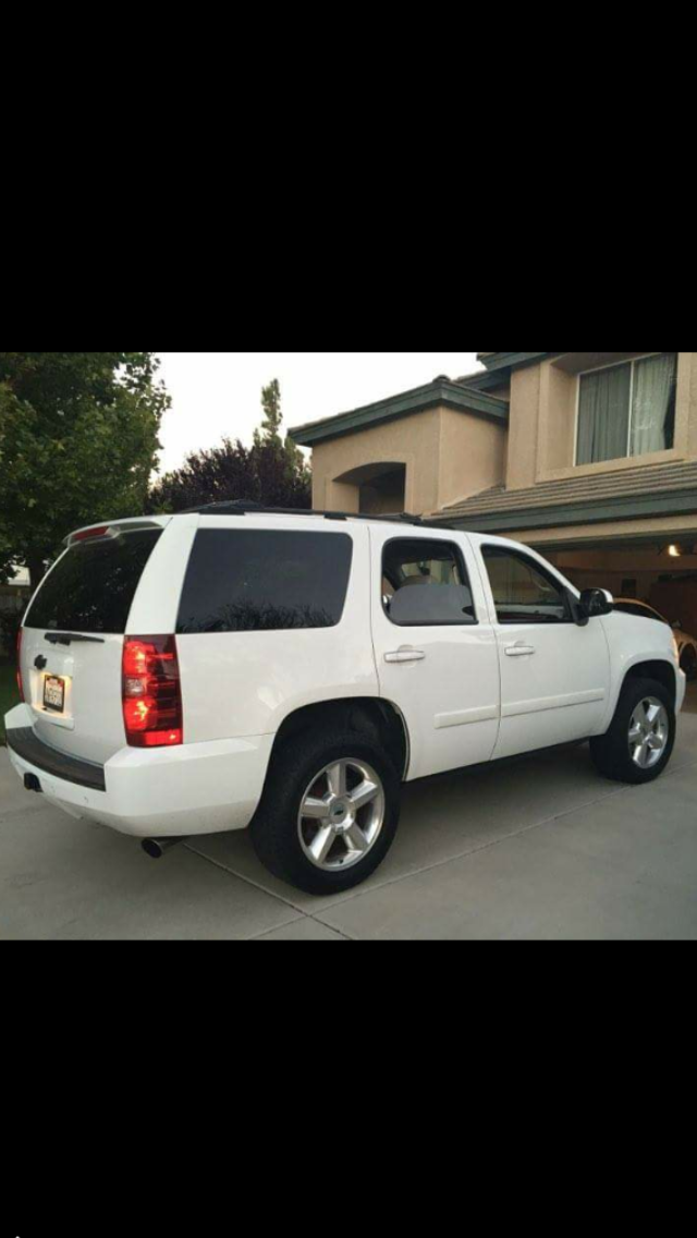

Here's a pic from when we first brought her home

Welcome! Looks clean. I bought mine a year ago, also with 128k miles, 2007 4x4, LT1.
