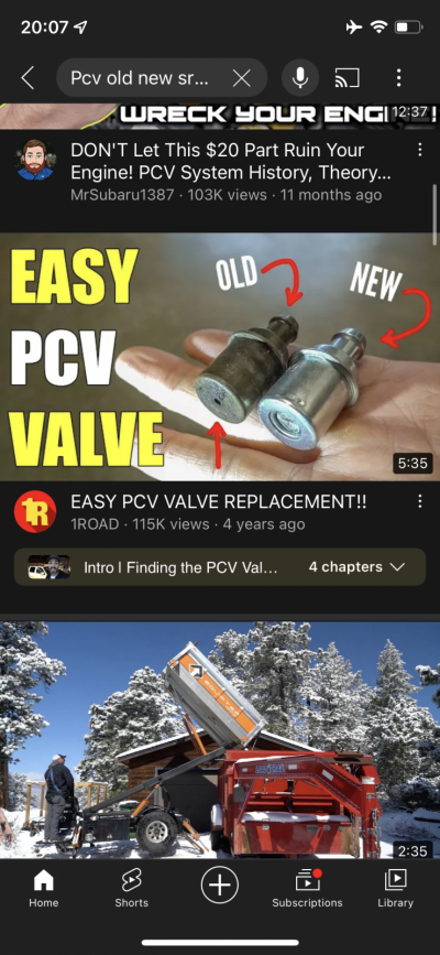

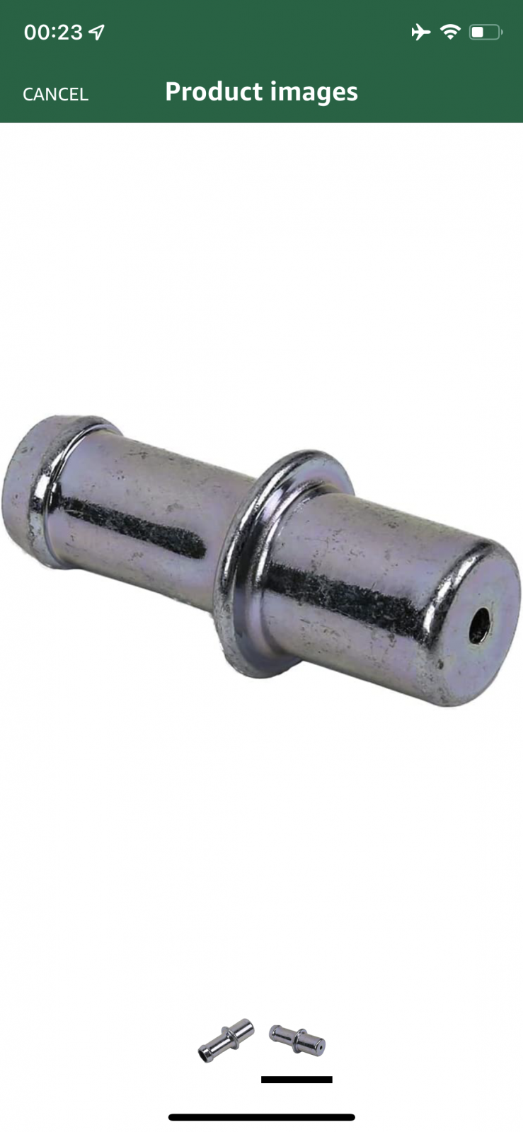

Apparently there is an old style PCV and a new style… Does anyone know which one is which?
I think the one with the small hole is the old style… but, can someone confirm?

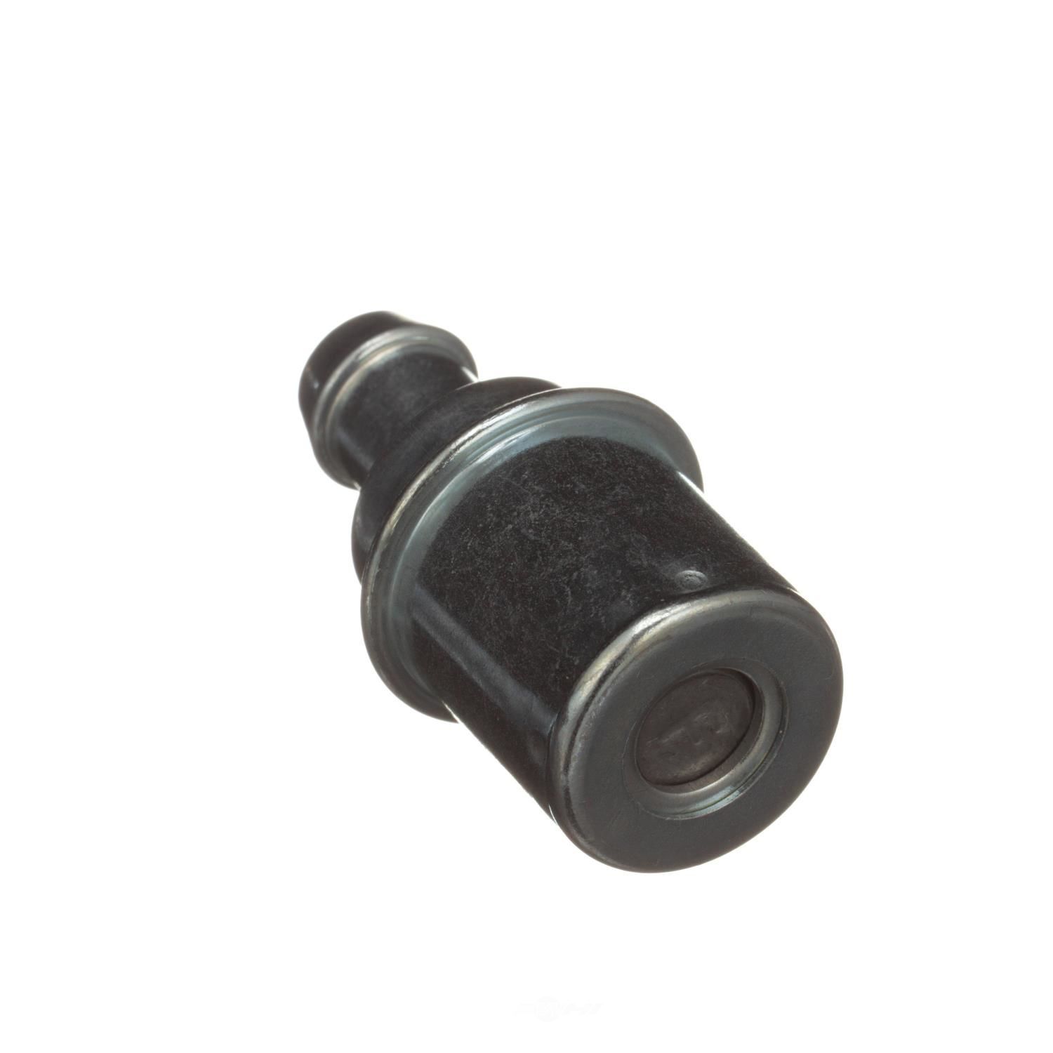

For MY 2002, it originally came with the larger hole one with spring loaded valve ( rattles when you shake it). The "new" style is the one with the smaller hole, and has no internal spring/valve (no rattle).
Wow I thought it was the opposite… Rattler is the new type, no?
My 01 came with a non-rattler pin hole PCV, and the one I ordered was the spring loaded rattler.
Also, some of the videos I’ve seen on YT confirm this

Yours must have been replaced at some point. Gm changed to the fixed orifice ( non rattle type) pcv after complaints about oil consumption using the old style “rattle” spring loaded pcv. I am original owner so I’m confident that the rattle type is the older style. There’s a tsb on the fixed non rattle pcv to replace the rattle type. even later, gm switched to a different valve cover without a replaceable pcv.
