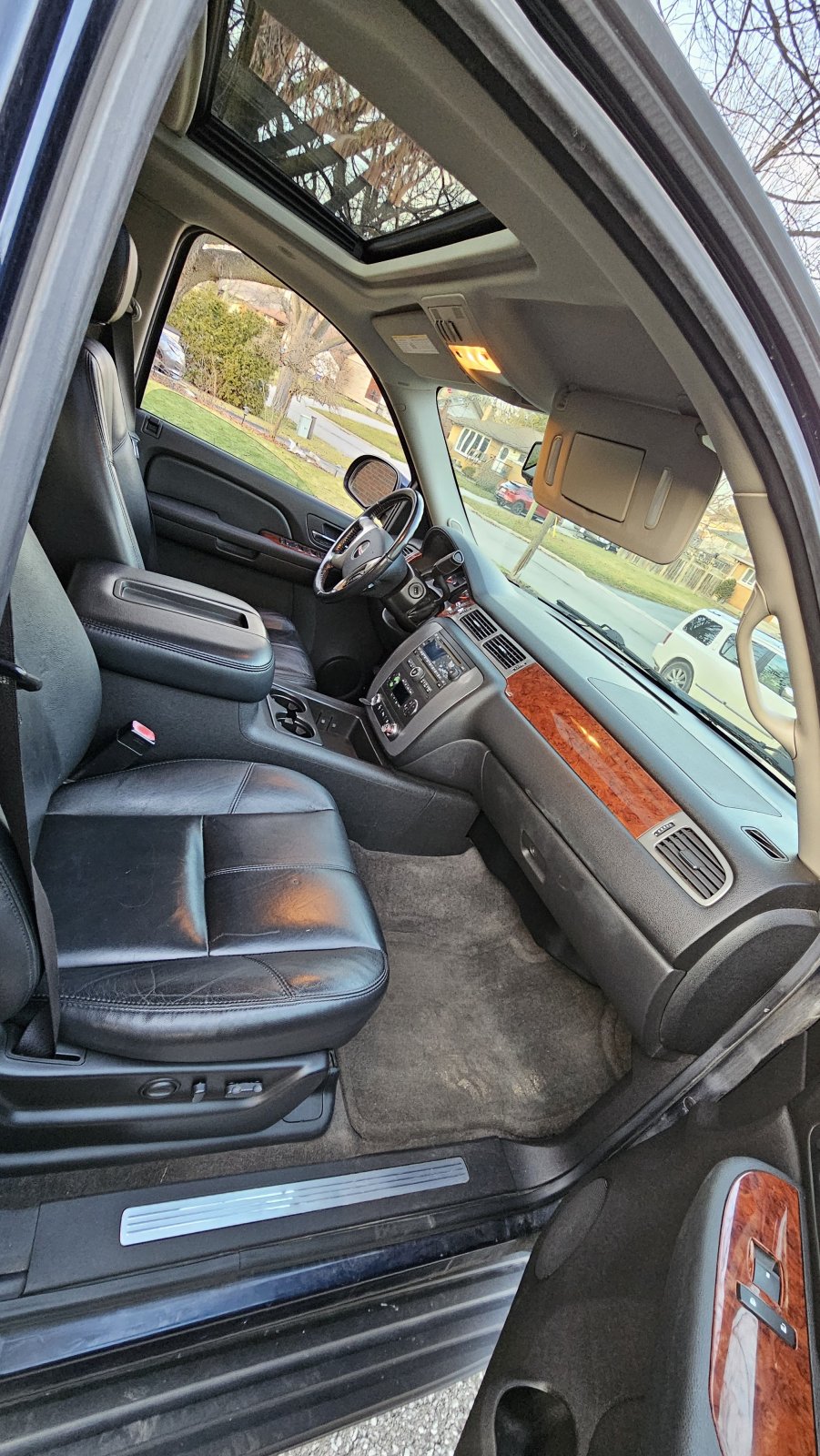

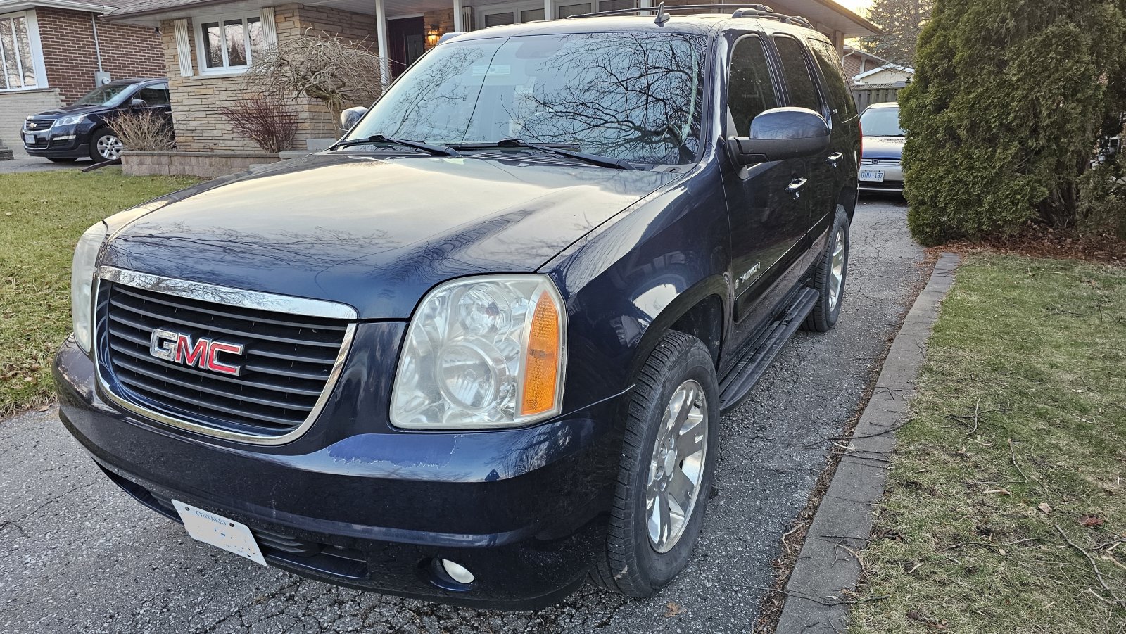

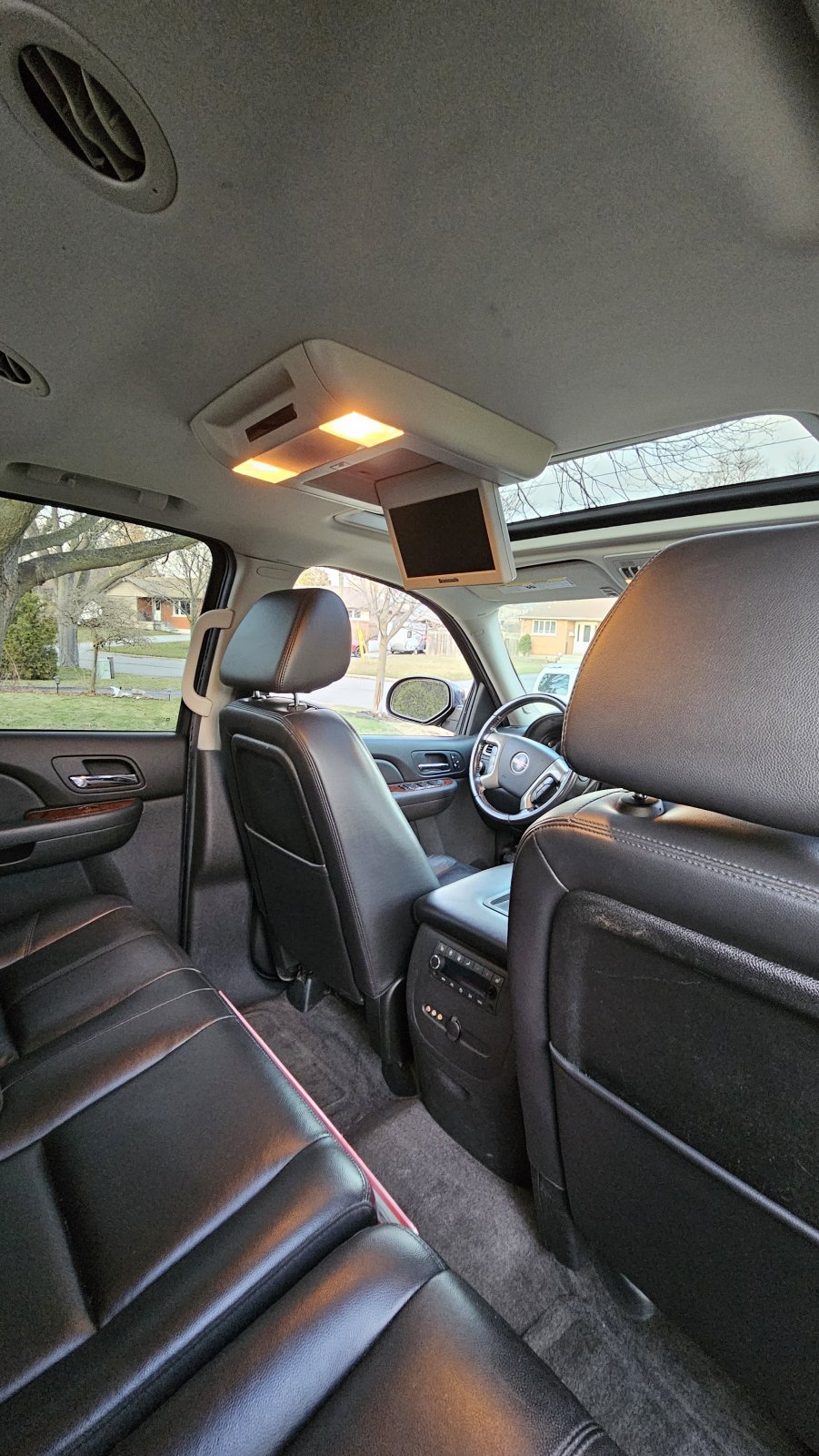

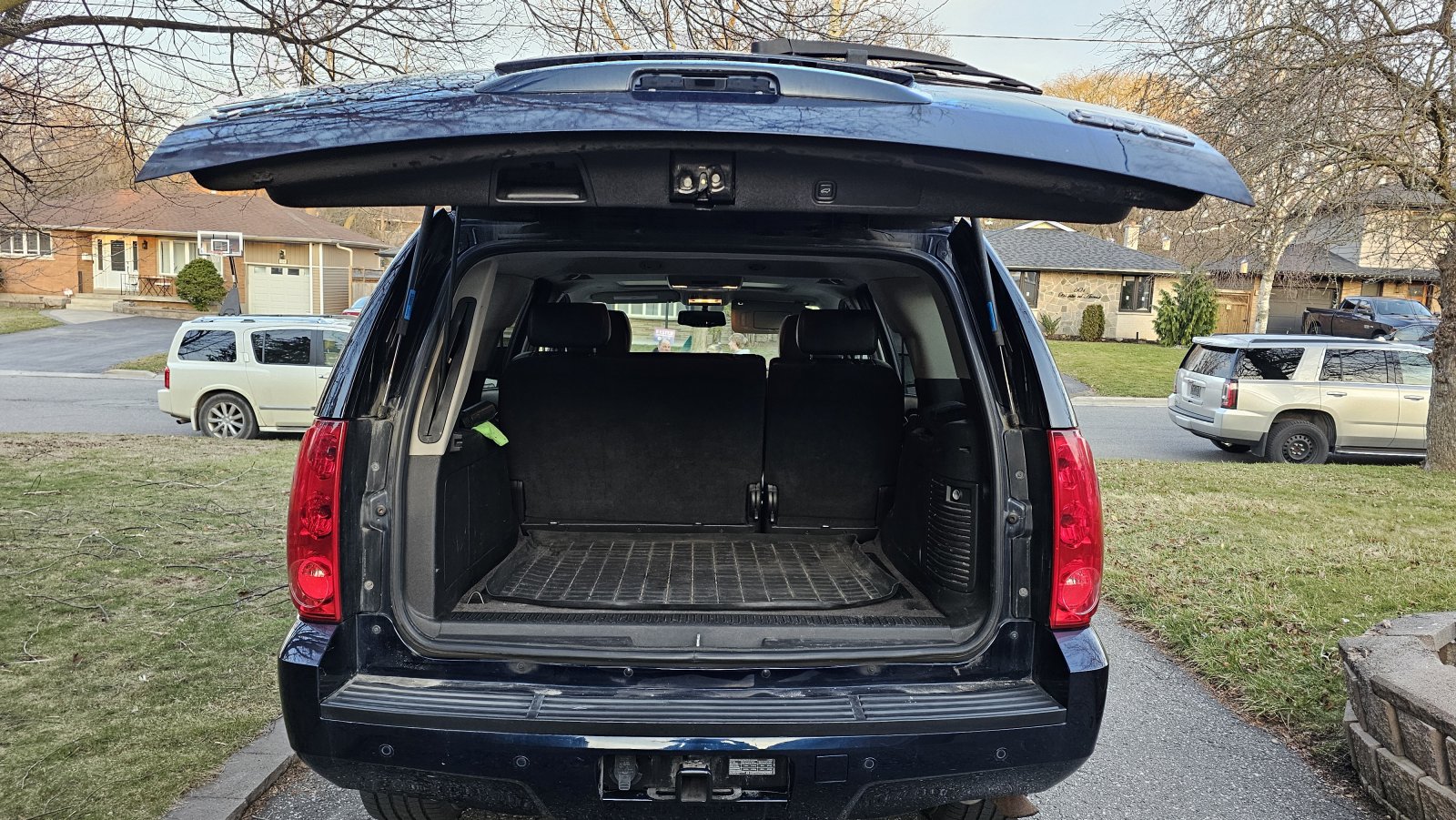

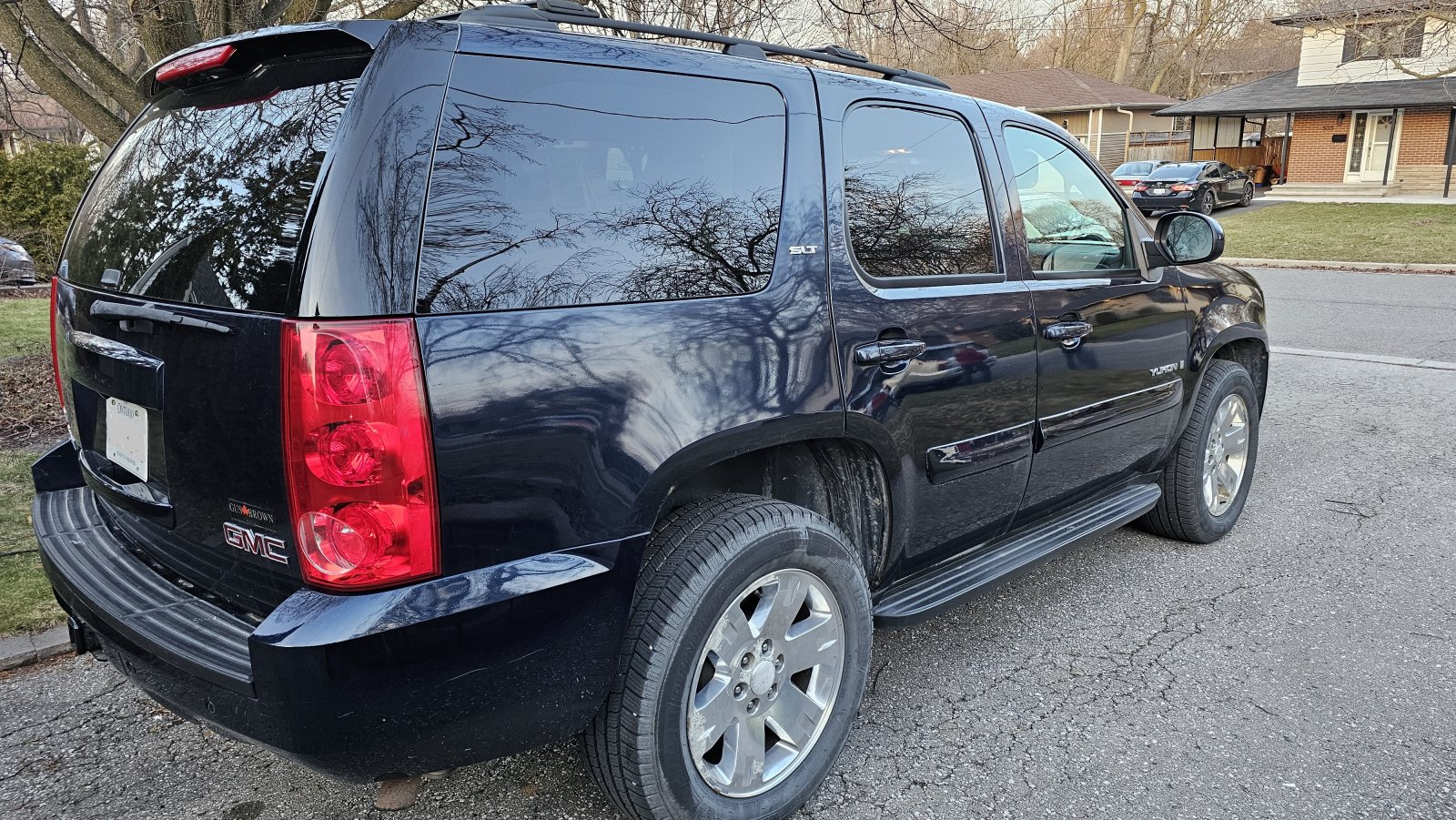

Hey new owner of a 2009 Yukon SLT here, got it last week.
We got it to replace my wife's 03 MDX and she always loves these vehicles.
It is in pretty good condition, 279000km, 1 owner only and regularly maintained by the same mechanic or dealership. She says she was changing the oil every 5000km as well.
Happy to read and learn what I can with this vehicle.

Welcome and Congrats on finding a rig with a 2nd row bench/couch. The BT is great and rear A/C makes having a huge black SUV completely and literally cool.

You’ve got the last year with the amber & red led next to back window for watching in the rear view for back up distancing, plus front door cards made to last vs 2011+ version.
