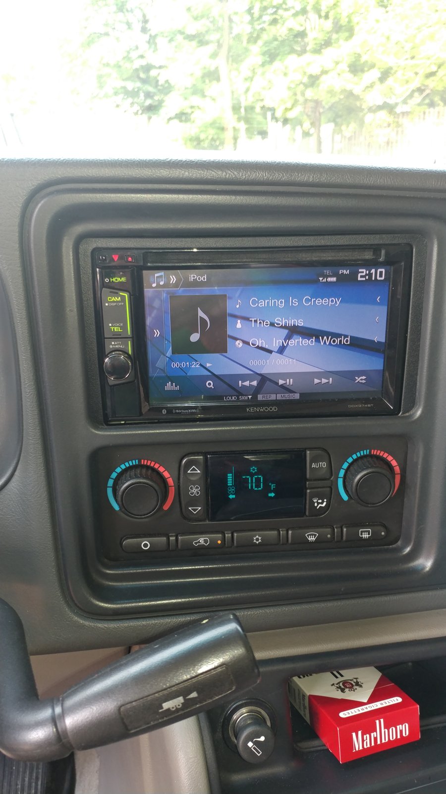

So I pulled it back out .I think I got the speaker crackle sorted out. Seemed like I didn't have one of the connectors all the way into the Pac 5 unit.
The whistle that follows rpm. Ill see later. I have to be driving. And I didnt have material to splice another ground.
This is it btw. Basic. But some nice features.
