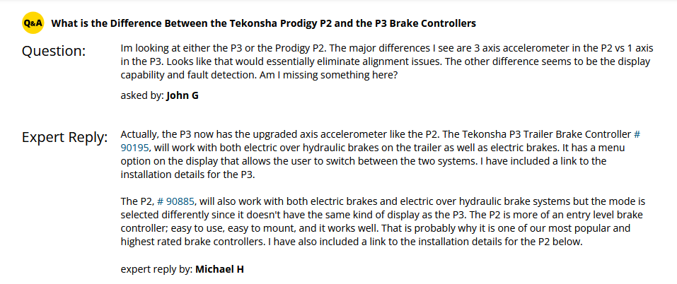

Even the takonsha website doesn’t list the p3 as compatible.. only the p2

I don't think you can go wrong with either, and either would work in your truck. As described on the eTrailer site, the P2 is more of an entry level controller. Nothing wrong with that; they connect and work similarly. I got the P3 because I liked the features and the menu/display.
It would be interesting to know why Tekonsha doesn't list the P3 as compatible; that might be worth a chat with them. But plenty of us out here run the P3 in these trucks with no issues and love it.
