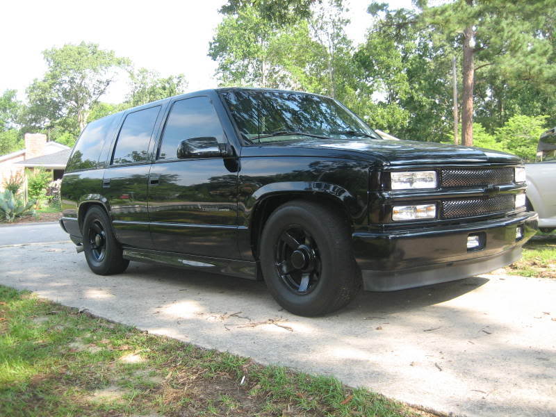

Well since you have the older body style truck I'd recommend you call your truck a 99 so you get the right parts. Does your truck look like this?

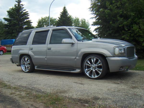

i put a bell tech 4/4 on mine a few months ago..with smaller rubber also.it does ride rougher but the look is worth it to me! mine is a 4x4. got used to it after a few weeks.

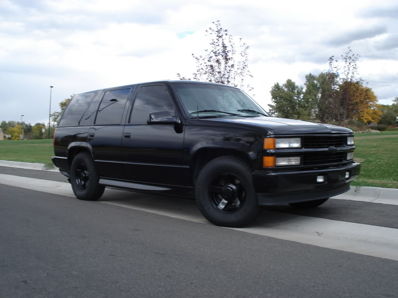

I think you can go 5 or 6", I'd start with some 2" spindles and the 4" rear spring hanger/shackle kit. You can always hook some 1" or 2" front springs later but I think you'll be chill with just a 2/4 on that truck...body kit makes em look low as hell.
