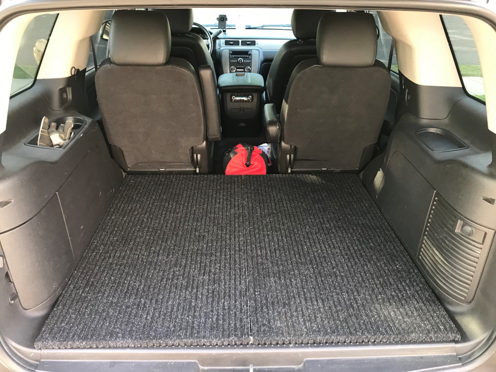

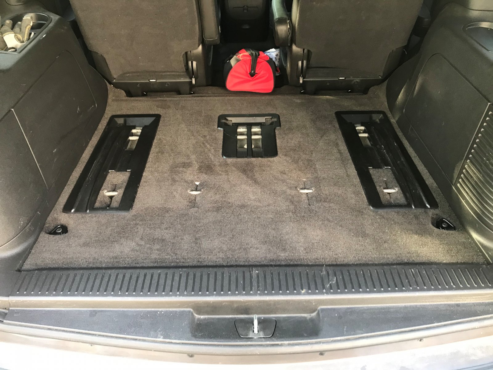

I've been searching for a way no make my cargo area more flat when the third row seats are removed. When the seats are removed the tracks in the floor stick up and make it uneven. So I decided to make one myself after not finding anything on the Web . Basically took 2 48"x 44 with a hinge in the middle for when I take it out and store it away and glued outdoor carpet to it. I made some supports on the bottom so it sits even all around. Now when I put a cooler in it it will sit evenly on the floor.

I've been searching for a way no make my cargo area more flat when the third row seats are removed. When the seats are removed the tracks in the floor stick up and make it uneven. So I decided to make one myself after not finding anything on the Web . Basically took 2 48"x 42 roughly with a hinge in the middle for when I take it out and store it away and glued outdoor carpet to it. I made some supports on the bottom so it sits even all around. Now when I put a cooler in it it will sit evenly on the floor.

This is great! Care to share a pic of the levelling supports? Or is it just wood pieces at the right height in the right places?

It's just little blocks at the right places, 4 across the front and 2 in the middle . The sides are supported by the seat tracks and rear is supported by the rear body trim step.
