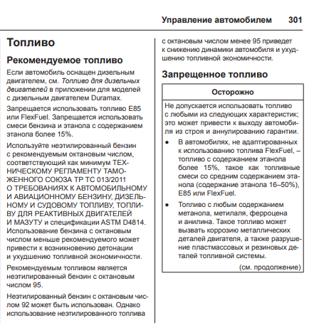

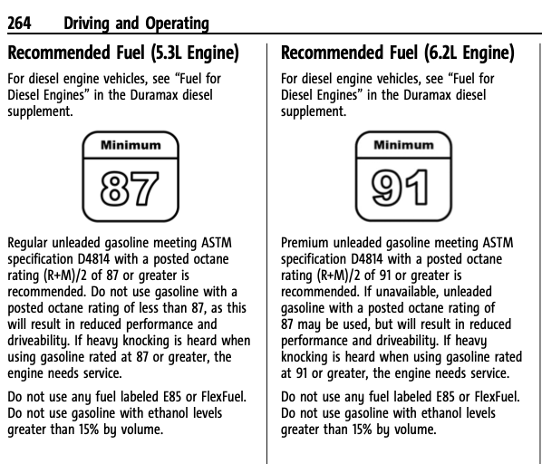

Interesting that on the 5.3L V8, GM recommends 87 Octane in US, even w/ the 11.0:1 Compression ratio..owners manual excerpt..
What does your owner's manual say?
Regardless, running your 95, you certainly won't hurt anything in your 5.3, there is only positive to be had running the higher octane...but it may not be required and you may not see any benefit.
Unfortunately, I can’t find the instructions online with us, because Chevrolet has officially left Russia. But on automotive sites, the technical specifications for Tahoe 5.3 really indicate 95 brand gasoline. But it's funny, it turns out that our 5.3 owners can fill in our 92nd gasoline without any problems)))
This seems to match with what the Owners Manual says and what I would expect.
This is very funny, my friend, the owner of Tahoe 5.3, which he bought officially in Russia, sent his manual. Here is the screenshot. The translation is as follows.

It seems word for word as in the American manual, but 87 gasoline replaced 95. Despite the fact that the American 87 is the same as the Russian 92nd. It turns out that when Tahoe adapted to Russian conditions, we removed the ability to refuel 92 with gasoline))))))
Or there was doubt by the engineers that 92 was always >= 92, so they margined it to 95?
Well, then we could generally supply the minimum gasoline with an octane rating of 100))) In fact, we have good quality gasoline at gas stations of large brands. Although the 900th Tahoe was funny. 10 years ago. When using gasoline from one of the filling stations, the engine oil froze completely at a temperature of -5)))) People began to come to the official dealer en masse, because the oil sump is not liquid oil, but like tar. It turned out that this network of gas stations has some kind of additive in gasoline, which, when mixed with GM 5w30 oil, makes the oil lose its properties even in a slight cold. But a recommendation quickly came out not to use this particular network of gas stations.
