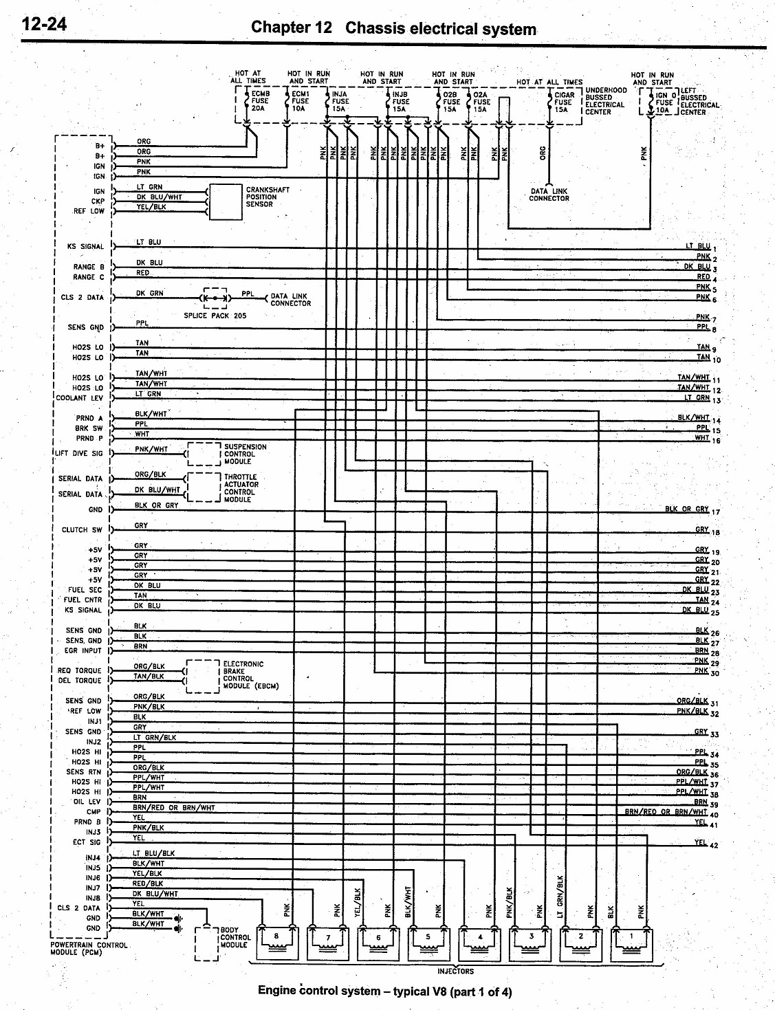

Hi everyone, I am in dire need of a wiring schematic for the 2005 tahoe on the injector system. Basically, I need to know what wire color goes to the injectors for each cylnder. 1 2 3 4 5 6 7 8 . I made a mistake or a few when I installed the new pigtails for all eight injectors. I feel ignorant. Very low on funds these days, so any help would be very appreciated.

From Haynes (injectors at the bottom of the diagram):
