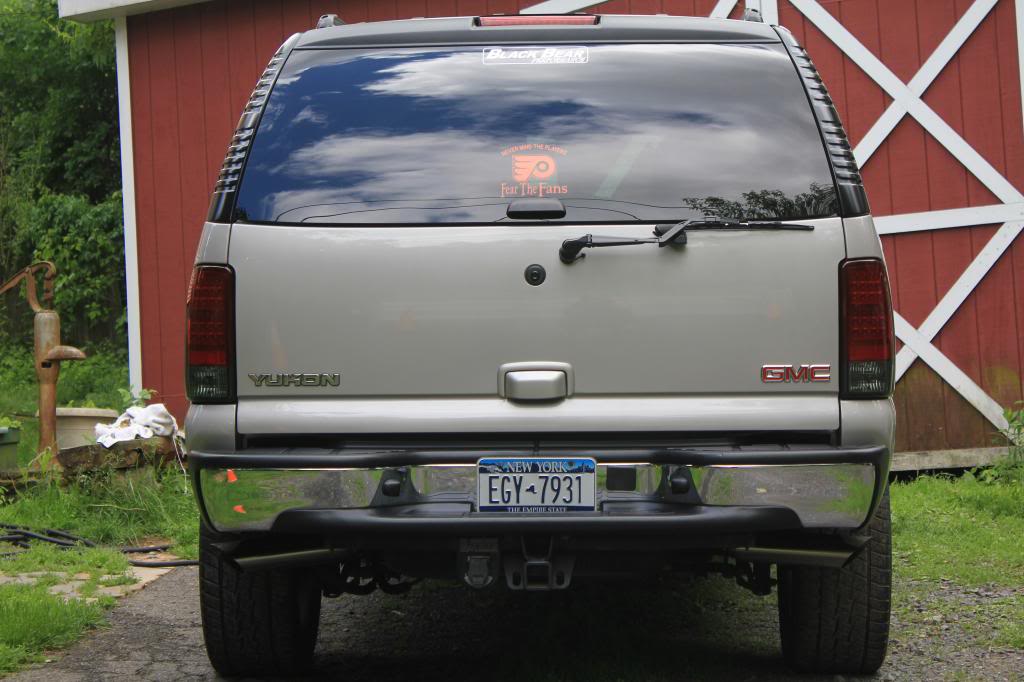

I can`t speak about corsa or magnaflow catbacks but i had a flowmaster catback in regular steel and it rusted away in about 2-2-1/2 years and the fit wasn`t great. No matter what i did i could never get the tailpipes to line up evenly and the hangers and clamps in the kit were junk.
I decided to go to a custom exhaust shop in north jersey and had one made up for $800 in stainless. Now the tails are perfectly even, The whole system is welded so no worries about the clamps rusting out. I just wish i would have gone the custom route in the first place and saved $450 i wasted on the DIY kit.

I went with a dual side outlet setup. I have a 3 inch pipe from the cat to the muffler and 2-1/2 inch tails into 3-1/2 x 18 tips. I was looking for a flowmaster 50 series suv muffler like what came in their catback but couldn`t find one in stainless so i got one that was the same dimensions except it was a little thinner top to bottom. It`s also a 50. I have no drone at all unless i`m towing a heavy load up a hill and the engine is working hard and even then it`s not very annoying. Friends tell me that it`s loud, They can hear me coming down the road so that muffler may not be the one for you. Maybe a larger magnaflow would be good.
And some people say that adding a catback won`t really increase power at all but there is no doubt in my mind a picked up something in the mid to high rpm`s. Not a huge difference but noticeable.
