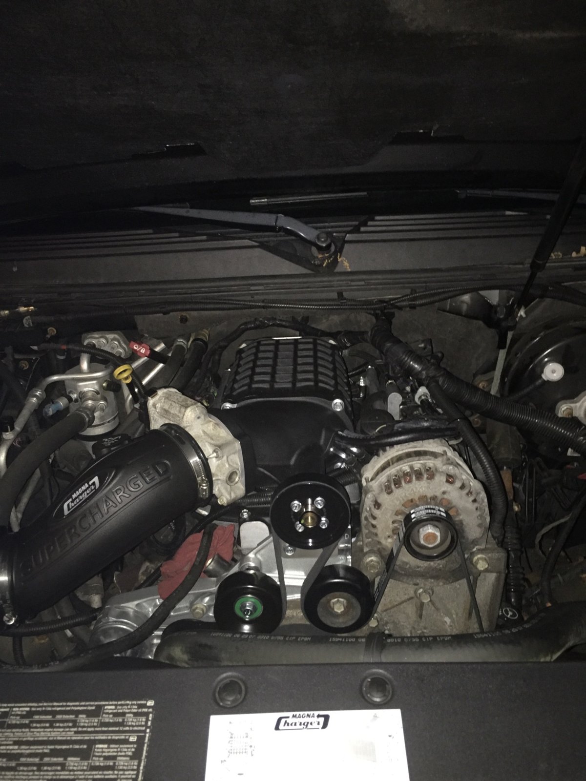

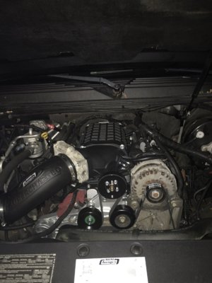

SUPERCHARGED!!!
Yup hands down. When people ask what the hell under my hood, it’s fun to reply oh not much, whining alternator, exhaust leak.
Here’s mine
What it sounds like behind me.
